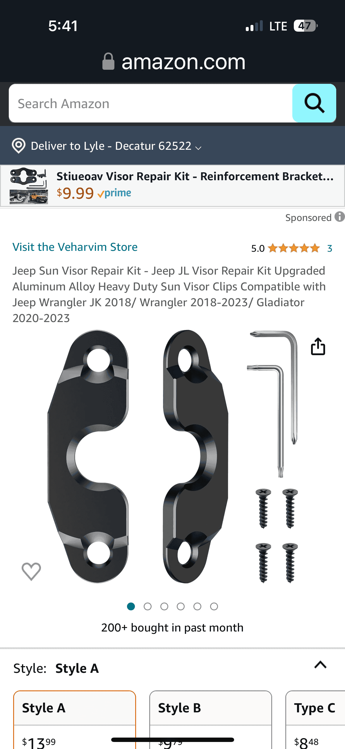

My drivers side broke dealer had one on the shelve and put it in, he did say the MSRP was about $450. I bought the visor repair / brace kits for both our Jeeps. Was told be sure to get a metal one with two holes, there are a lot of options out there….Jack

Add me to the broken visor club.. came home last night, after having the sunrider open on the way home from the office.. flipped the visor down to close and latch the rider. When I flipped it back up.. crash.. that crappy little thin plastic sleeve inside the visor gave up the ghost.
Already ordered something like the above posted brackets.
Now, I'll admit I've seen these visor posts for a couple of years, and have immediately found myself thinking: 'Man, what are these jokers doing to cause this thing to break?!?'.
I believe the proper answer is... nothing.. literally nothing. It's just a craptastic design, that could easily be fixed by making that post a little longer, and putting a metal clip on the back side.. OR, even just incorporating these reinforcement brackets.
For the record, I'm usually driving by myself, about 90% of the 40k miles I have on the JT.... the ONLY time those visors are even raised or lowered, is when we open the Sunrider, which I didn't HAVE until last year... prior to owning it, they were never used. My wife, in fact, just NOW realized they're illuminated mirrored visors, last night...
How the hell something like this can just 'break', without any use, is damn near criminal. I probably raised and lowered them... maybe 200 times max.

Thx, I did order the reinforcement brackets. Called the dealer and they are offering to pay for the broken passenger side visor, since I have already paid/replaced the driver's side. I appreciate the help/suggestions! Thx Rich

Got the above added to my Amazon Cart. Thanks!
