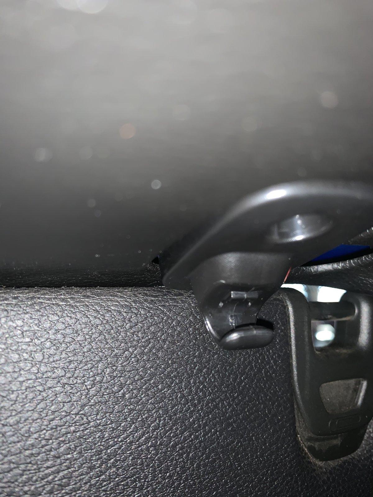

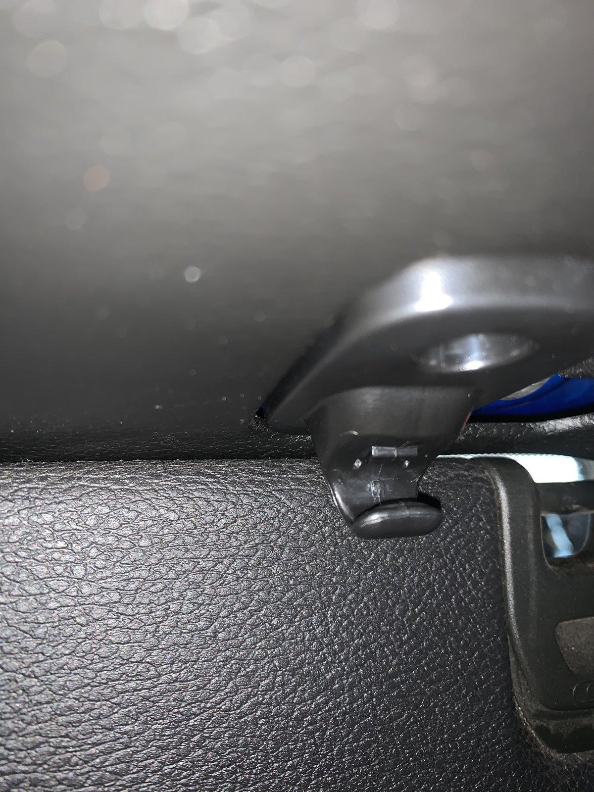

Thank you for the replies, b-roc and ndn384! It's a possible culprit. My current fix is to unclip the visor from the hook while on wash boards and it silences it. With the visor unclipped, I can grab the hook and easily recreate the noise by jiggling it. With the new dealer installed part I can almost remove the hook from the windshield by pulling it if it weren't for the torx bolt. Trying the same thing to the passenger side doesn't create the same noises/issues as the driver side. I'll post a photo of what I'm talking about.

In the photos below you can see how far forward and back the hook can rock. It does take some force to make it do this but trying it on the passenger side doesn’t do the same thing.
