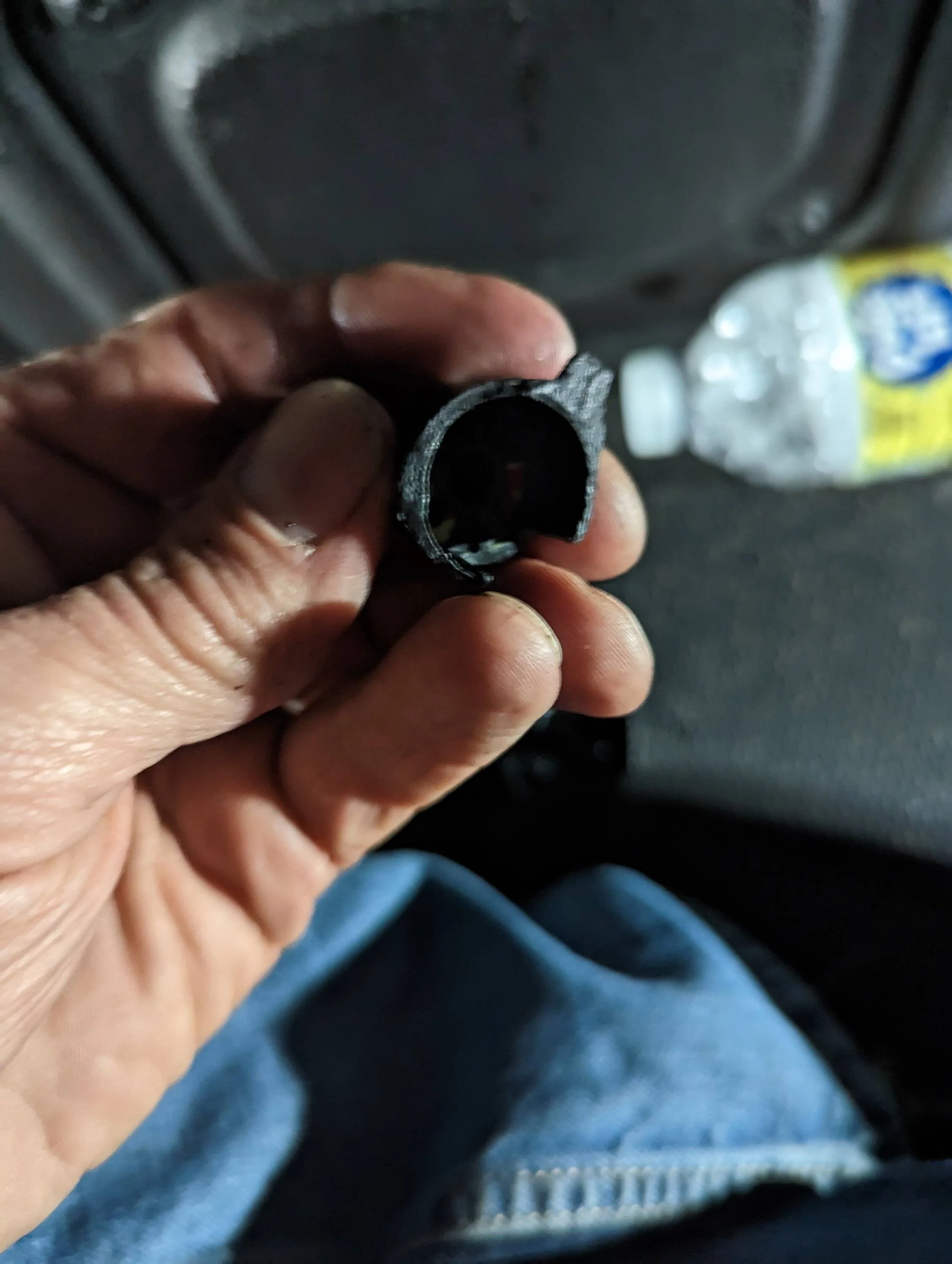

Here's my issue, the plastic piece in the middle broke off that holds the latch mechanism together. Looks like I'll need to order that part. Now I got to figure out the part number I need. Always something. Looks like a easy fix if I can find that part
Looks like a job for jb weld
I'm just gonna replace it. It's a moving part with a spring inside. If it snaps again and I got another cover on I'll be in the same boat. I'm gonna hit up the dealership for the part I need tomorrow.
Good news is I recall that part comes off very easily... i think. Hahah.
Good luck.

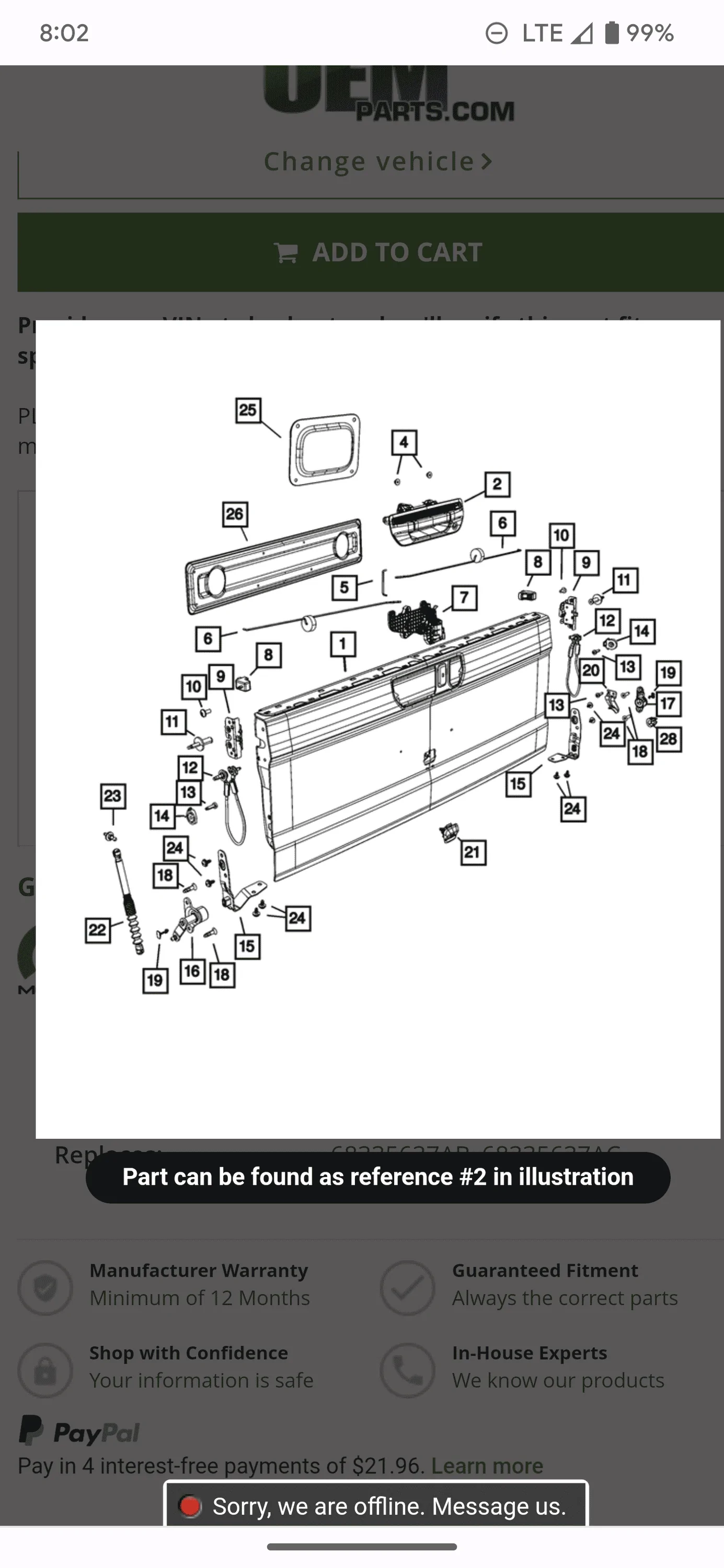

Anyone know off hand how to look up the
part by this diagram. Looks like the part I need is part #7. It's early and I'm drawing a blank on how to find that part using this

I think I found it. Looks like this appears to be the part I need. That's a lot cheaper than I thought it would be. I found the part on Quadratecs website and used their part number to for reference online.
https://store.mopar.com/oem-parts/mopar-door-control-unit-right-68335647ad
https://www.quadratec.com/p/mopar/tailgate-control-unit-gladiator-jt
If I'm wrong please someone let me know but this appears to me to be what I need. If I can get a second or third opinion then I'll go ahead and order it. Hopefully it's a easy fix as well.

That looks like the right part.
Gonna check with the dealership and see if they have one in stock before ordering it. I'll pay a little extra to go ahead and have it but if they got to order it I'll just order one online I guess. I would think a metal part would of been better but I guess it is what it is. Still pretty cheap for the part.

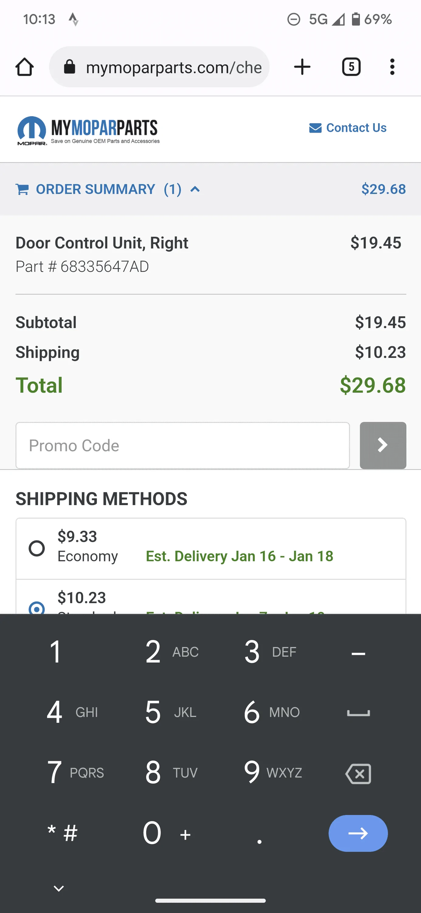

Order place with my Mopar parts.com. $29 counting shipping, expected January 7th-10th. Dealership wanted $52 for it and a days wait. I should have the part by Monday.

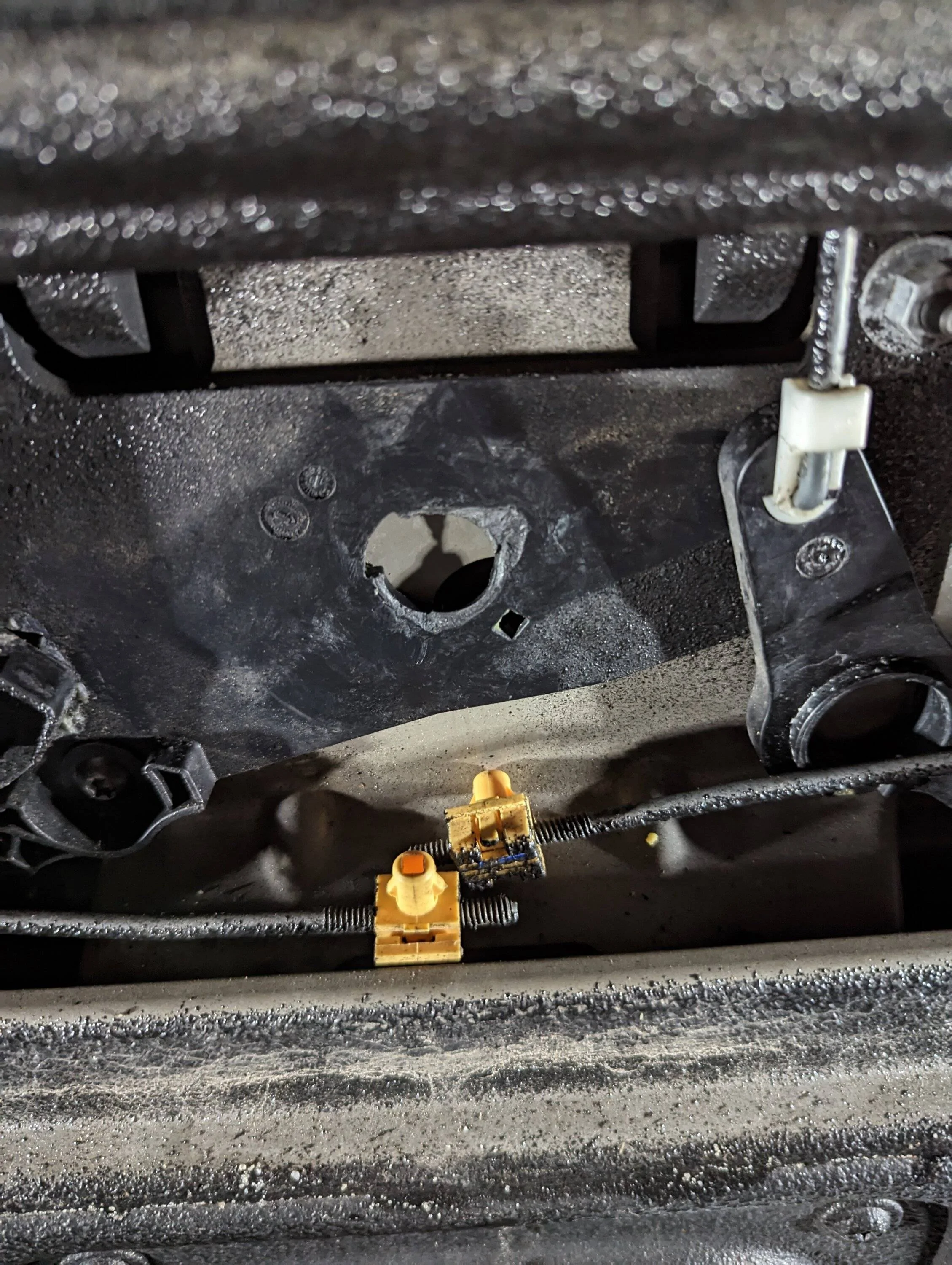

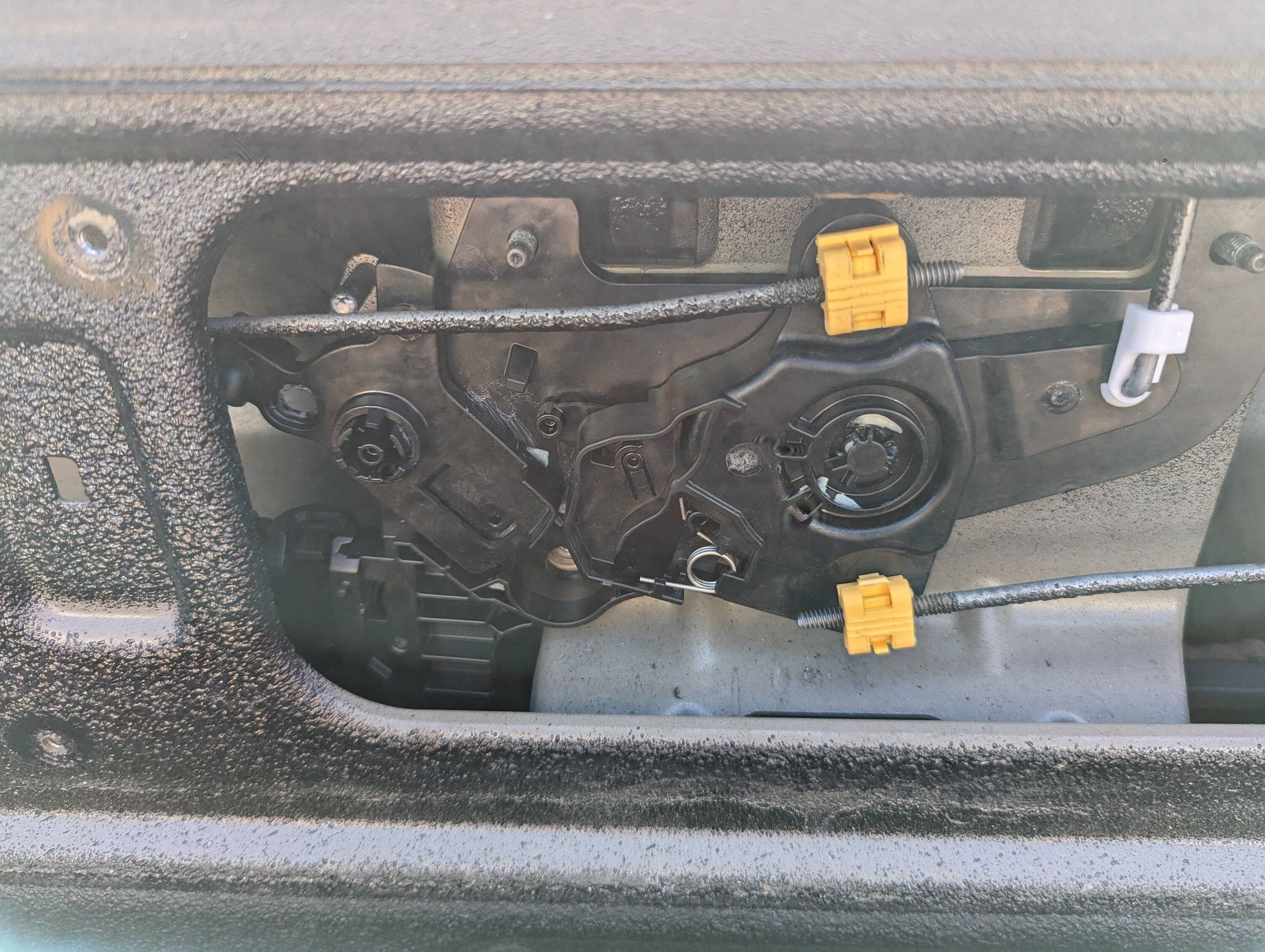

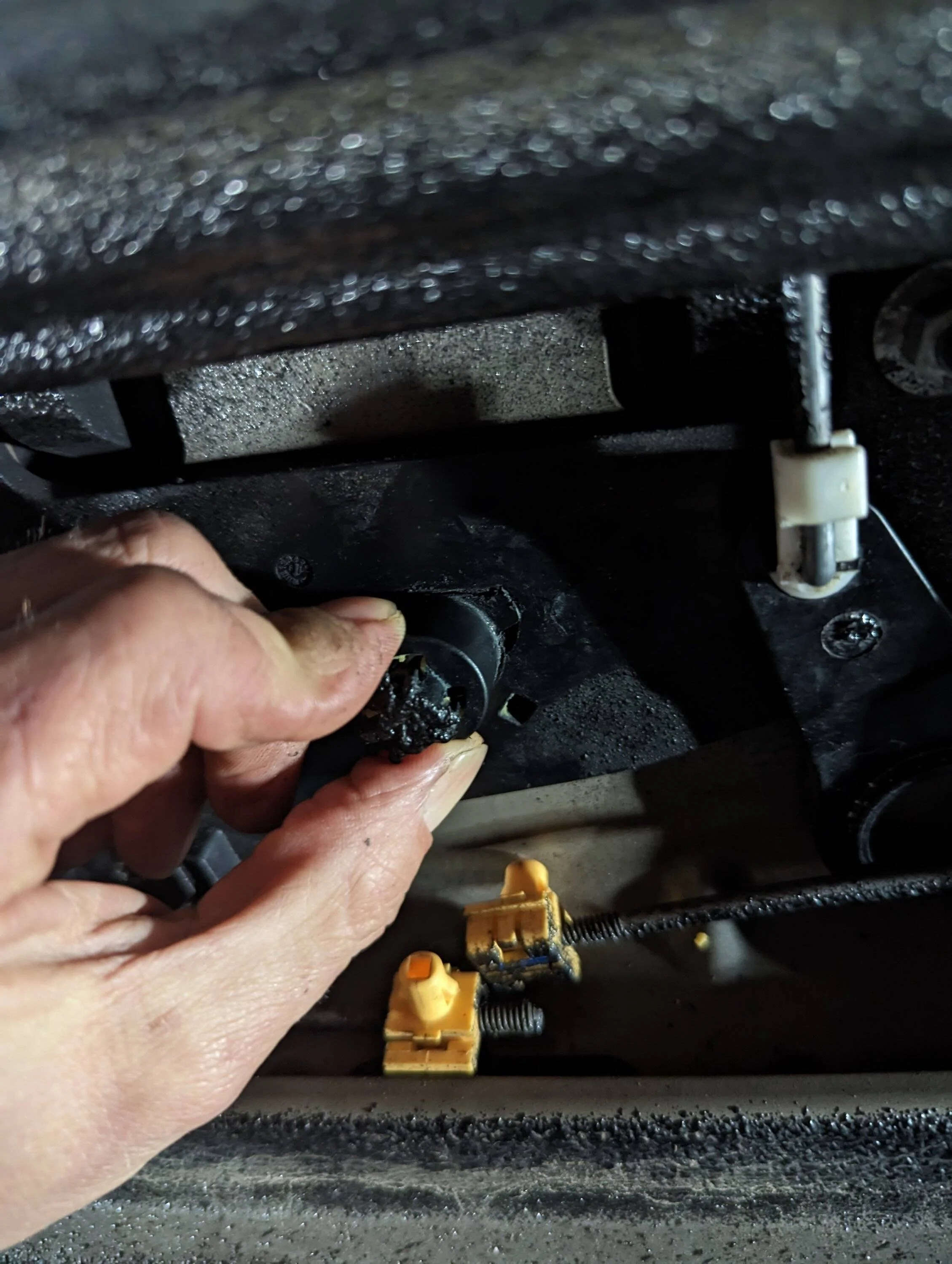

Update, got the part yesterday, got it put on today. Pretty easy to fix I was surprised honestly. About 30 minutes or less and right at $30 to fix it. I'll throw the Oedro Tonneau Cover on in a little bit and update how I feel about it. $125 for a brand new tri-fold tonneau cover seems like a steal, I hope it's not to good to be true though.
