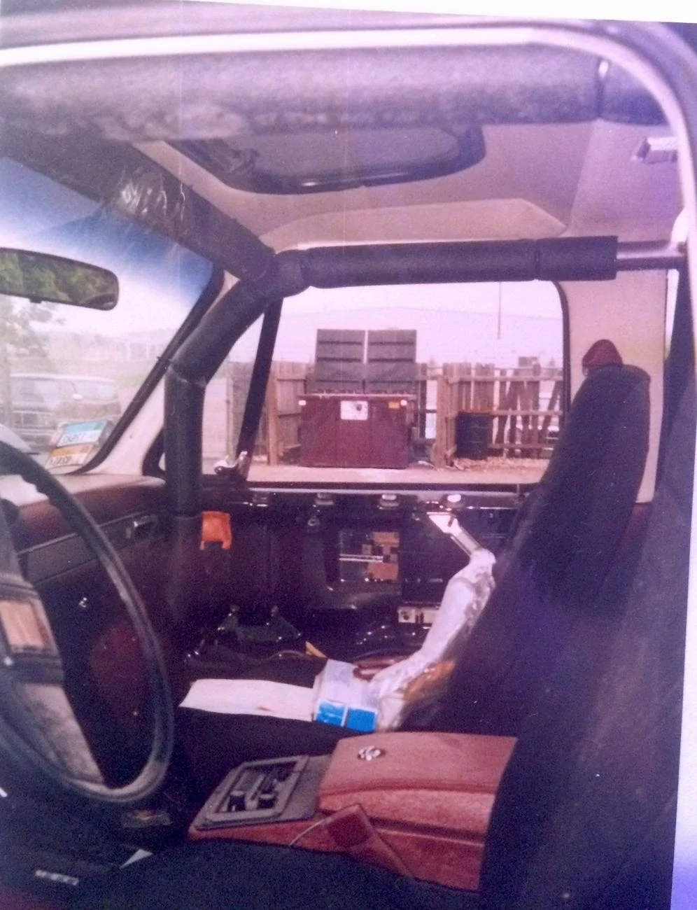

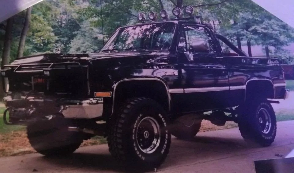

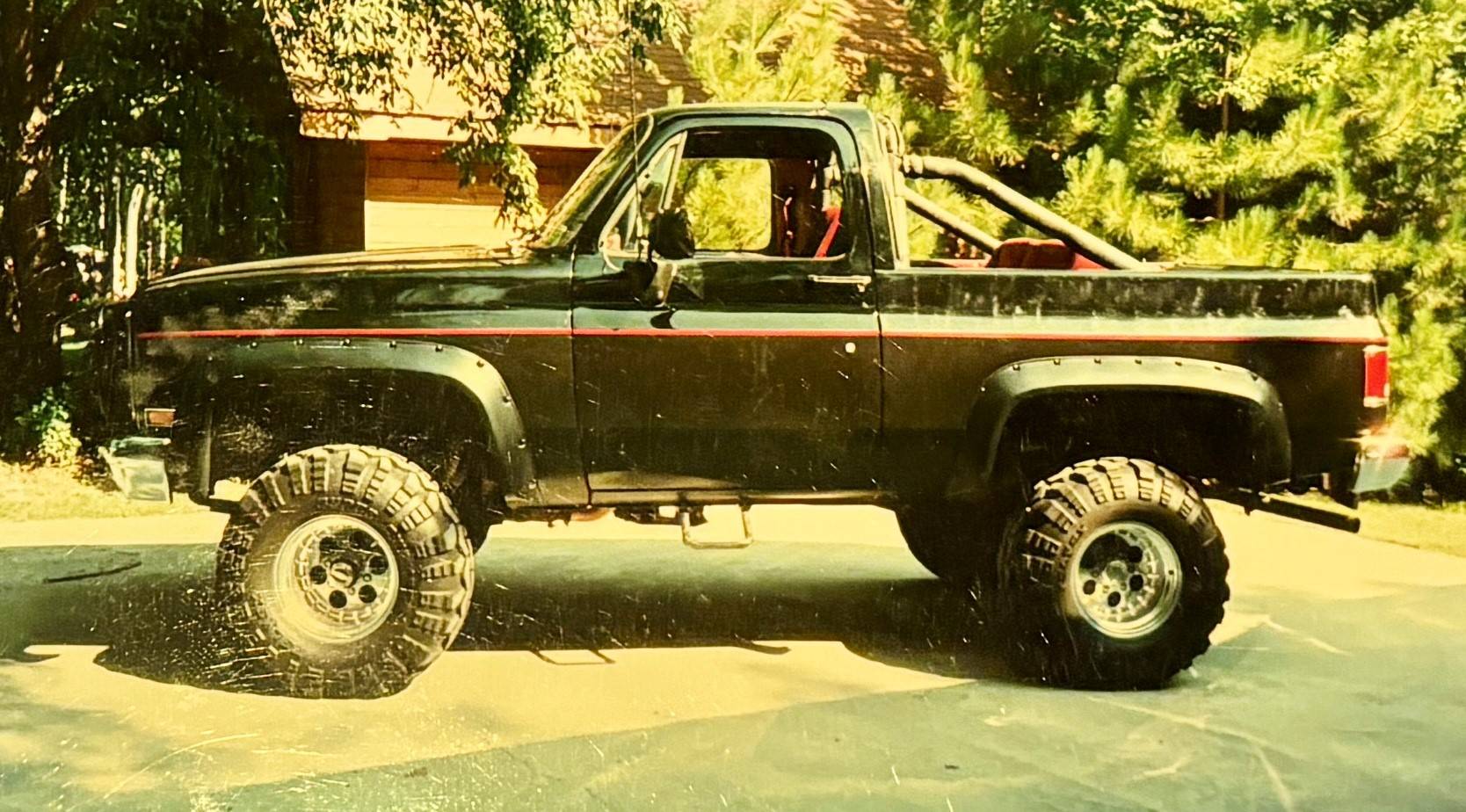

The 6pt rollcage that i had for my K5 Blazer did not pass through the floorboards to the frame but was directly bolted over 6 of the 8 body mounts. 1 on each side at the A pillar, 1 on each side just forward of the rear wheel well (where the removable top came off) and 1 on each side at the end of the frame by the tailgate. 2" .120 wall tubing with gussets at the joints and coped / notched tubing.
I really wanted to run 2 more legs down from the rear horizonal bar at the back on a angle to the body mounts just behind the rear wheel well, but was a poor college kid and really didn't see the cost per safety factor necessary..
Thankfully I never had to test its strength and since I was in Michigan, it wasn't a rock crawler and more of a extra safety measure for the sand dunes in case things went south cresting the peaks. :)

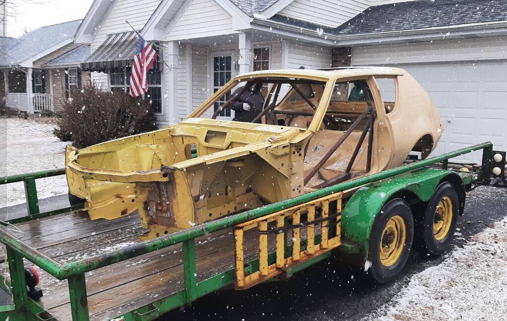

Hemi Gremi in the works?
A member of our AMC Races group is forced to sell his project......... that's one of the pics. Likely was going to be a 401 - it's what most AMC racers use.
"frame connectors" connect the front of the rear frame rails to the rear of the front frame rails to prevent body twist under the extreme torque but I've never paid attention to how the cages are anchored. Likely home-brew frame members or steel plates.
As long as a cage is mounted to the body where the body-to-frame mounts are, all should be good on a full-frame vehicle. There's a lot of flex between body and frame and to anchor directly to the frame would negate any frame/body isolation rendering it subject to a lot of body stresses, harmonics and so on that the frame usually takes care of.
I'd agree with your body mounting plates if you were simply caging the passenger compartment as the body is mounted on rubber isolators. As soon as you are turning the bed into a passenger compartment that goes out the window as the bed is hard mounted to the frame. In that instance the only right way to do it is to tie in to the frame in my opinion.. Of course I'm no engineer so my opinion doesn't matter... but if I'd designed that cage the frame wouldn't have bent where it did period.
