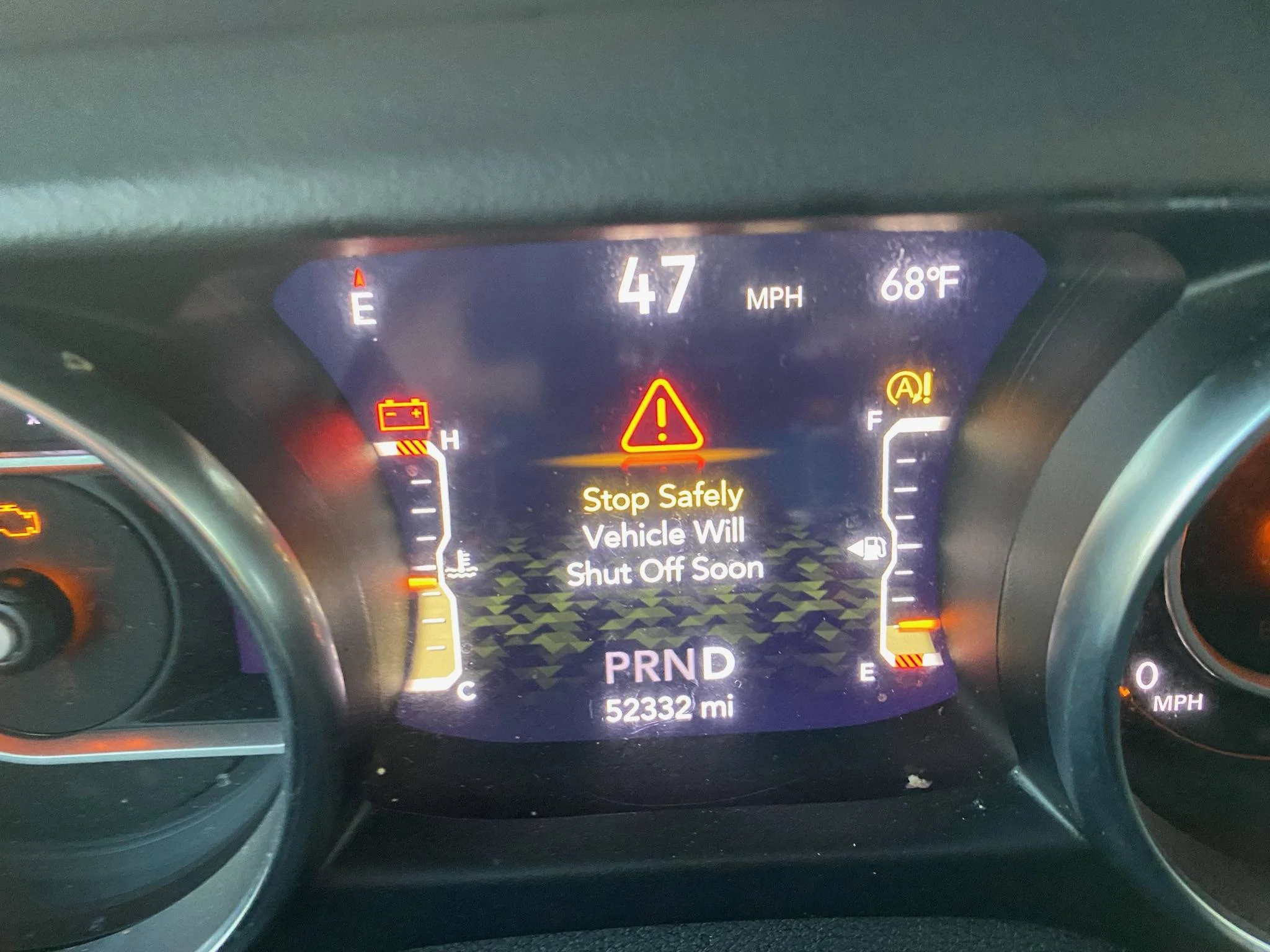

Check for a blown N3 fuse. If it's blown, the aux battery isn't getting charged.
Winner! It was the N3 plus 2 others in that fuse bank. Replaced and back on the road. Failed auxillary battery was the culprit.
Advice to everyone....Replace batteries every 3 years whether you think it is needed or not. These factory batteries were at 4+ years old .
I have an Odyssey pure lead high performance AGM main battery in my JL that I will use beyond 3 years, but the aux battery, which is an AGM, but not pure lead HP, will still get replaced at 3 years.
My JT had its factory batteries replaced in November of 2023 under warranty due to an aux battery failure. So in November 2026, out they go. I've already got it marked on my calendar.
Anyway, thanks everyone for the help and @jebiruph for zeroing in on the specific culprit! You guys are the BEST!
