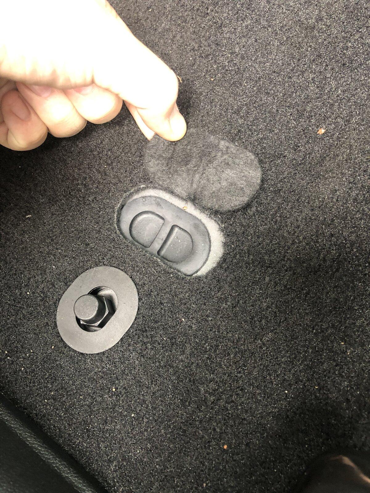

I purchased a new 2021 Gladiator about a week ago. It was a demo unit with about 2k miles. Willys edition with Jeep/Mopar slush mats. Yesterday I noticed the slush mats have a drain hole in them but no plug. I contacted salesperson and they called me back and indicated that I needed to pull up the carpet, remove the drain plug from the floor pan and use that for the slush mats. He said that not everyone purchased the floor mats. The implication is that the floor mats don't come with a plug. That does not seem right to me. If I remove the plug from the floor pan - I now have an opening that water, etc. can come into the cabin and get under the carpet. If I don't have a plug in the slush mat - it's not really an effective slush mat. Can you guys with the slush mats tell me how yours was from the dealer??? TIA

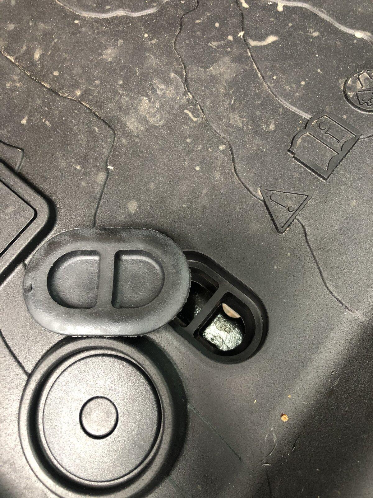

I have the Mopar floor mats in both my Jeeps. They do not come with the plug. You take out the little carpet tab and pull the plug and then the floor mat goes down and press into the floor pan. Then you put the plug into the floor mat. It all seals up and you won't get water in your floor boards. A simple install. You can find videos on You Tube on how to do it.

I was thinking the same thing. When I picked my truck up, I looked down and saw the ground, didn't seem right. Found the pugs and covered the holes, but thought- what keeps the water from splashing up through the hole and getting trapped between the mat and the floorboard?
If you look closely at the mat/hole you'll see the mat has a "funnel" that extends down through the carpet and floorboard. It's supposed to seal the hole in the floorboard and keep the crud from getting to the carpet

The dealer is correct: you do not get a grommet with the mats; you are supposed to re-use the grommet plugging the drain hole on the floor pan.
The mat install calls for the following steps:
  1. Lift the carpeting
  2. Remove the grommet from the drain hole on the floor pan
  3. Cut out a hole in the carpeting
  4. Install the mat making sure the cutout seals the drain hole ā€”this is a key step to prevent unwanted dirt, grime and water to get into the cabin through the open drain hole and to collect under the carpeting
  5. Place the grommet on the mat to cover the drain hole
Having said that all that, I left the grommet plugging the drain hole on the floor.

I put the plugs from the floor on the slush mats. Without the plugs, the slush mats just let the water run right into the carpet as the relief pattern channel liquids into the drain hole.

Neither did mine - great info on this forum! My carpet was precut. I left it attached on one side and just folded it over just in case I ever change mats. Youā€™ll feel the mat ā€˜popā€™ into the sheet metal and youā€™ll know itā€™s sealed.

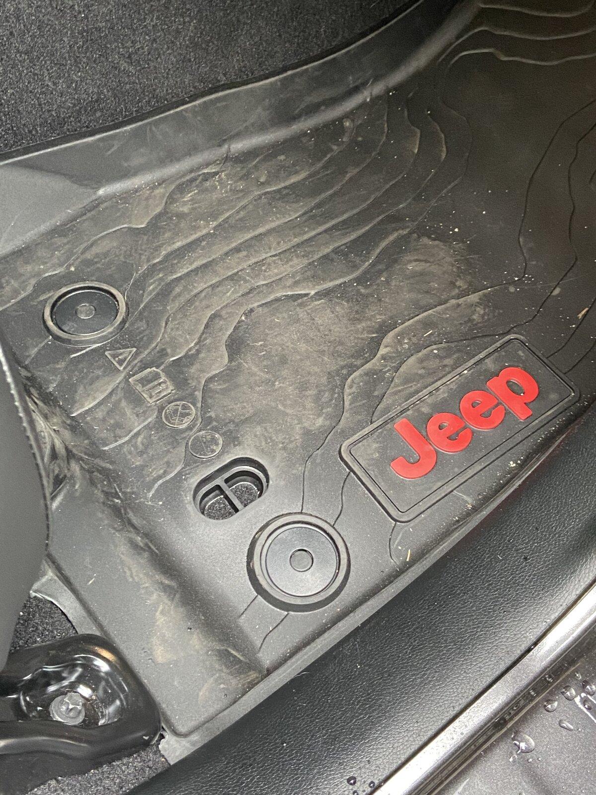

I was able to pop the driver side plug in, but couldnā€™t get the passenger side seated properly.. anyone else have a fitment issue with these? Would rather not go to the dealer for something so simple.
I just used my heel and it popped in
