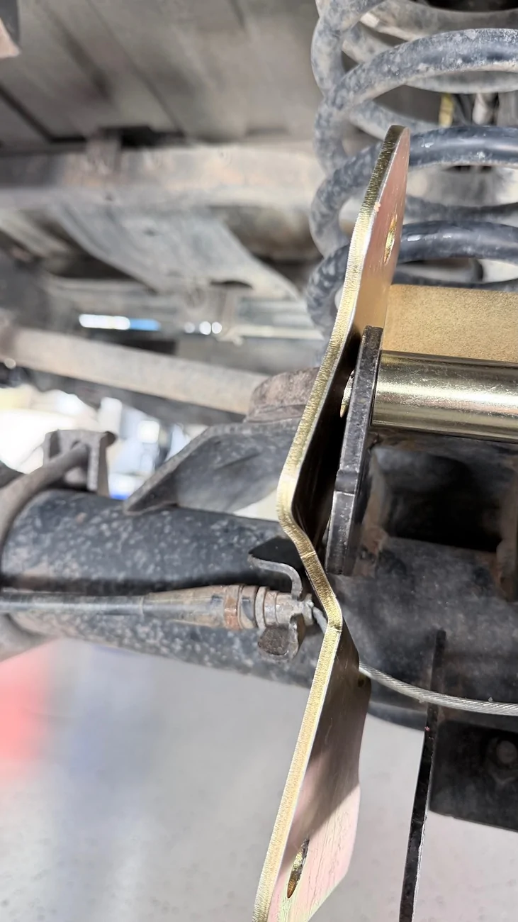

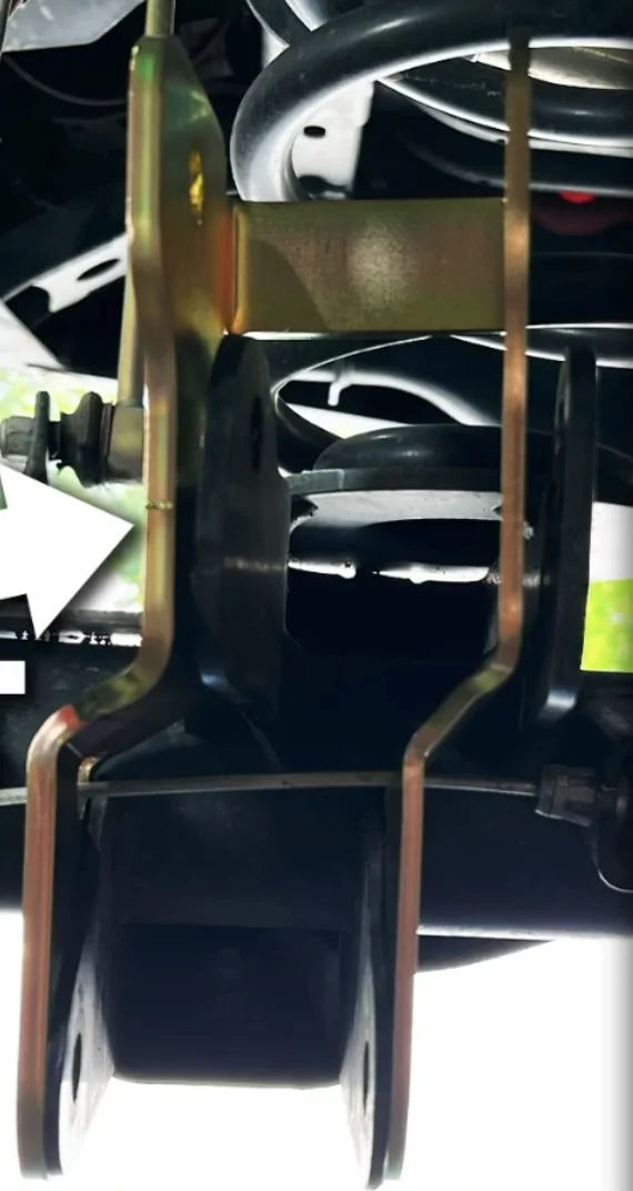

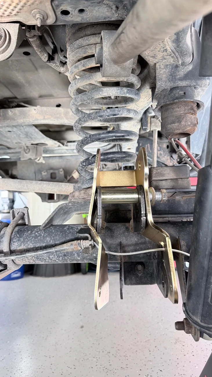

I cannot get driver side on to save my life. Haven’t even tried the other side yet.
Gave up. Tried to just reattach the control arms to the stock brackets and they don’t line up anymore, either. Can’t get the upper or the lower holes to align.
So I’m completely stuck. Any help is appreciated.

Your brackets are bent wrong. I would send them back.

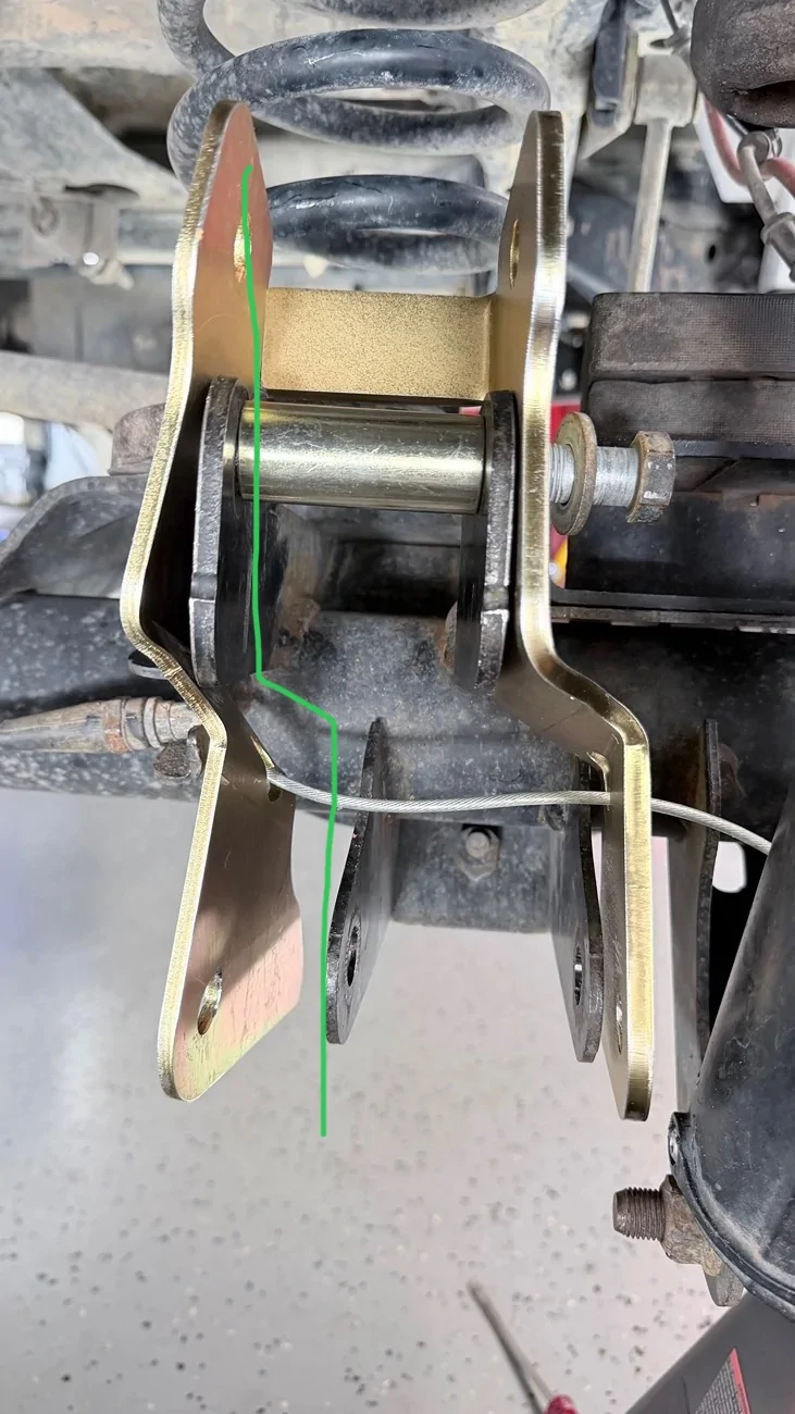

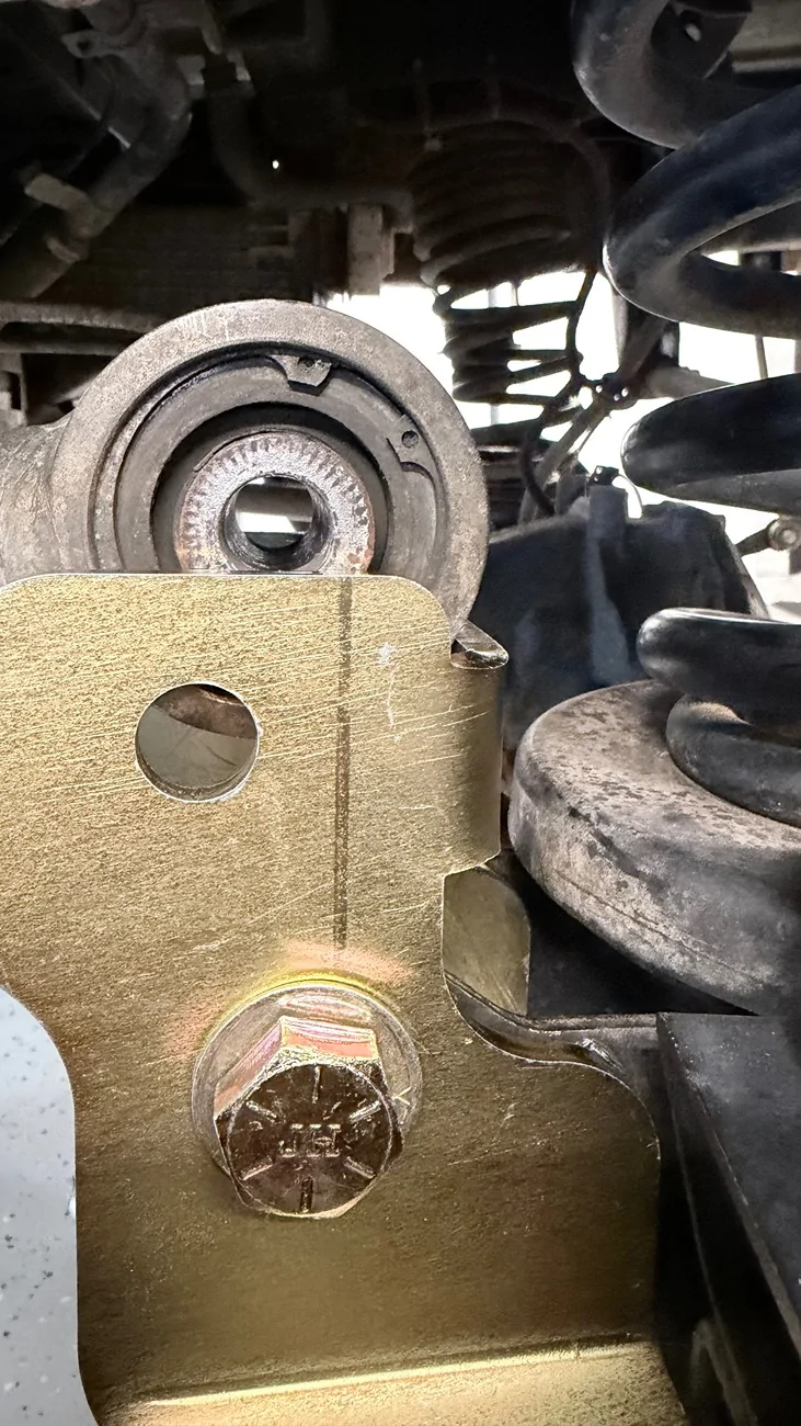

I wasn’t anticipating having to adjust the length of the control arms. The upper needs to be shortened and the lower needs to be lengthened.
Does it make sense that they need to be adjusted or is something else amiss?

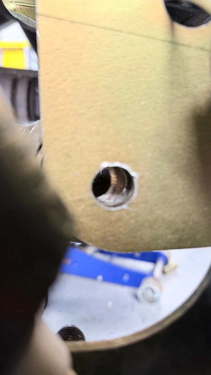

Upper is way off Lower is off, but less so.

Bottle jack under pinion housing will rotate the housing
