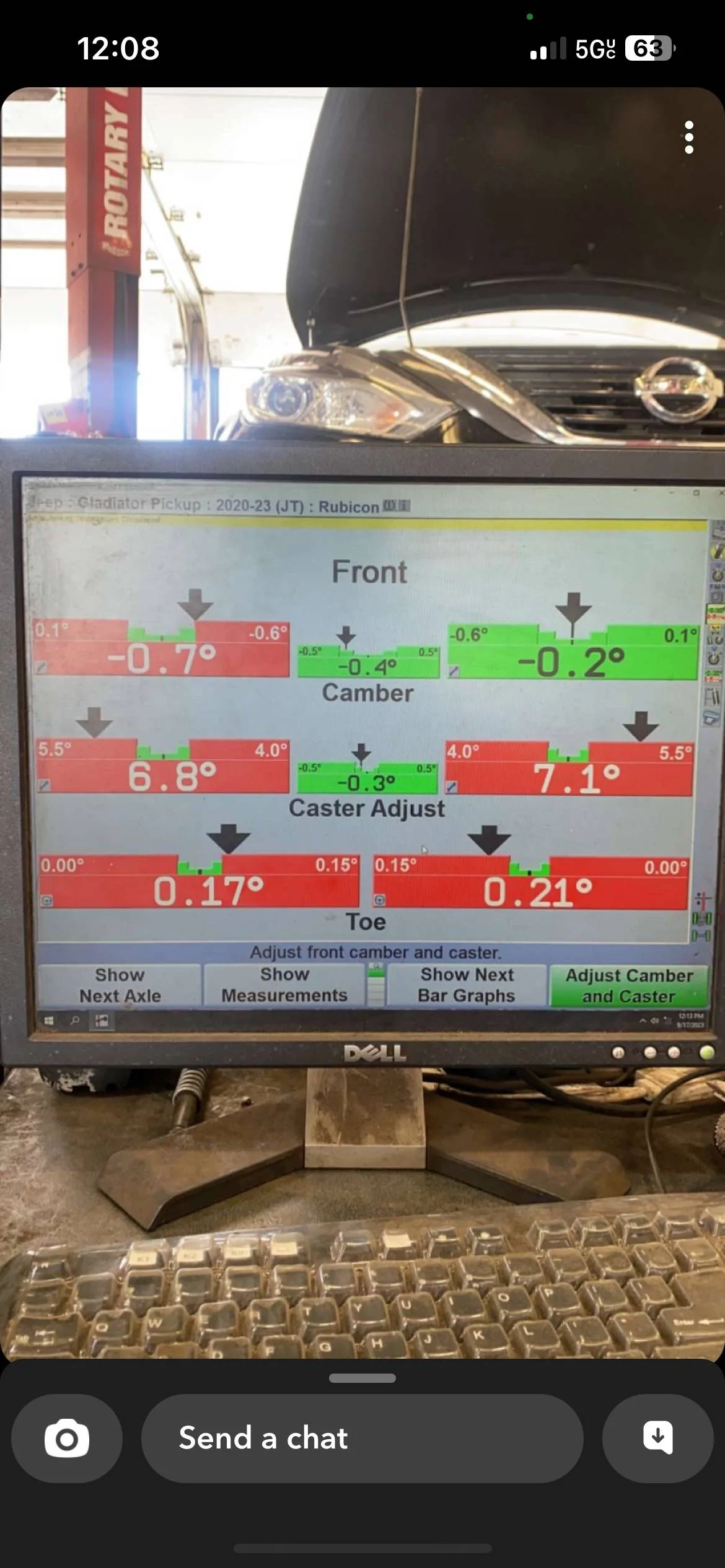

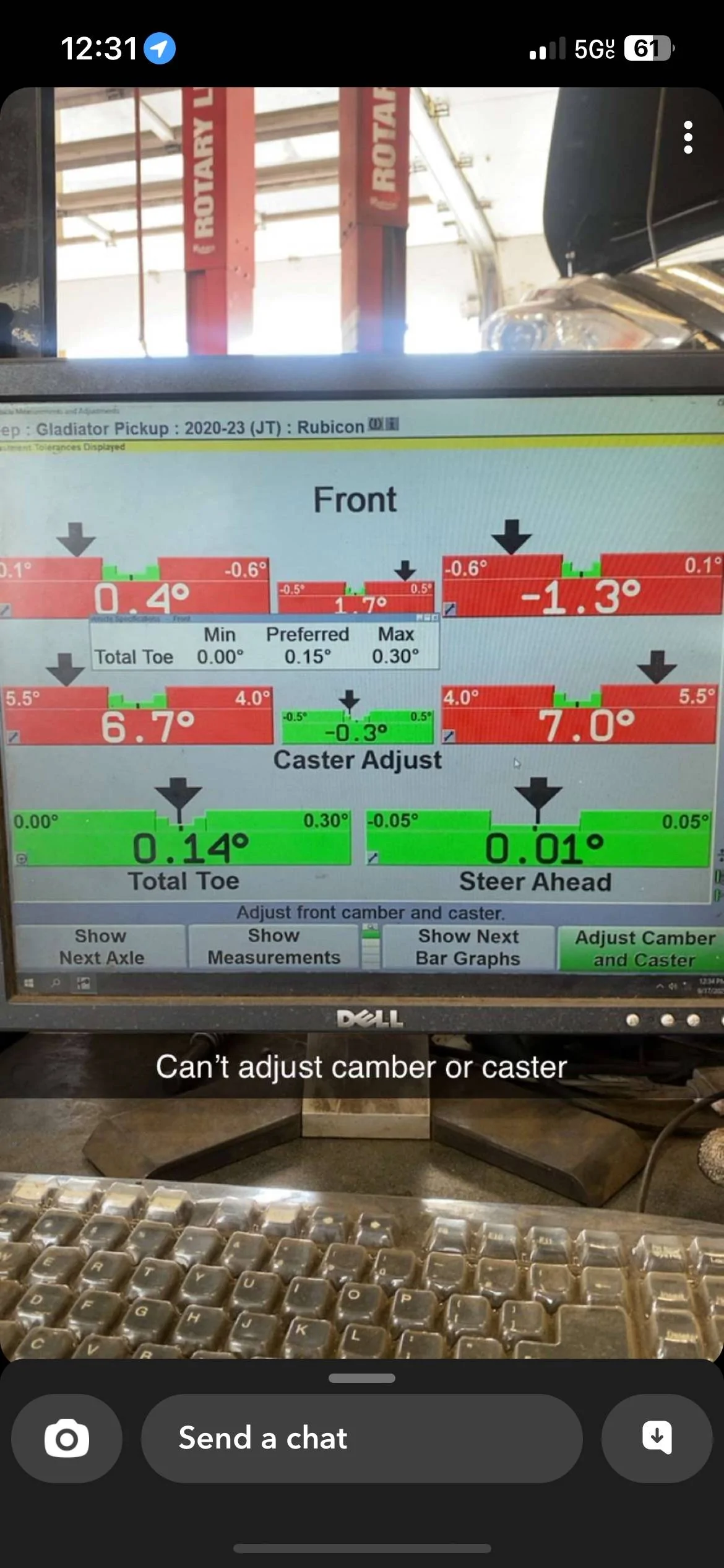

Ok so leaving the alignment Shop posting the pics. Maybe you can help me with this. This is with the Rancho geometry brackets. The core 4x4 control arms on the way. Really debating on taking these brackets off .
Jeep Gladiator Help Spring bow IMG_20230917_124730
Jeep Gladiator Help Spring bow IMG_20230917_124737
