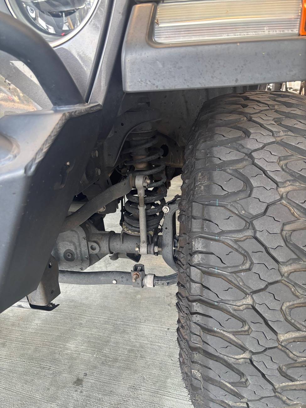

Holy moly spring bow

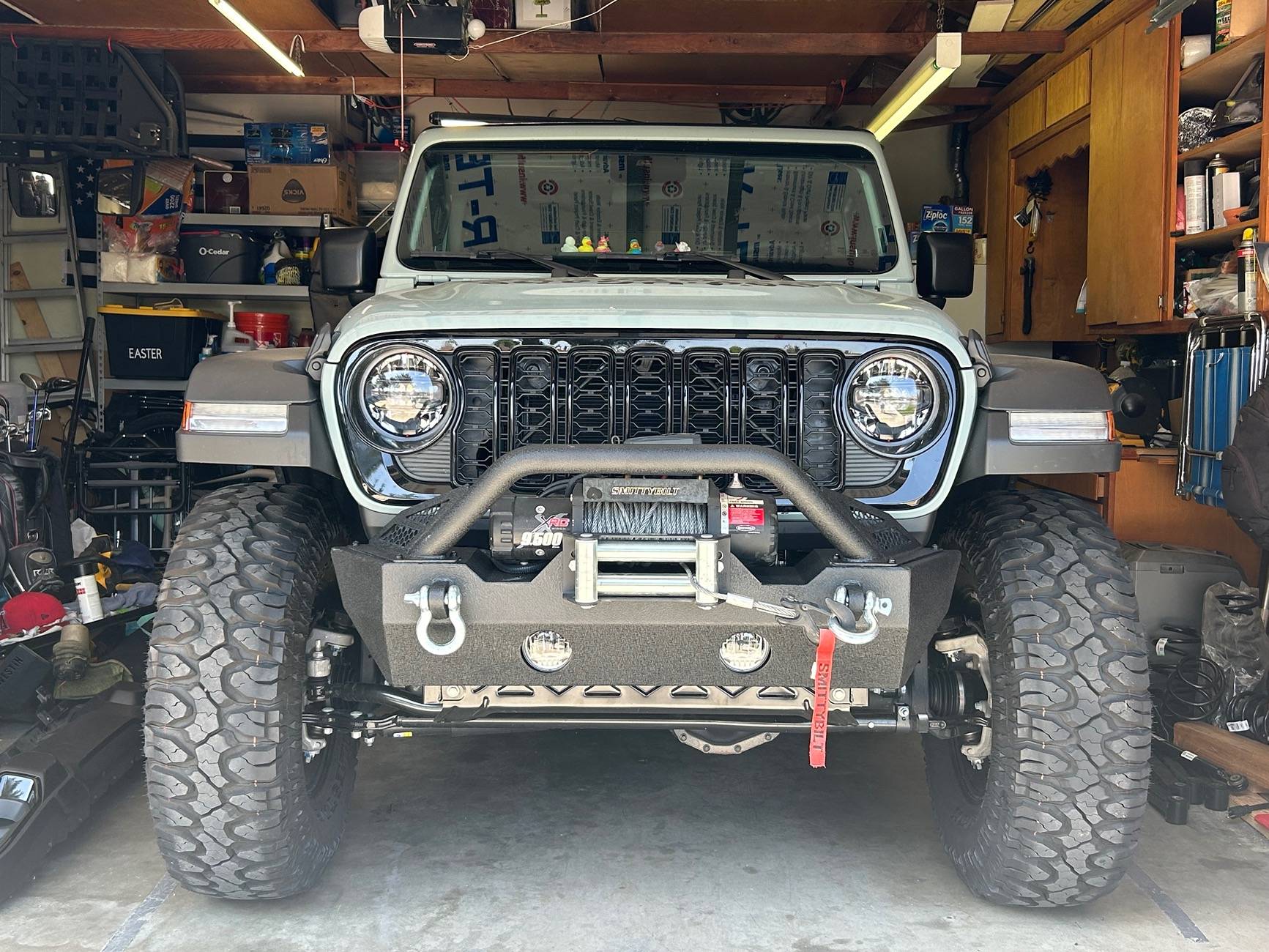

those tires are so over inflated they look like they are ready to burst...
They actually look like Milestar Patagonia tires at 36 psi on an 8” wide wheel.

I had this issue on my 2020 after installing a small small lift. I was able to correct it almost 100% with daystar correction pads.
When was the last time you had your eyeballs calibrated? I suspect 36.5 psi. 🤪
Looks pretty close to me 😂 Some people don’t understand that Patagonias are meant to ride on the crown of the tire for better fuel economy. I can show you a pic of my wife’s aired down to 16 psi that still look round on top. These are at 34psi on stock Willys wheels.

Passenger side had the same outward bow. I did see an adjustable front track bar dull gray in color so I don’t know brand. The control arms looked like stock Mopar so my guess is that this was a 2inch Mopar lift. I mentioned the springs to the service advisor and all he said was don’t start. I’m guessing owner was in the waiting room. I’m not sure what the service visit was for.
That would be Rubicin express forged steel . Heavy duty stuff . They make a duel purpose kit for JL and JT 2 different connecting sleeves one shorter for a JL longer goes on a JT . For a 0-6" lift swear by mine tough as all get out.
Oh... so he IS one of those guys 😂😂

Cheap plastic oem spring perches are worn the eff out. See it a lot.
