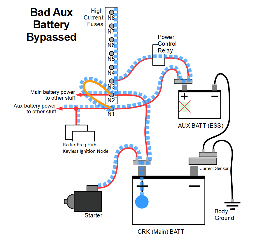

Just bypass the aux battery. No need to remove it now.
At the very least this will isolate both batteries and allow you to determine which one's causing the issue.
1. Remove the AUX ground from the main ground group
2. Tape the exposed connector on the cable to prevent incidental grounding and zip tie it out of the way.
3. Remove fuse F42
That's all you have to do. Now you can charge the main battery and see if the problem is gone. I'm betting it will be.

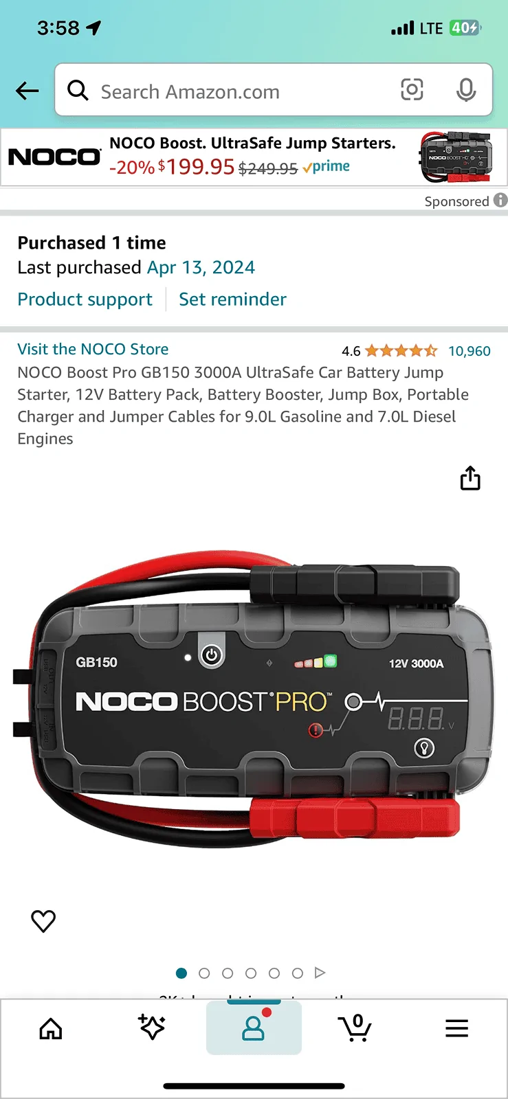

The horn chirp sounding puny was my sign that the batteries were going out…I just didn’t know it at the time. The tech stated they were low, but fine. He put a deep charge on him and within 30 minutes or so they almost left me stranded at a restaurant after leaving the dealership.
I borrowed a buddy’s jump box that had enough oomph to turn over my diesel the next morning when I returned to the dealership and they elected to replace both batteries. While in the dealership I went on Amazon and purchased the unit pictured below since battery cables won’t do you any good if there’s no one around to jump you off.
