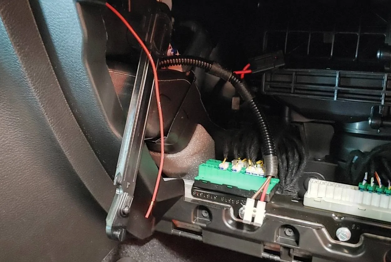

40,440
53,854
Just to be sure. There would be no problem if I only connected the red wire to the new harness. There is no requirement to use the brown screw terminal at all as long as the rocker switch gets grounded to the frame with the supplied black wire.
The ground wire is likely for a light inside the switch.
As long as you connect a hot wire to where it needs to connect and run the other from switch to solenoid, you'd be fine, only missing the light.
The ground wire can go to any good ground. I did use one of those lighter/12v outlet extension/taps - to supply ign power to my snow plow controller.
The red wire is the power wire to my plow controller. You can see the short 2 red wires - fuse holder in the lighter tap, and the white is where you can connect to get power and ground.
Jeep Gladiator help with warn interrupt in cab rocker switch install 20221007_144607_HDR
