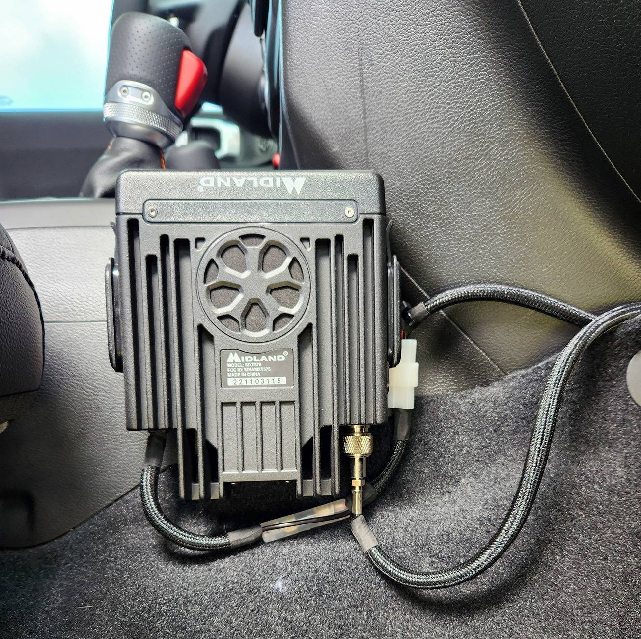

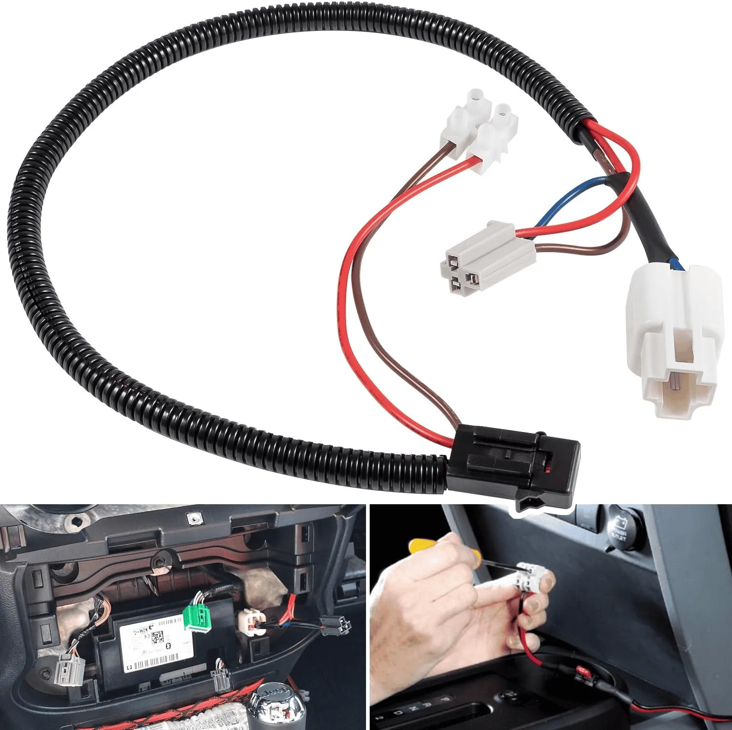

I had a similar requirement mounting a Midland MXT275 to the passenger side of the console. My solution was to tap into the 12V power outlet circuit (i.e., the 'cigarette lighter' socket). This is a higher amp capacity circuit, but note that it is only powered when the vehicle is in Run or Acc.
To avoid cutting into the harness, I used the adapter below. I've seen in on various vendor sites - got mine off of Amazon. https://a.co/d/gc2lzvG
Here is the final setup. Note to installer: I needed to R&R connecters on one end of the cable to feed the wires through the console, but that was a simple task using a small pick to pop out the crimp connections from the housing.
Nice write up thanks. I am positive that this information will prove useful for anyone doing the install. As for the power requirements I believe your model is designed to run from the cigarette powered whereas the 575 requires more power.
SamJ3
Sam
Jun 7, 2022
120
158
33706
2022 Gladiator Sport
Technology Research and Advisory
You are welcome. Good point, that one should be mindful of power capacity. You are correct that the 275 was designed to be powered from that source.
The Jeep's 12v dash outlet is rated for up to 160W, 13A @ 12v. (More than 13A will blow the fuse, per the manual.)
The MXT575 maximum current (per Midland) Is 10A. The MXT275 requires less - 3.5A maximum.
That said, you are probably safe tapping into the 12V dash power circuit.
