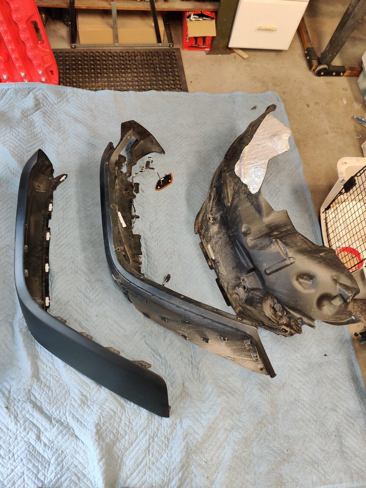

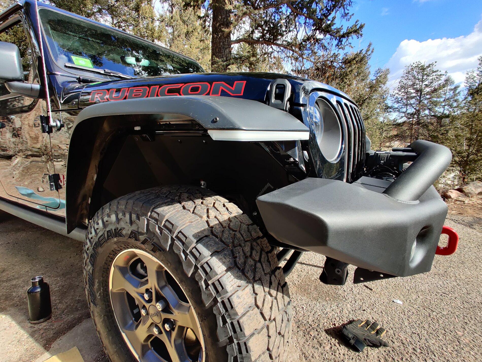

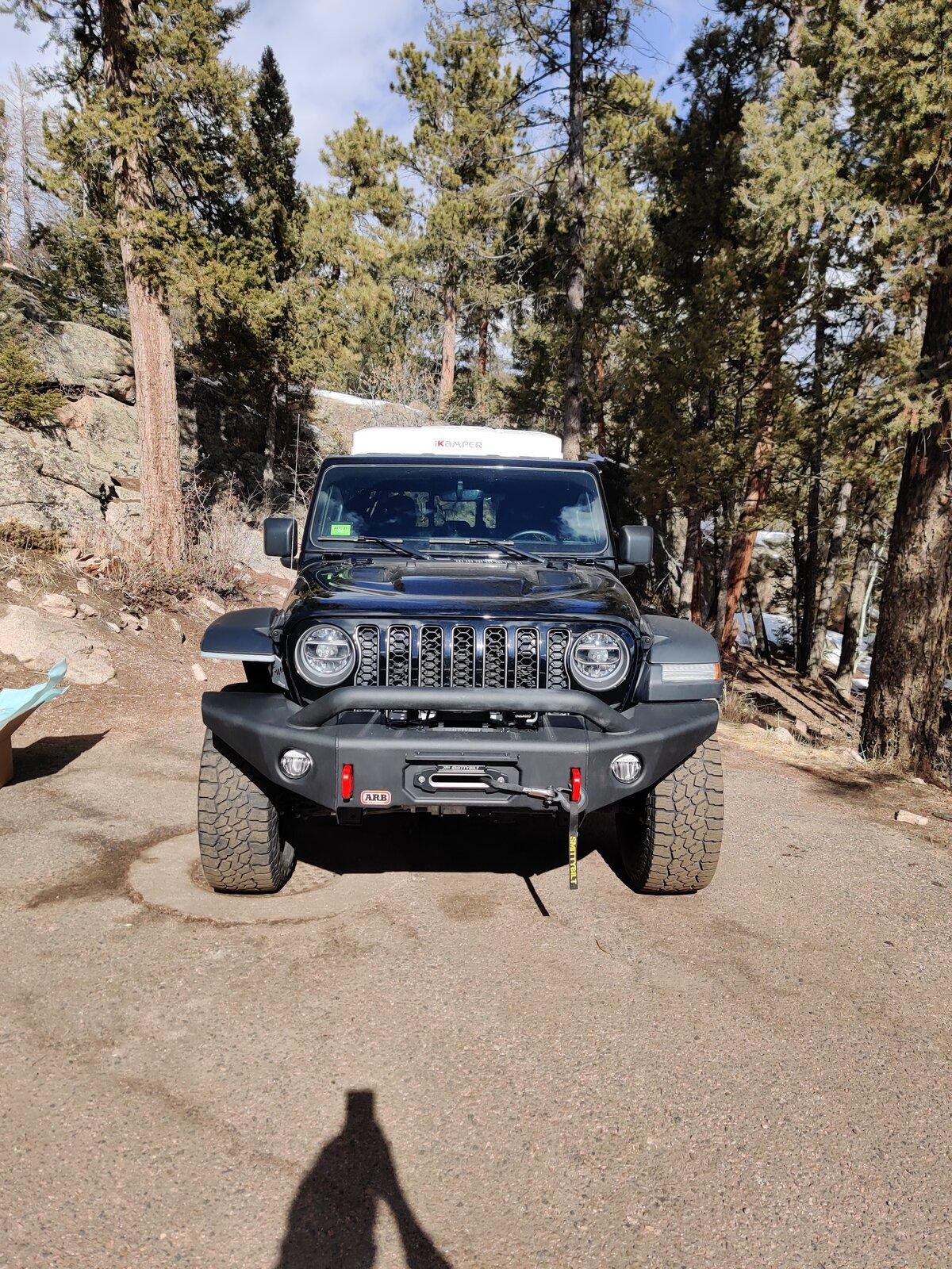

I just finished doing this as well, went with QUAKE LED DRLs (local company, and on sale) but then also did AAL fender liners at the same time. There are a few ways to accomplish this from complete fender liner removal to trimming the liner around the light, your choice will depend on your goal. If you want to buy more space for larger tires complete removal is the best way to go - though you end up removing 39 plastic welds (easy) but it's a no going back type of scenario. Here are some pictures of my setup. I plan to do a writeup of this if anyone wants to see the steps, and my challenges/take on it. I will say that removal of the liners results in a less firmly attached flare to body attachment. I remedied this while installing the AAL fender liners considering they came with brackets that attach through the flare using hardware vs. the OE plastic clips.
Pictures of my setup below, and the flare disassembled showing all the pieces. Also note the tabs on the remaining flare - you have to trim those off too for full commitment, in the flare disassembled picture you can see the plastic welds (bosses) in the middle piece. Finally the picture I attached shows the driver side not yet complete for a pre/post mod side by side.

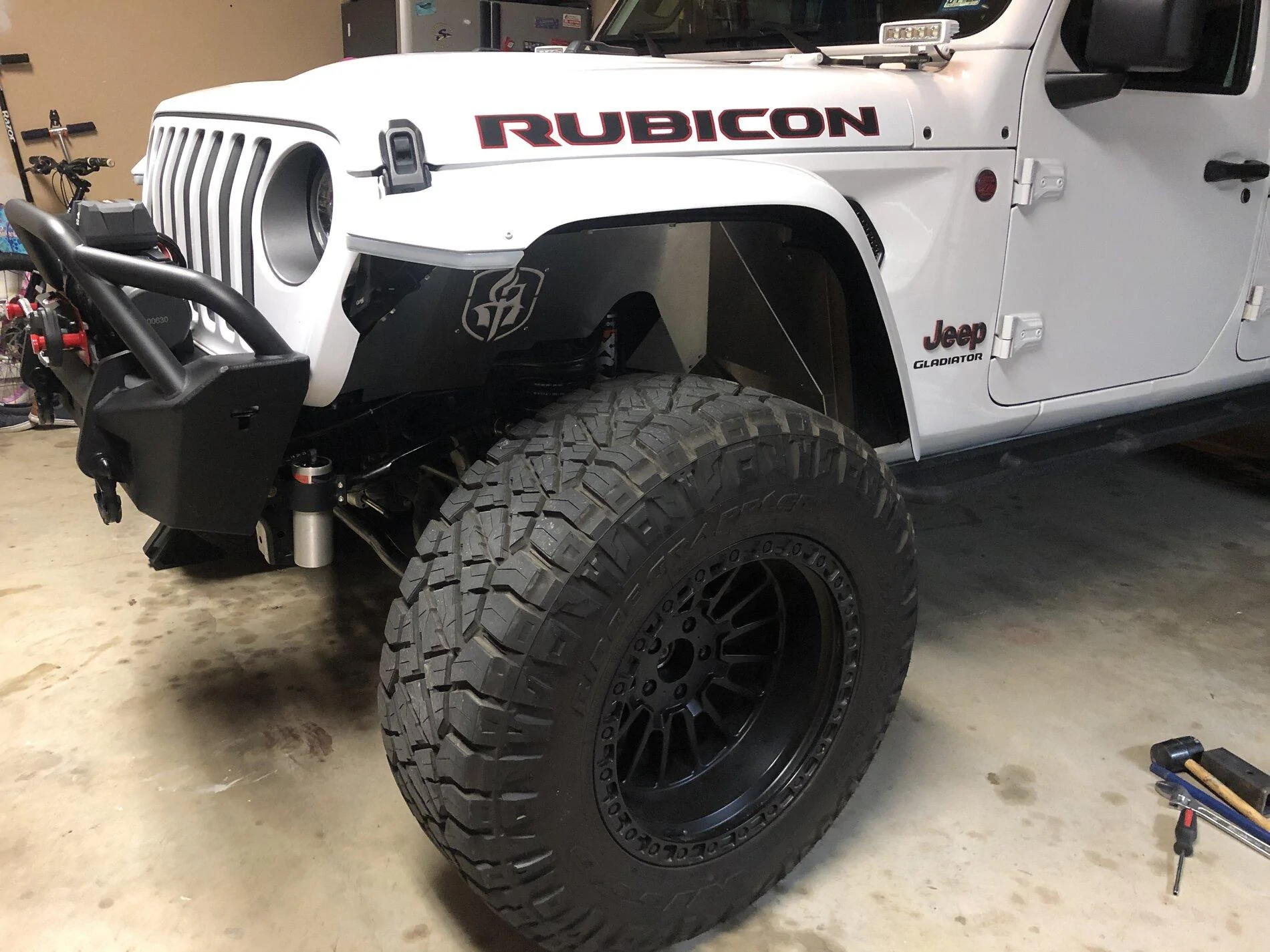

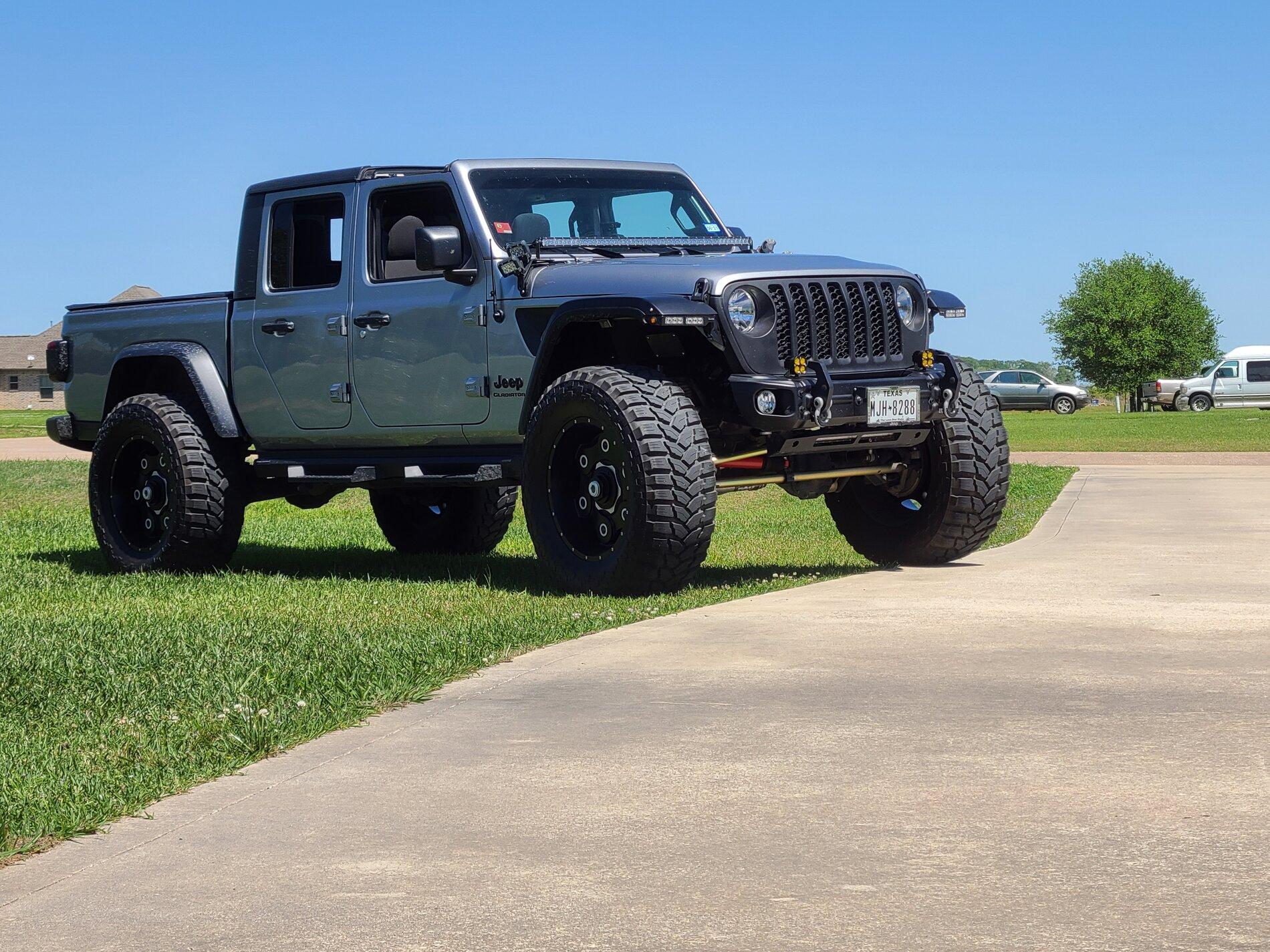

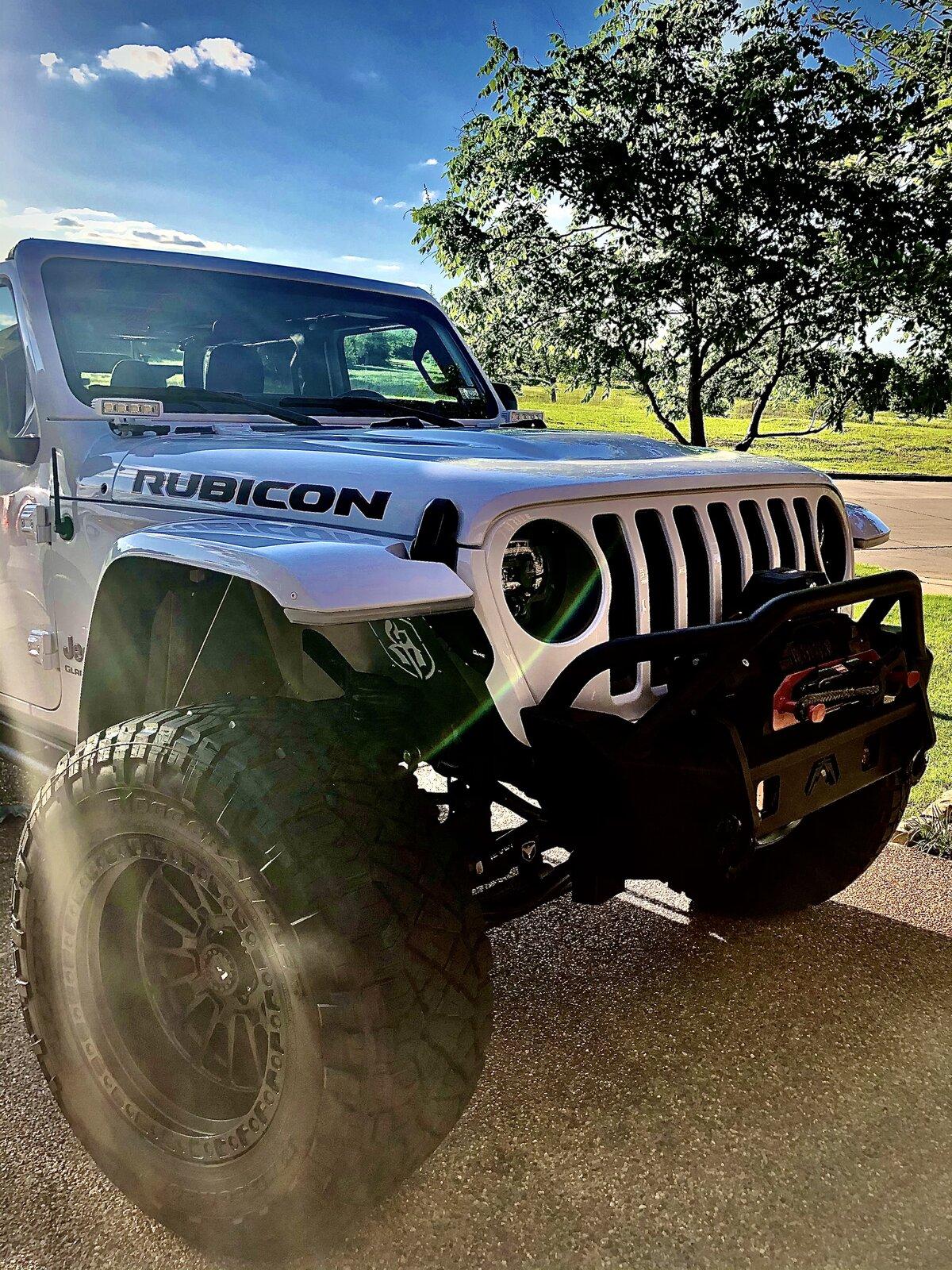

Quake with road armor fender liners.
Jeep Gladiator High line fenders??? BF865676-6E41-449E-9D32-4BFB1E9490E8
Jeep Gladiator High line fenders??? EDB9945C-5DFE-4EA3-B381-F55F8AD5C049
Jeep Gladiator High line fenders??? 591FD2D1-360B-419A-A595-4E792D5340CF
CWGrisw0ld
Aug 14, 2020
139
275
2008 Jeep Rubicon JKU, 2020 Jeep Rubicon JT
The only thing I did was put a nylon spacer underneath the bolts where they mount the lights. This elevated the high line bracket just enough that it is putting a slight upward pressure on the fender and I haven't had any flopping.

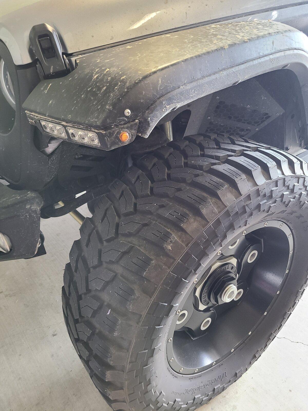

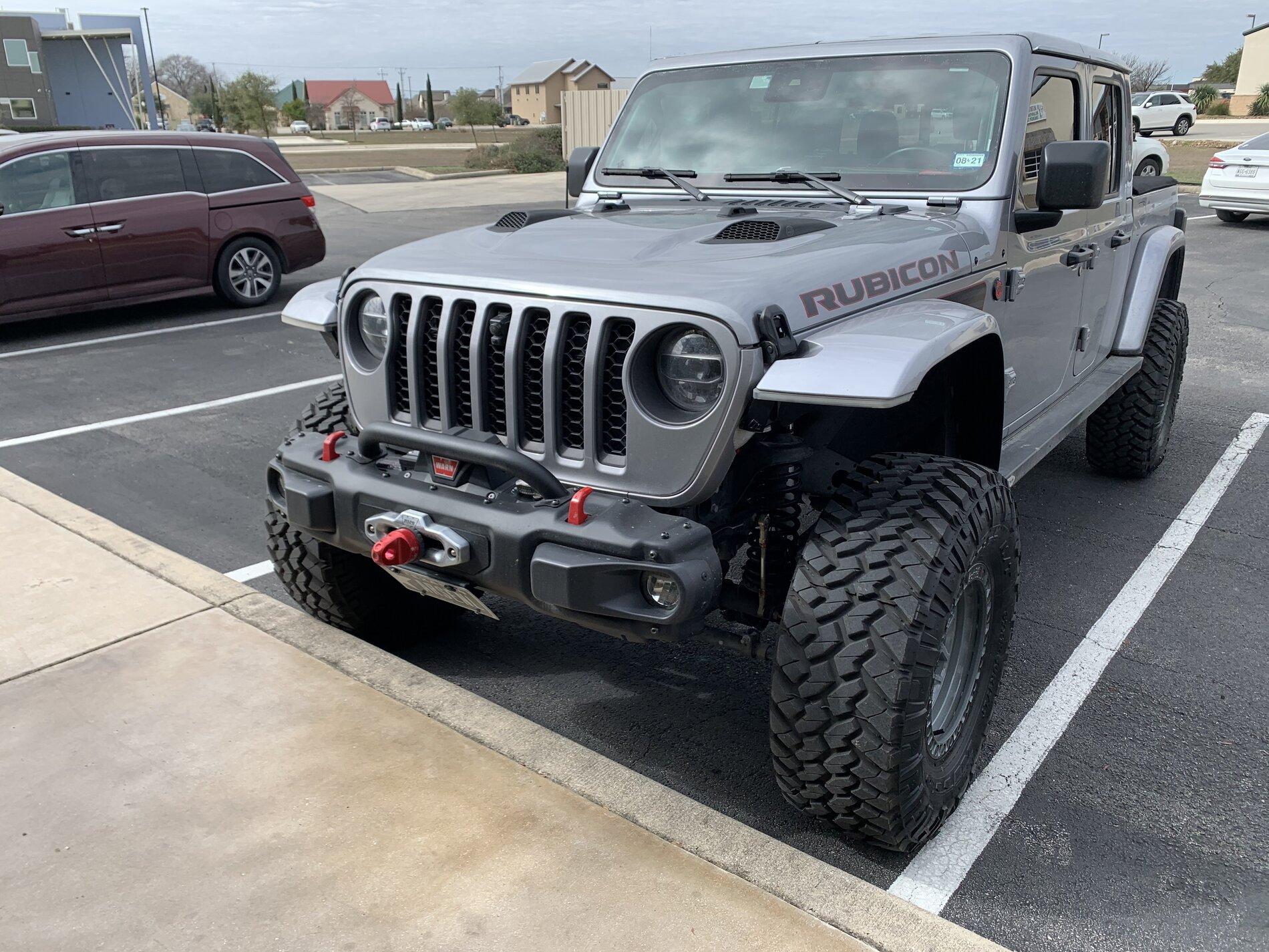

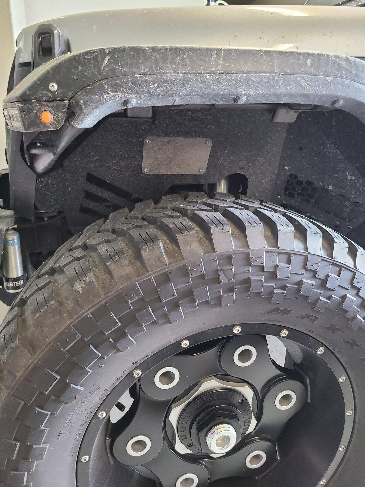

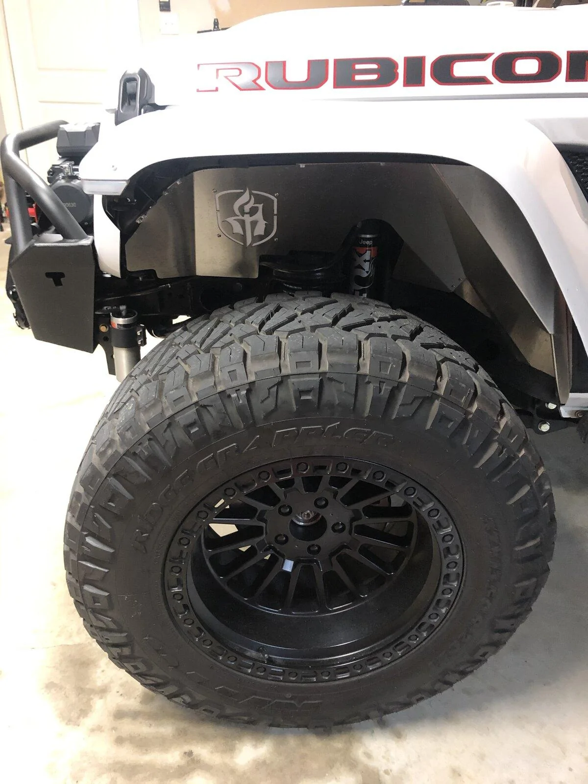

I went with the Quake chop kit and it has been great. It was an easy install and I removed the inner liner but retained the inner fender lip. I installed the Nixon inner fenders and they weren't bad but the Synergy brace interferes with it - had to do some engineering to make it work.
Jeep Gladiator High line fenders??? 20210522_093835
Jeep Gladiator High line fenders??? 20210522_093827
Jeep Gladiator High line fenders??? 20210411_121042
