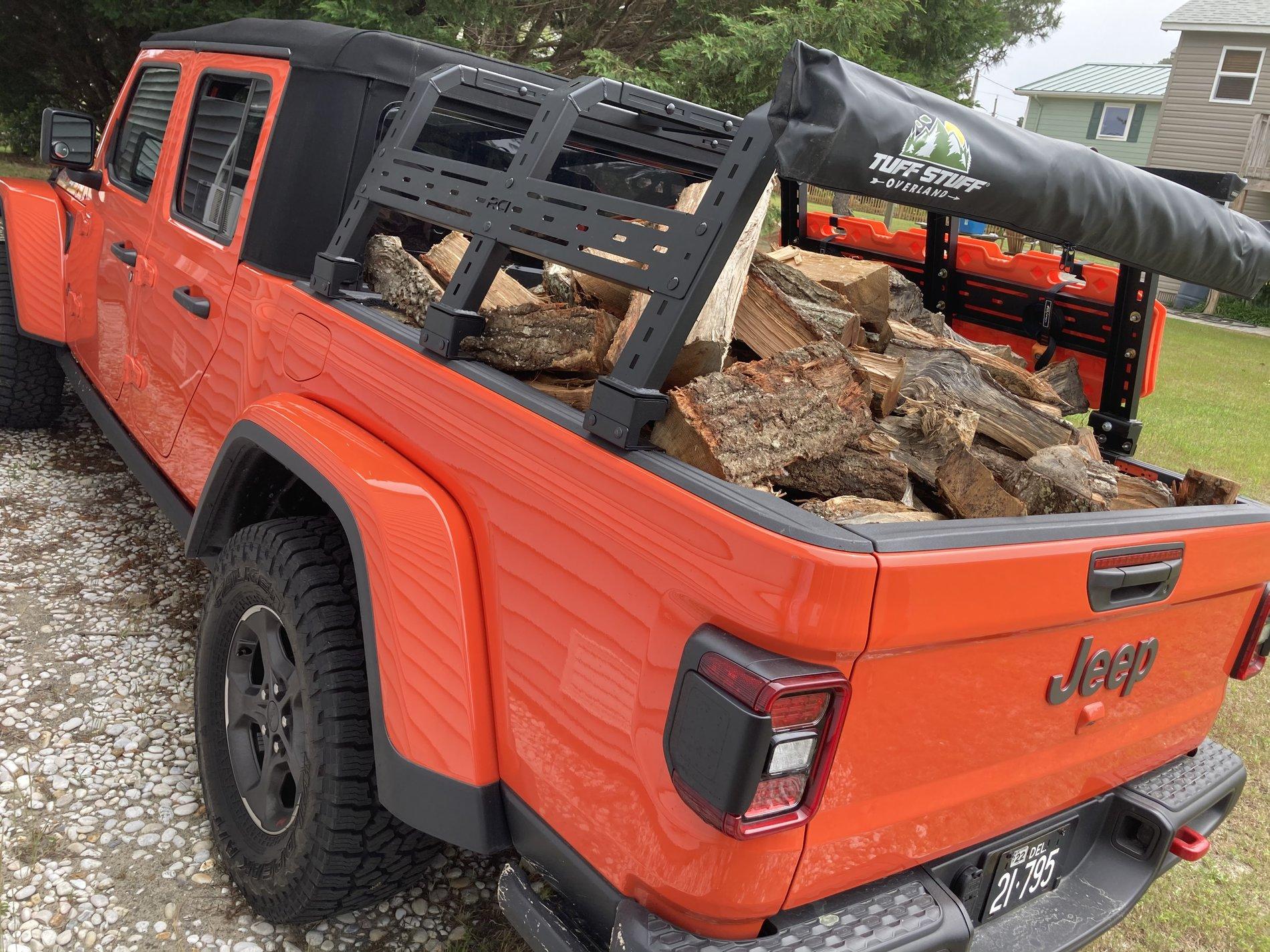

htremper
Henry
Apr 29, 2019
174
300
2020 Gladiator (with toddler booster seat!)
Rockstar
So many threads on this and yet I can’t seem to find an answer. Is there a rack that works with the trifold factory tonneau cover? I need it to be higher than the roof to carry paddle boards. Also wondering about a multi layer rack option that would allow for an rtt to deploy on lower level while still being able to carry paddle boards. I kno w the paddle boards would have to come off below deploying the rtt.
I have the same issue with the factory roll cover which I had to sell despite me getting brackets to fit the cover.
The issue is how far the cover fits on the top of the bed. The issue for you is that plus able to get it past the clips.
However...the clips (which are extra) gives another 4” to the 18” rack which puts it just high enough for a SUP or a RTT without you smacking your head.
So If the cover you have is narrow...there is a chance that it will fit if it’s not...then ...like I did...will have to get a different cover.
if you like I can send closer pictures with measurements of how the clips fit on the truck
Jeep Gladiator Higher than roof rack that works with factory tonneau cover DC73A60D-89F6-428E-A3CF-AEE018901274

Please do some closeups would be great. What rack is that?it looks good!
htremper
Henry
Apr 29, 2019
174
300
Rockstar
RCI overland
I can tell you it is solid and fits without drilling and pretty easy to remove.
Of course I did paint the bolts black before installing :)
traveling today will send you detail pics with measurements in the next day or so
