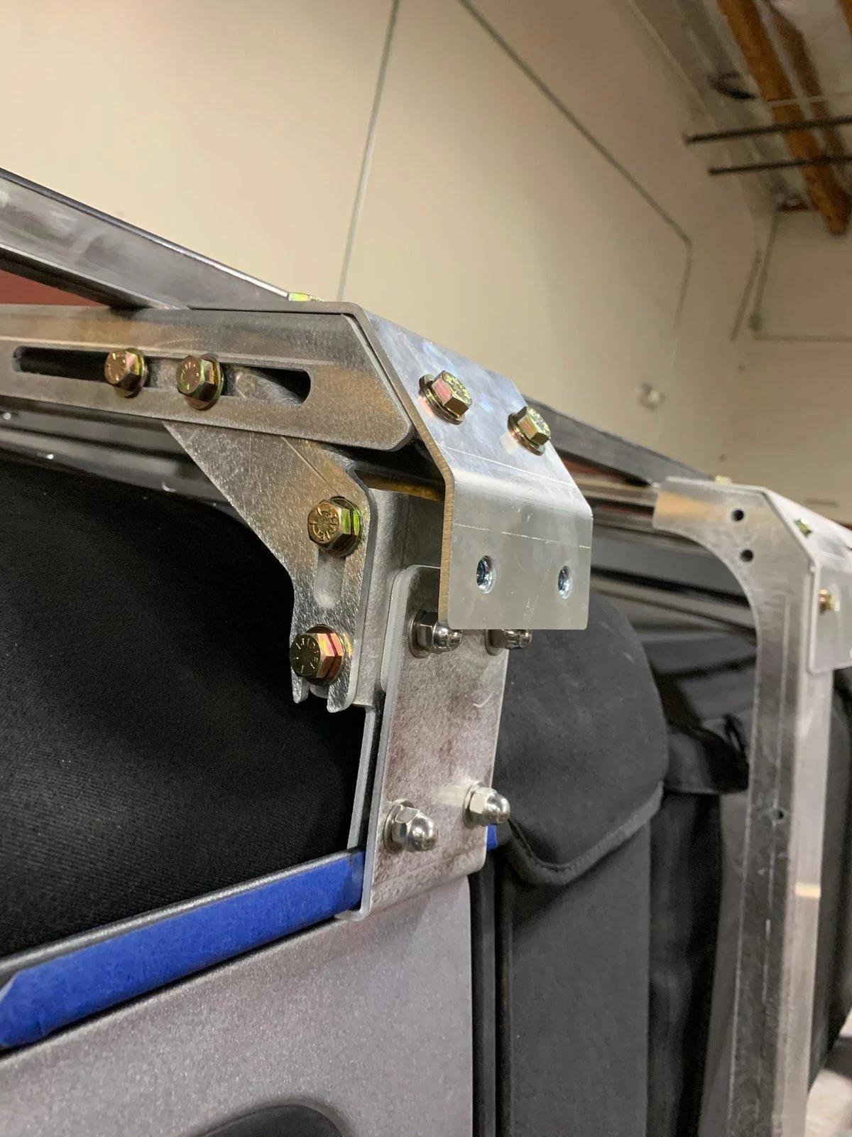

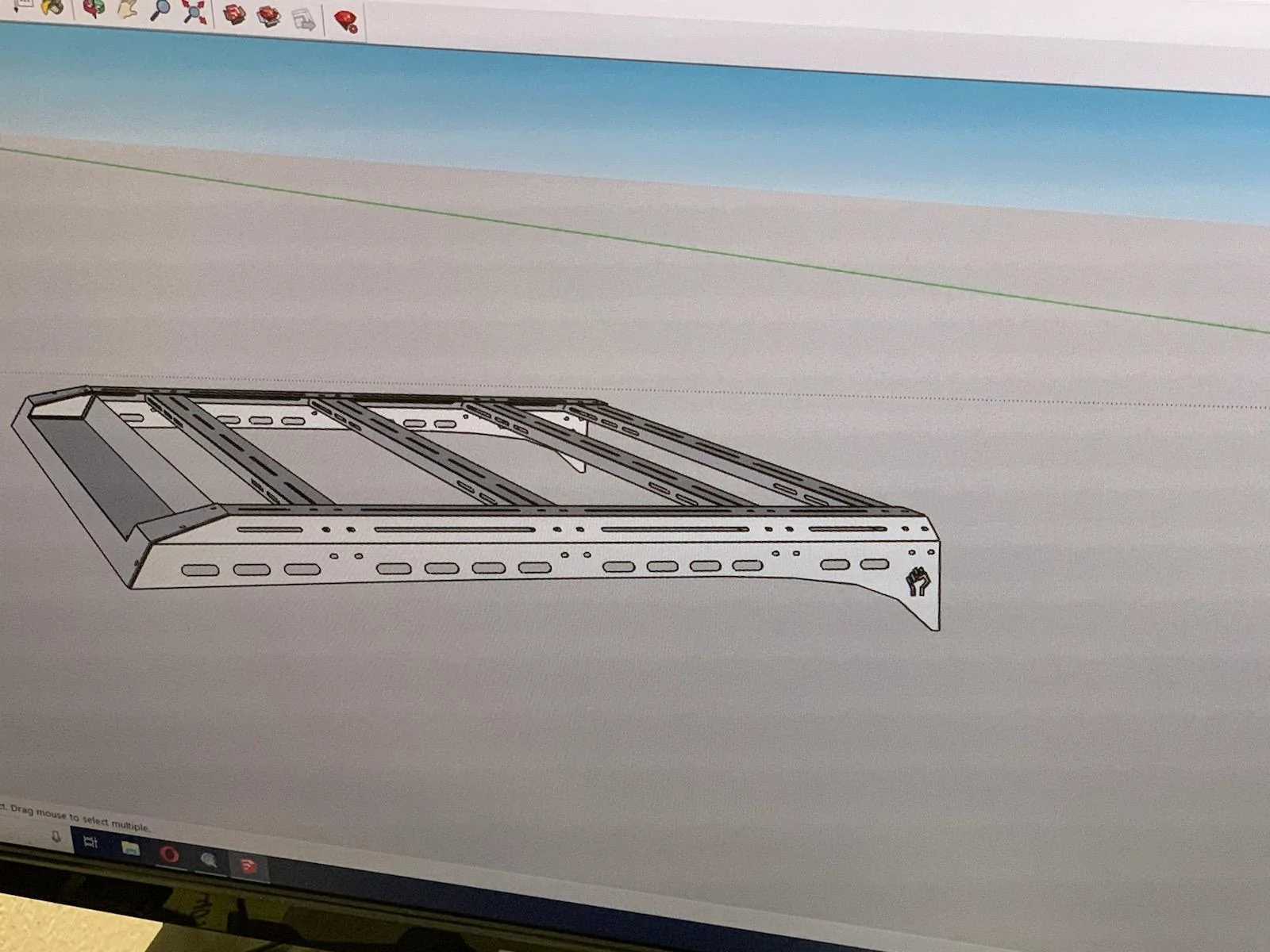

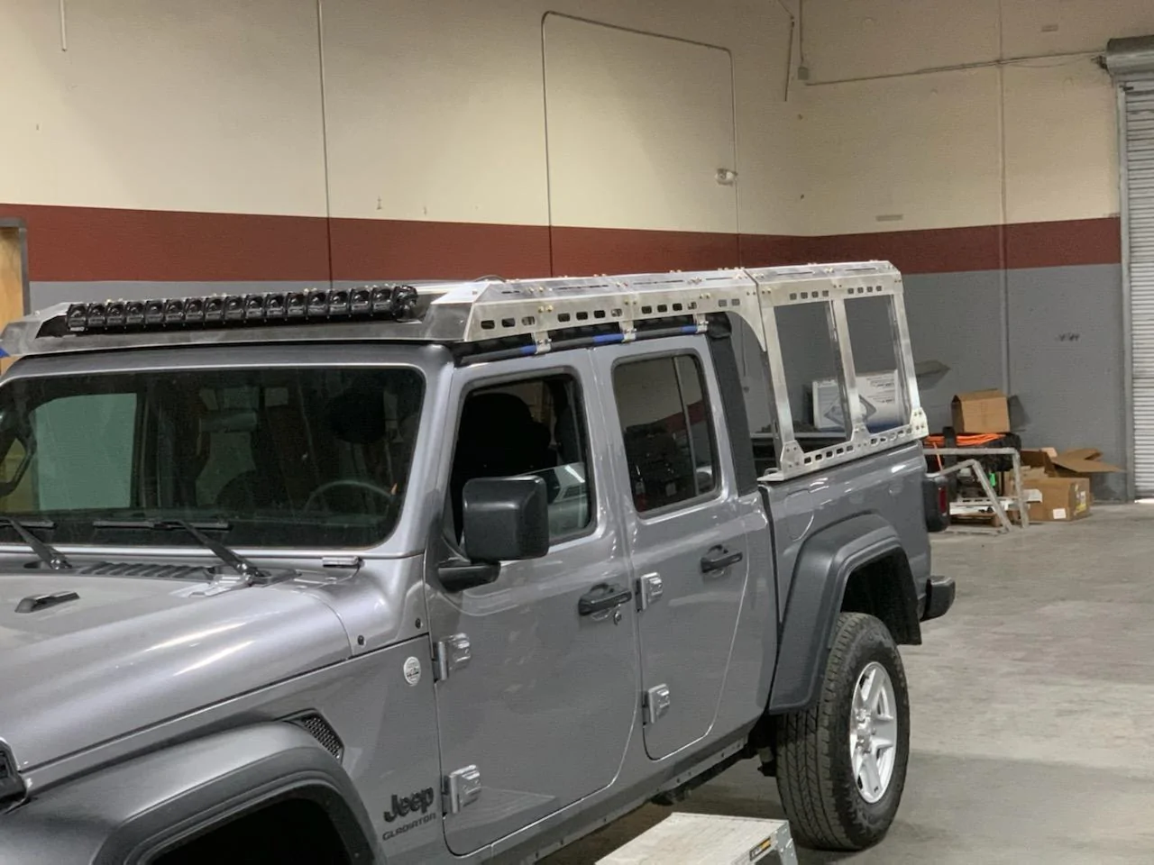

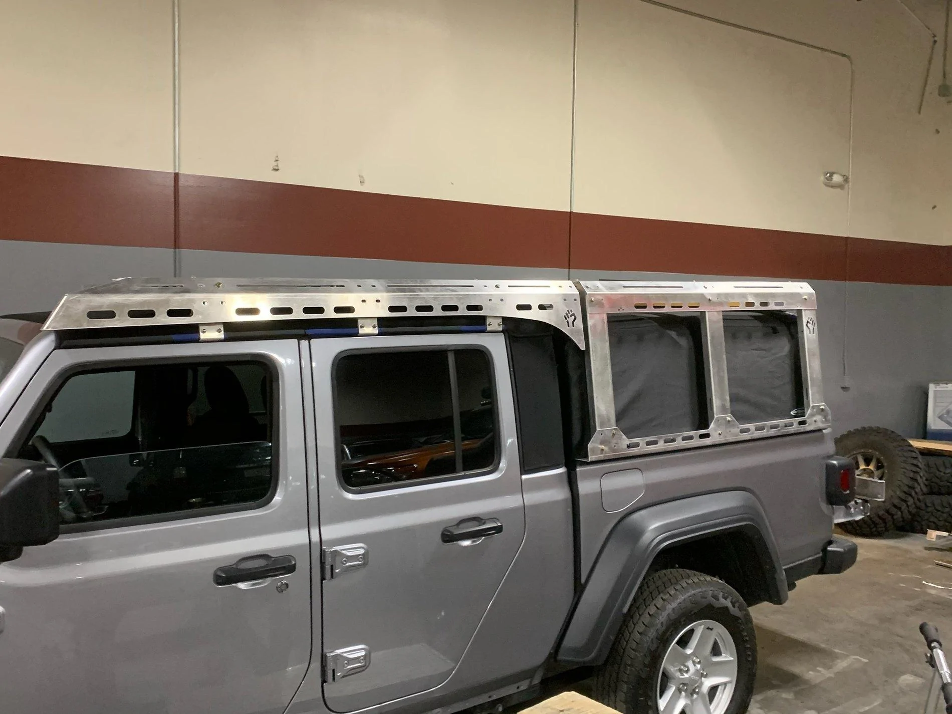

Thanks! As this is their first gladiator,they have a good bit of R&D. Luckily they can reference their tacomas and make some changes as needed. They hope is to put this into production if there's enough of an interest... seems promising! Here's some pictures of the front rack build

I know they've been quote busy with electrical and equipment upgrades. They may not want to post too much until they have a dialed in product. They are also working on a rwck for my soft top but have some hurdles. They had to overcome air turbulance causing the softtop to vibrate making it sound like the 1 window being down syndrome. They are trying to fix the last issue for the front wind deflector... as the gladiator windshield isn't the most aerodynamic, its been some extra work trying to get the rack to be quiet. Here's to pictures

-not sure if it can be folded as of yet... it would be a clearance issue at the middle point but with the rack being higher to lining up with the softtop(it's taller than hardtop), maybe itll work. I know it didn't work on the tacomas though.
-the cross rails are removable or have the ability to add more for more weight. Ben says on road use: each rail supports 250lbs(default is 3 cross members) and offroad crazy stuff is sace for 150lbs per. Like I said you can add more as it's modular... re-reading your question, yes it's are just clamped and works with the existing softtopper clamps, but im sure he'll have his own made if you don't have the softtopper.
-the sides are pretty easy to get to to roll up. ALSO, the side panels are easily removable. He mentioned about being able to take off and put on a garage wall with your offroad stuff attached for easy transfer. The panels are a new style with the molle cutouts for whatever configuration that you're trying to achieve.
He hasn't talked to me about a shorter version... but thats due to getting the rack to be a level front and rear config.

Yes I was bummed at first they didn't have one before, but stoked that I could be the test bed. The rear rack is complete and they are finalizing the wind deflector for the front rack... while upgrading their building, AND knocking out their regular business manufacturing. They're super busy but are dedicated to producing an excellent product. They're strong(holds 750lbs by default, durable(zinc coated and then powdercoated), and light weight(aluminum weighing about 50 lbs). They have spent a lot of time testing components to confirm that they will hold up to rough conditions. The rack itself has been developed and used for over 5yrs now and seems to be a tried and true product.

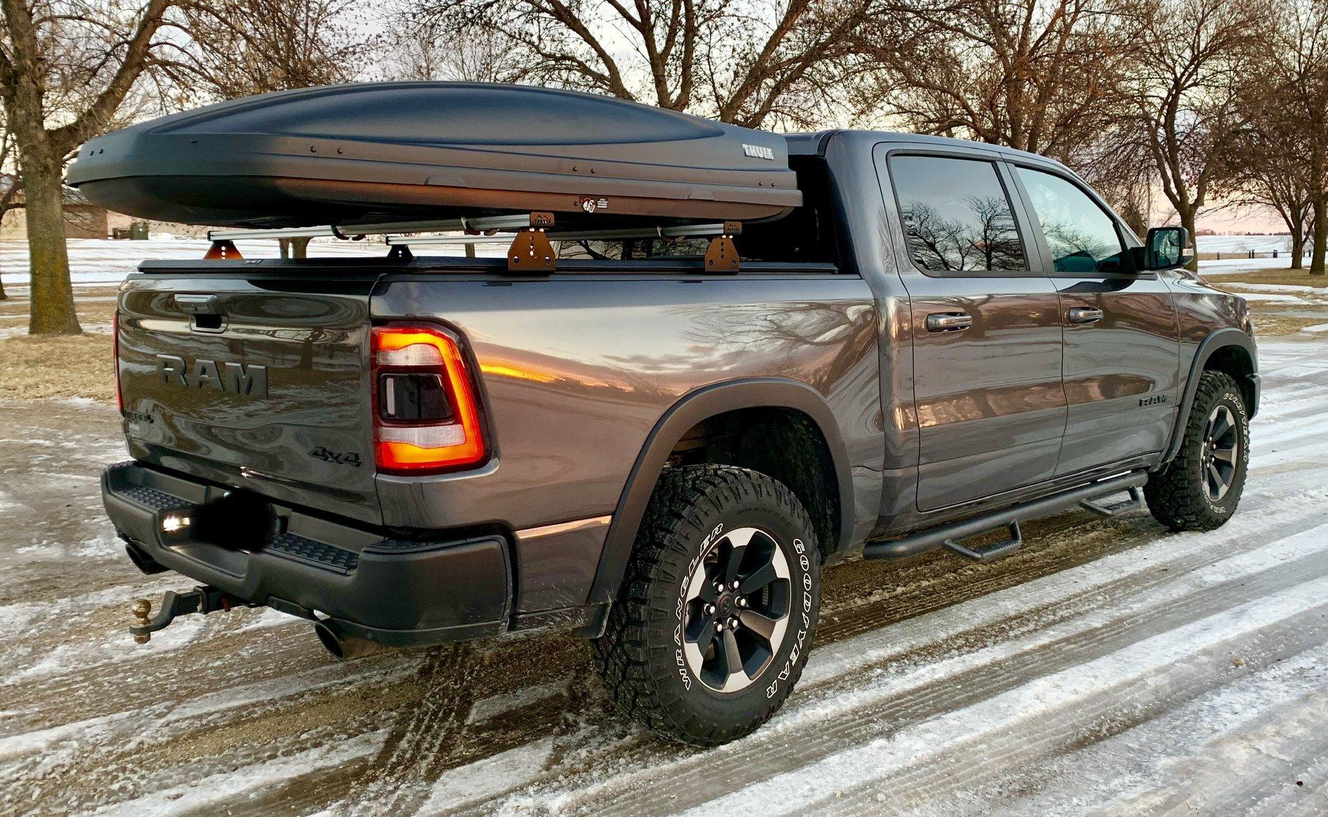

I used Voodoo Fab universal cross bars to mount a box for our skis. Mounts under the Truxedo tonneau rails. Works great for my needs. Not sure if I’ll do this with the gladiator or mount the box over the cab.
http://www.kbvoodoo.com/shop/universal-crossbars-for-tonneau-covers
Hey man did you ever figure this out? I just ordered a Jeep Gladiator and I already have a truly XL force Carrie earth that I would like to be able to use on the gladiator. But it is 6 1/2 feet so it will definitely overhang trying to figure out how I can mount it The only thing I can think of is using the voodoo High mount. Thanks.
