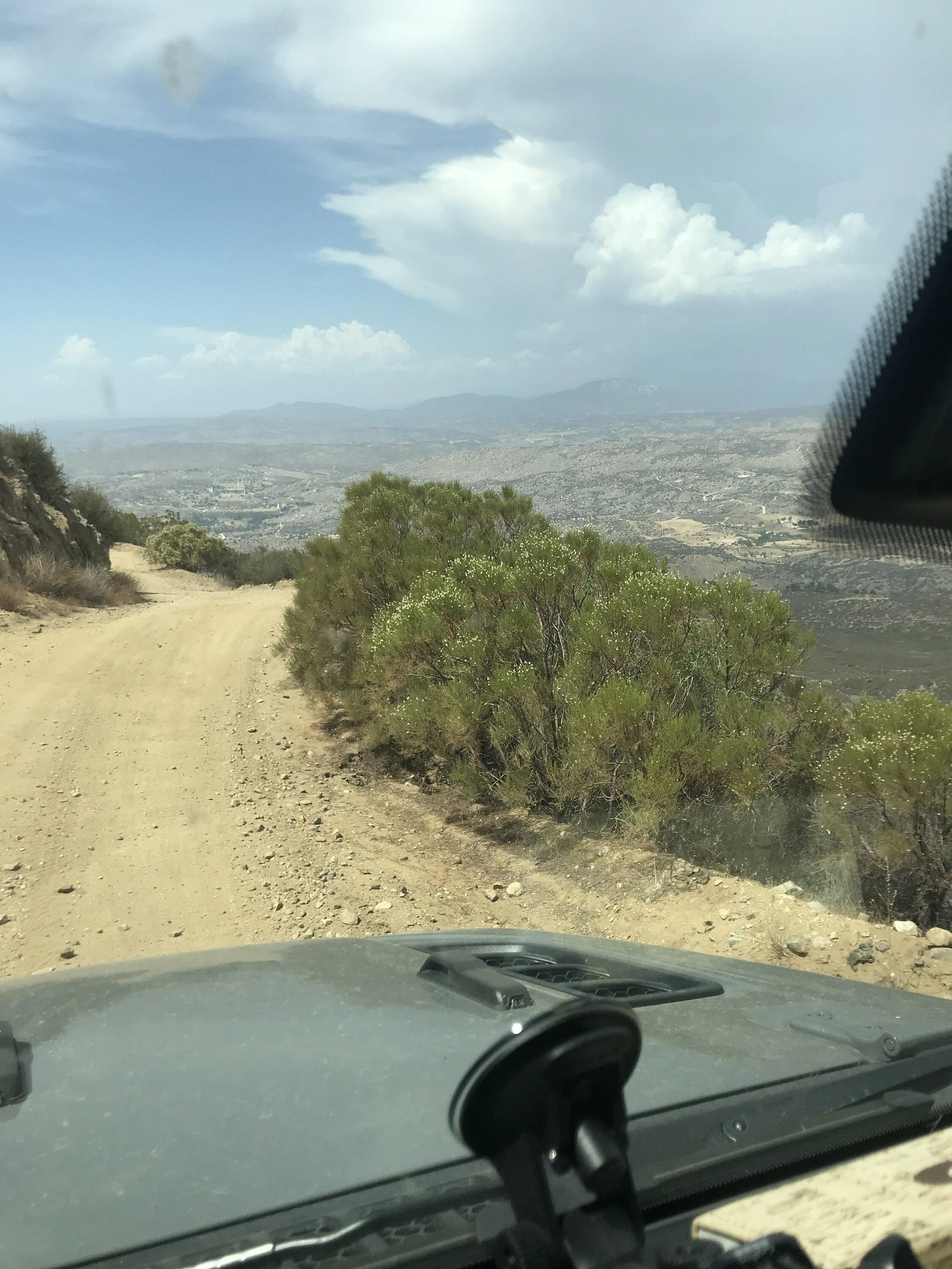

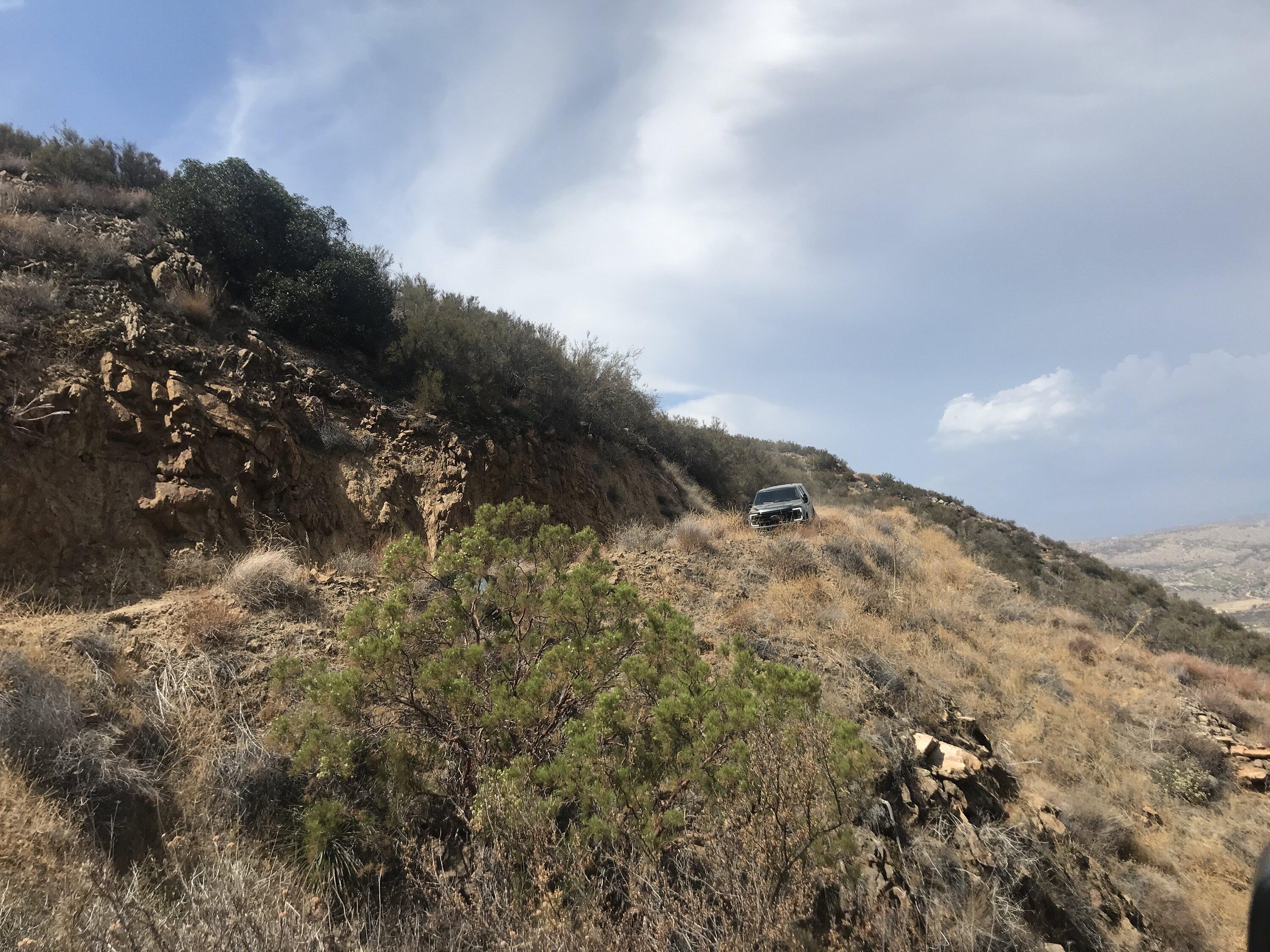

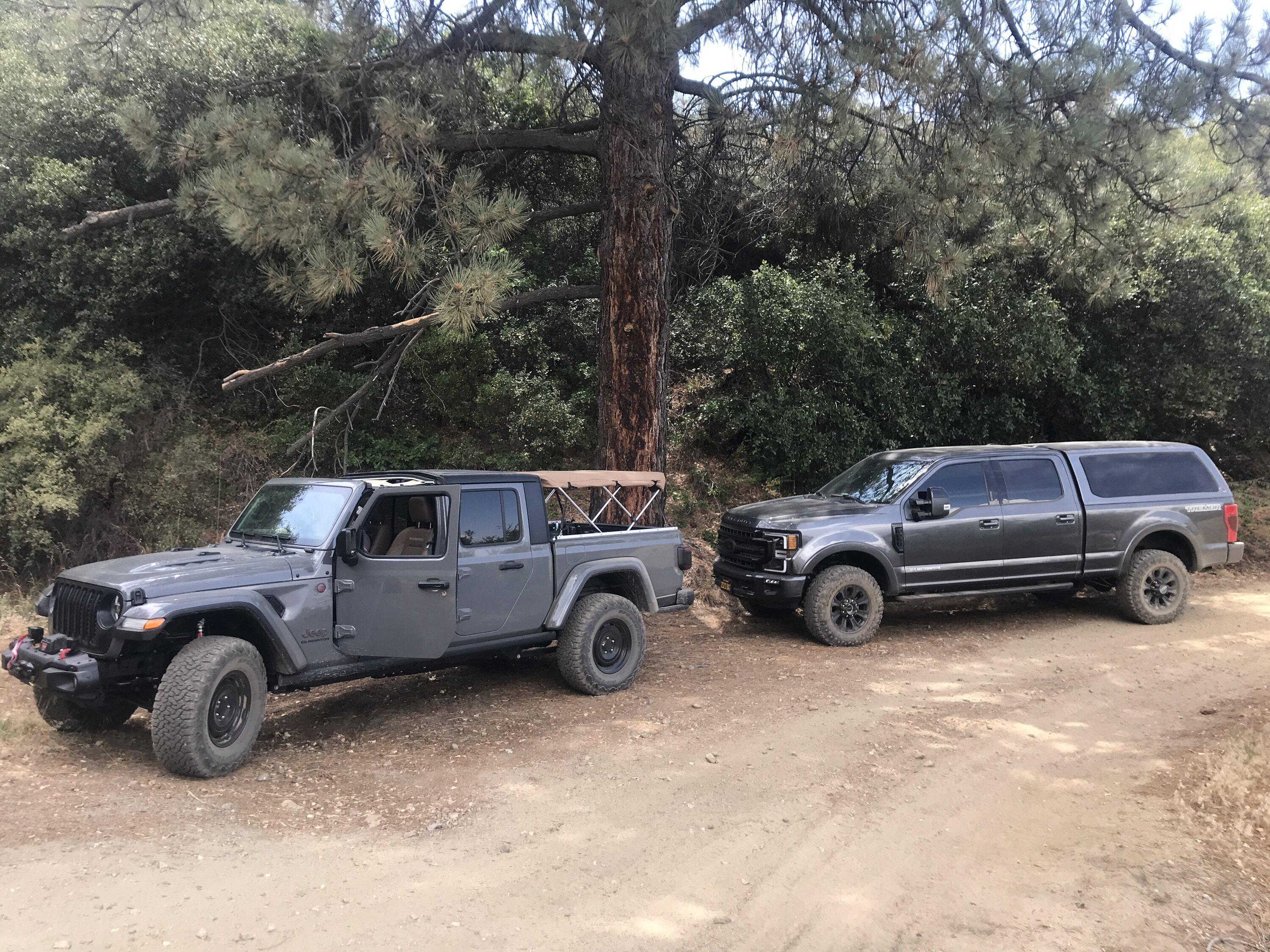

I was out this weekend scouting camp sites on the north side of Palomar Mountain. I was with a buddy with a Tremor F250. Obviously a less, but impressively capable vehicle, I had to slow down because his wife was getting tossed around from the stiffer suspension.
As we started our descent to earth, I finally had a chance to put the Hill Descent feature to the test. Coming down High Point Truck trail is roughly 5 miles of rough downhill. The system worked well. I could control my down hill speed with the manual mode shifter. the only problem was it smelled like I was cooking the brakes. Almost smelled like a clutch burning.

Pics for your viewing pleasure.

I guess just because you can smell them doesn't mean they're at the point of failure. Probably a good indicator to lookout for though lol. I imagine your wheels don't help much with cooling either, they look awesome but that's the tradeoff, I guess.
