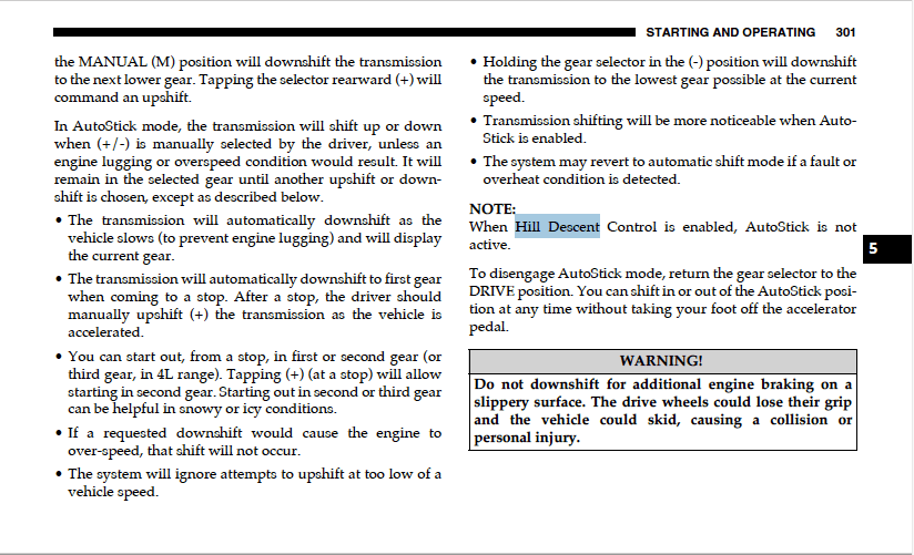

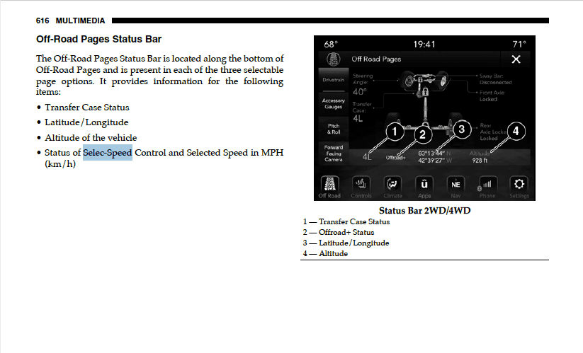

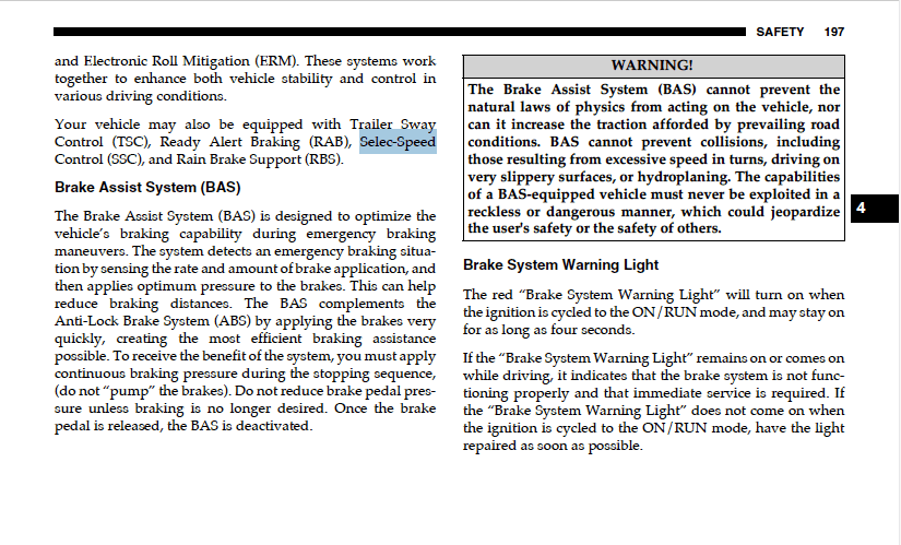

Selec-Speed Control (mentioned 2 times) and Hill Descent (mentioned only once) are almost not addressed at all the Owners Manual. Is there another document or place where our beloved factory/manufacturer addresses them?
Jeep Gladiator Hill Descent Control? Screen Shot 2020-02-24 at 6.22.18 PM
Jeep Gladiator Hill Descent Control? Screen Shot 2020-02-24 at 6.22.31 PM
Jeep Gladiator Hill Descent Control? Screen Shot 2020-02-24 at 6.22.48 PM
