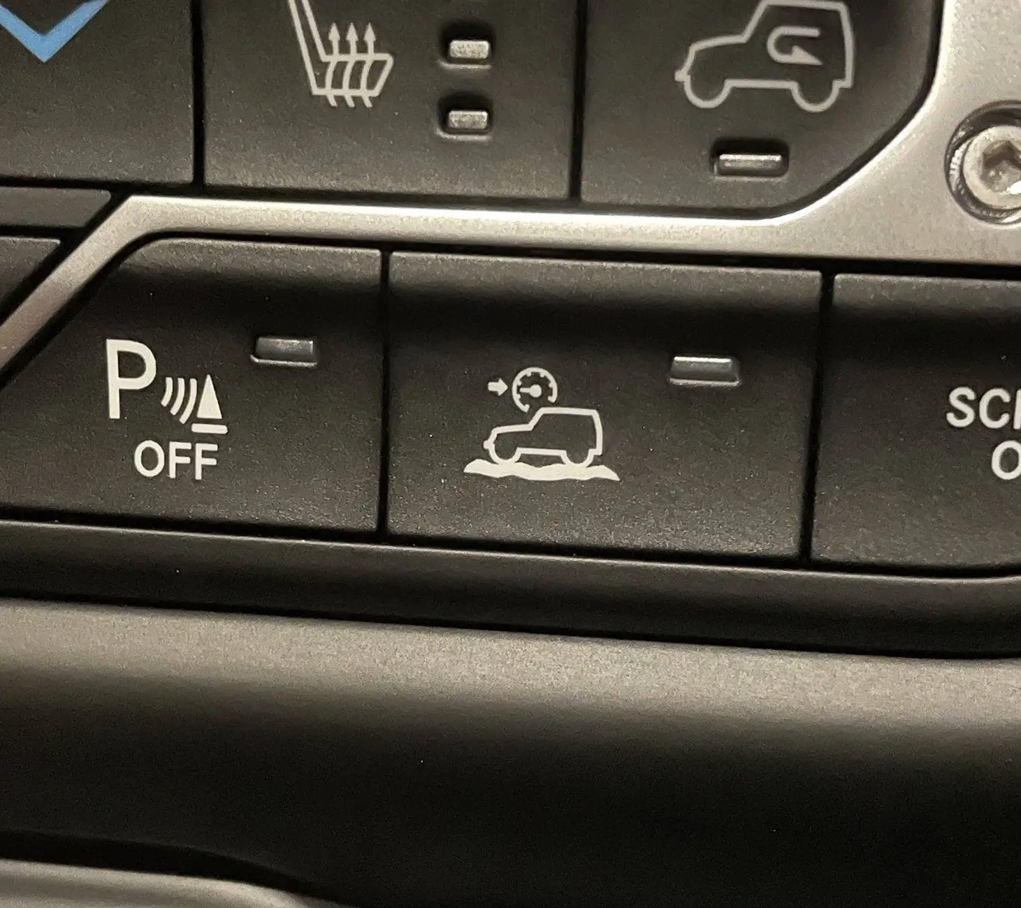

The offraod cruise button? Are you referring to the hill decent button?..
There are two buttons, confusingly, in the same position on the control panel. Some Wranglers and Gladiators had the Hill Descent button; some have the Select Speed (aka off-road cruise control).
Hill descent only works on hills; Select Speed is meant for any situation.
Jeep replaced Hill Descent Control with Select Speed Control for automatic transmission models with the release of the JL Wrangler in 2018. So Hill Descent never existed on the Gladiator.
Okay I will check to see which one I have on my 20 20 sport s. But do both work for the situation being talked about? Going backwards downhill in reverse and for low. Is this a model thing or new generation of gladiator and Wrangler thing?
The Select Speed would work in the situation being described; I was just pointing out that Hill Descent was a different function/button that, in this case, would do the same thing.

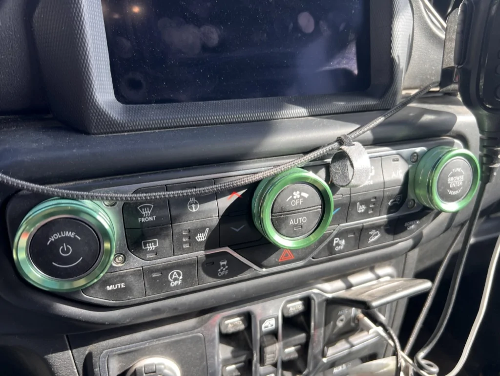

My '19 Wrangler would argue that. Hill descent 100% exists in at least '18 and '19 models. I do not know definitively when it was replaced with Select Speed, but they coexisted.
Interesting, thanks for the correction.
Did a google search and this popped up from the Wrangler forum:
Based on member feedback and window stickers, this is what is currently known about which models get Selec-Speed and which get Hill-Descent..
• 2021 JL Wranglers -
Selec-Speed Control for the 2.0 turbo, the 3.0 diesel, and the 392.
Hill-Descent Control for the 3.6.
• 2018-2020 JL Wranglers -
Hill-Descent Control for all trims and engines.
• 2021 JT Gladiators -
Selec-Speed Control for all trims and engines.
Looks like 2022 is when they all went to Selec-Speed. It's unclear which option the 20 Gladiators had although I read on this forum that the Gladiators never had the older Hill-Decent.
