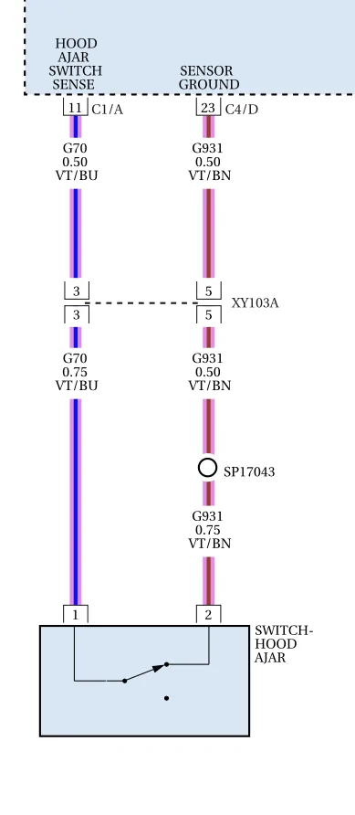

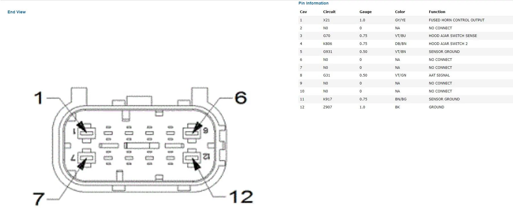

I would concentrate on looking at your XY103A connector. Pin 3, 4 & 5 cover all three circuits you are having an issue with. There might be some green puss corrosion on the contacts or at the crimps of the terminals. Might want to do a tug test of the wires at connector, both sides male and female.
Yep... done that. No corrosion and the pins are well seated in the plugs.

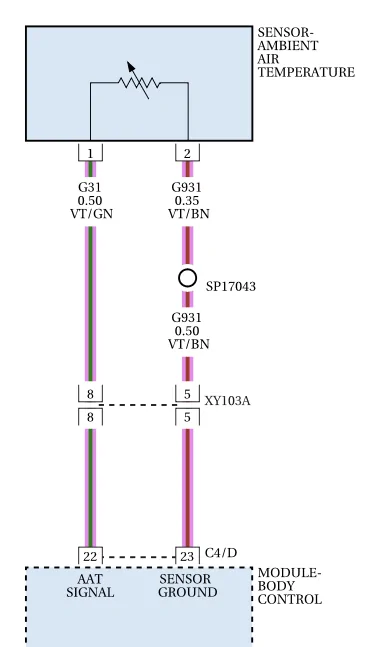

It's because it's those three wires that I've been looking under the dash as well since all three run to the C4/D connector. The Sensor Ground (Pin 5) is shared with the Hood Ajar Switch and the AAT which made it the first thing I tested for.
It would make sense that it's under the hood somewhere. Will keep looking for the not-obvious

I would honestly test from the switch connector side. It should give the same ability to test in terms of seeing a short. Plus, chances are very high that if something's gone wrong with the wiring, it's happened on the engine bay side anyway. I wouldn't imagine you need to go under the dash again unless you have absolutely no other options to test.
I pulled the plugs off the two hood switches and the temperature sensor ... good continuity between those three plugs and the XY103 plug. No sign of a short there. On the off chance it was the temperature sensor itself, Ieft that unplugged but the hood sensors are still throwing errors. Also left the two hood switches disconnected on the off chance one of those was shorting out...
I'm beginning to wonder if the short or broken circuit is actually at the BCP but going to retest from the BCP plugs out to the final plugs at the sensor and two switches tomorrow.

As you suspected the "what" is the "sensor ground" wire. The "why" part still eludes me. From the hood switch side of things I'm seeing 14v (as expected) on the hood switch line but the sensor ground shows open. And I've tested both from the switch plug itself and from the connector to the body harness (XY103) so its not the front harness or a faulty ATT etc...
On our JL, I see 14v and sensor ground does go to ground. And yes, if I bypass the sensor ground and just go directly to ground, the switch works as expected and the truck thinks the hood is closed.
Here's where I run out of ideas. On the off chance I had a nick somewhere or otherwise screwed something up, I reran the ground wire, redid the connections etc.... I don't have a short to ground and I'm not seeing any transient voltages, so I'm pretty confident that the sensor ground wire itself is fine.
From the BCM connector (C4/D) I can see both the hood switch and the ATT. I'm seeing 10ohms on the ATT, exactly the same as I do if I check the sensor directly. Heat it up, and the resistance changes. Same thing with the hood switch.. roughly 500ohms open, 1kohm closed. (there is a resister in parallel to the switch apparently).
I've checked the pins on the BCM, nothing bent... I've checked and reseated the sensor ground pin on the BCM connector.. everything appears tight and in place. Wires aren't stretched oddly or thing that would lead me to believe that just the act of seating the plug makes any difference ....

I am certain that you have looked at the diagrams more closely than I ... so make sure that my assumptions are correct... neither the aat or the switch provide ground to the signal ground wire by design ... if true, then the design is that the bcm provides the ground path ... In that case, I would check the bcm ground pin vs ground ... based off what you are describing, I am guessing that the bcm isn't supplying the ground... and since you have a jl to compare against you could check that too (although I don't know if they are the same/similar enough to be meaningful)... if my guess pans out, I would check for a cold solder on the bcm board to the connector for the ground pin first ... good luck!
That seems to be the case. Definitely isn't tied to the two "input" grounds on the power side of the BCM.
I would check for a cold solder on the bcm board to the connector first ... good luck!
Yeah.. that's probably my last step before I break down and take the truck into the dealer and likely get the BCM replaced, which will lead to all sorts of nonsense with aftermarket parts, upgraded AV/HVAC, power locks, none of which will be in the base codes they are going to program it with.

Glad to help ... only other easy'ish thought if it's the bcm ... a blown (or cold soldered) diode to ground leading to a floating ground

So turns out it was the BCM after all... $700 later, dealer programmed and swapped in the new BCM and all is good in the world again.
