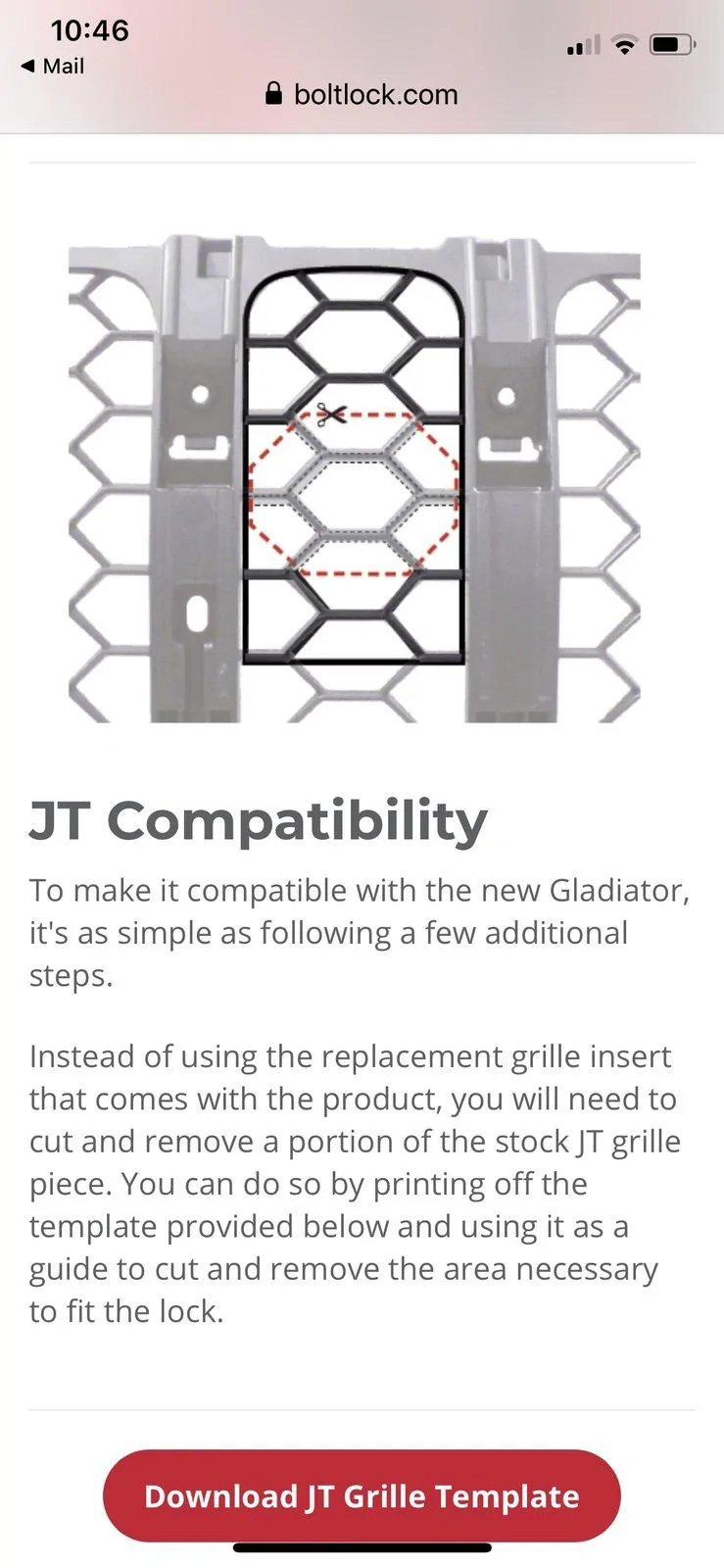

I purchased the jl/jt hood lock kit from bolt lock. It came with the grill with the cut out for the lock. Only problem is that the grill is for a jl. I contacted bolt lock and I’m waiting to hear from them as to how they will resolve this. I did purchase it for the jk and it worked great . Just had to get a large rivet gun for the larger rivets. Parking in nyc overnight I returned to my Jeep countless times to find my side latches undone but my hood still locked and closed.

I saw that Quadratec sold them now but in the question/answer section different people asked if it fit the JT and Qtec said it does not since the grille is different. I wonder if the grille could be modified with a sawzall.

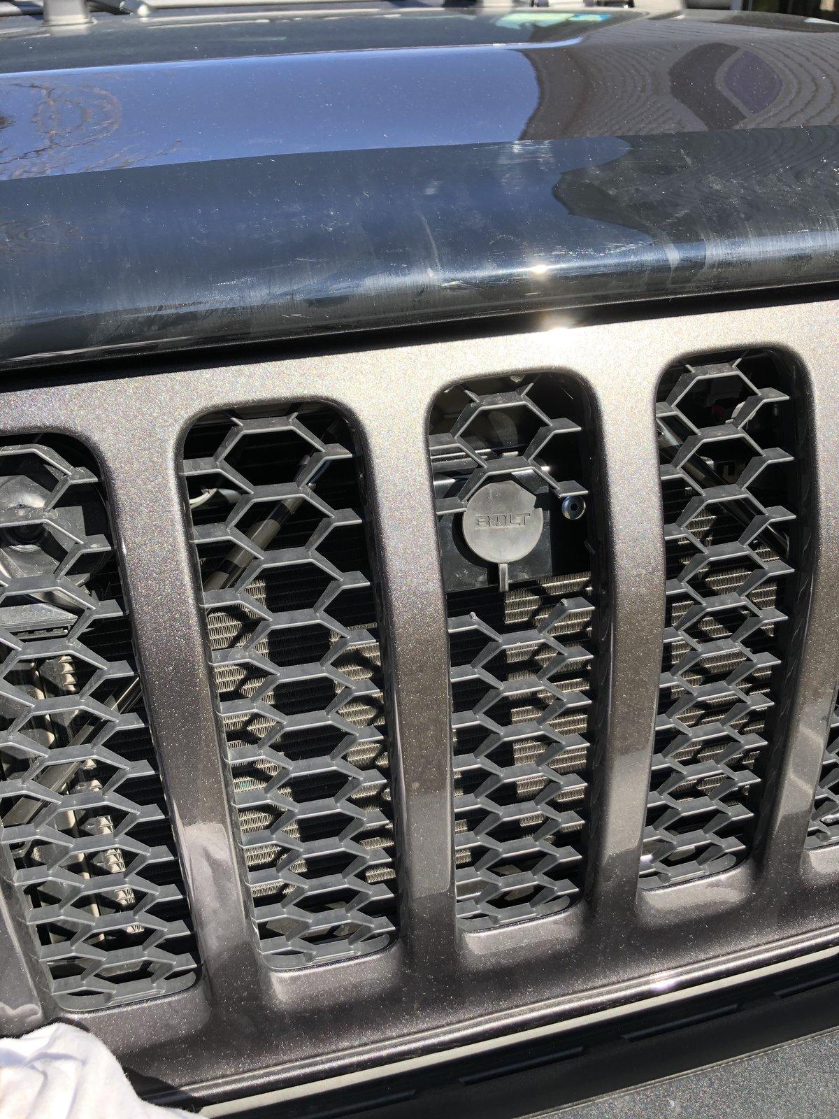

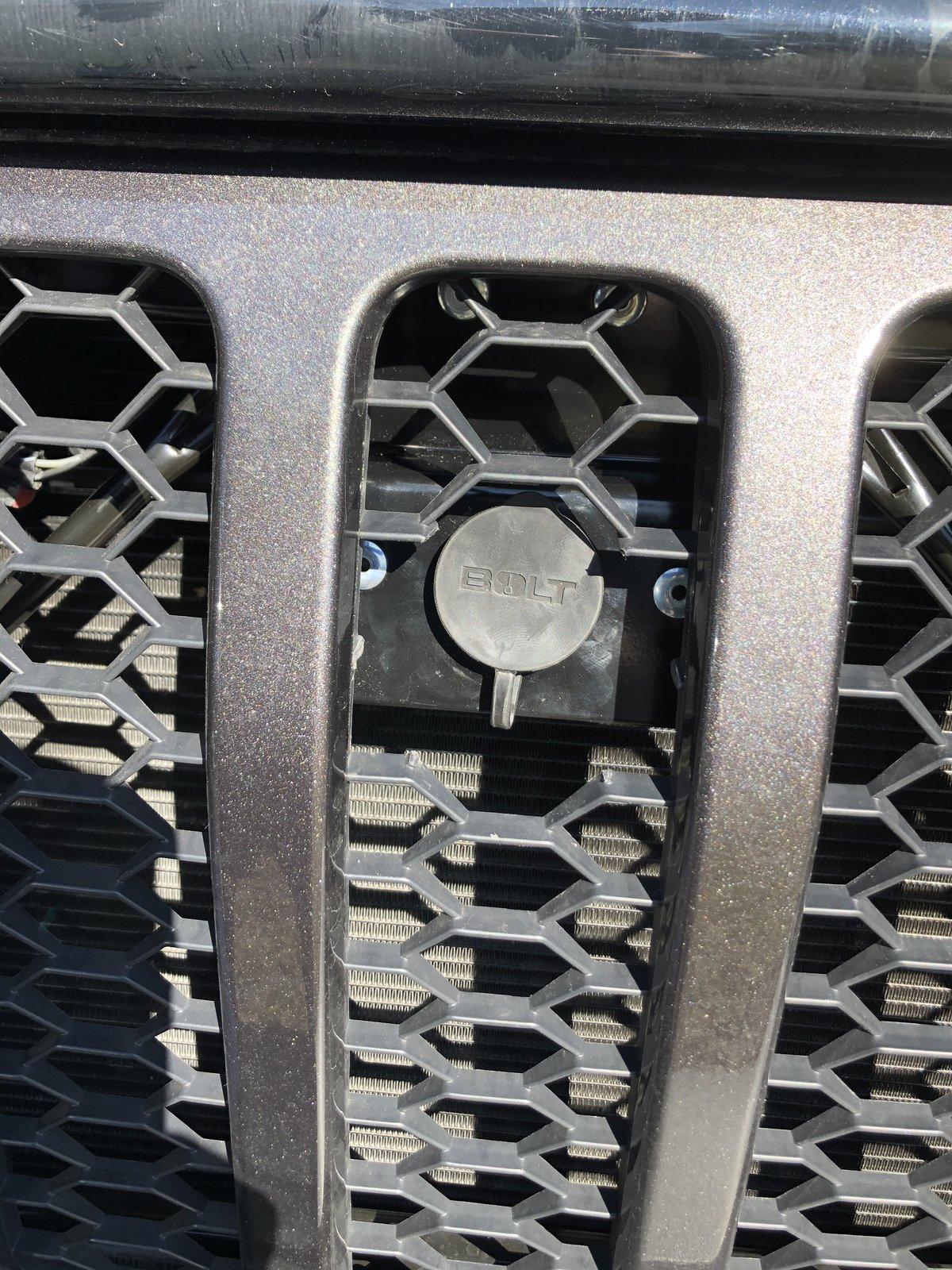

I installed it today . Had to cut the opening for the grill. With the opening , it’s tricky getting the rubber cover off. But I prefer the fuss over replacing the battery or worse.
Jeep Gladiator Hood Locks B9C5DC77-FB66-4E84-970B-044874707647
Jeep Gladiator Hood Locks 026ED718-355B-418F-BE21-70592D0F407E

No sawzalll, a good pair of wire cutters. The grill is rubber.
