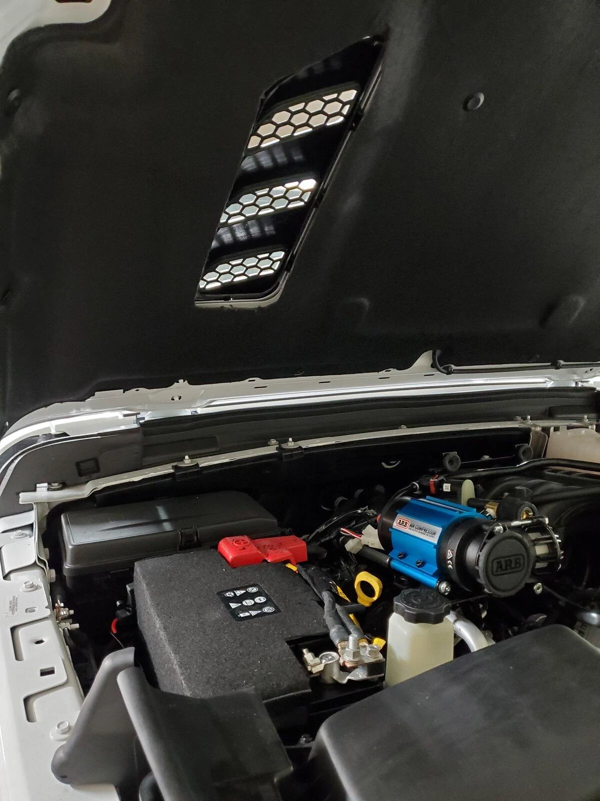

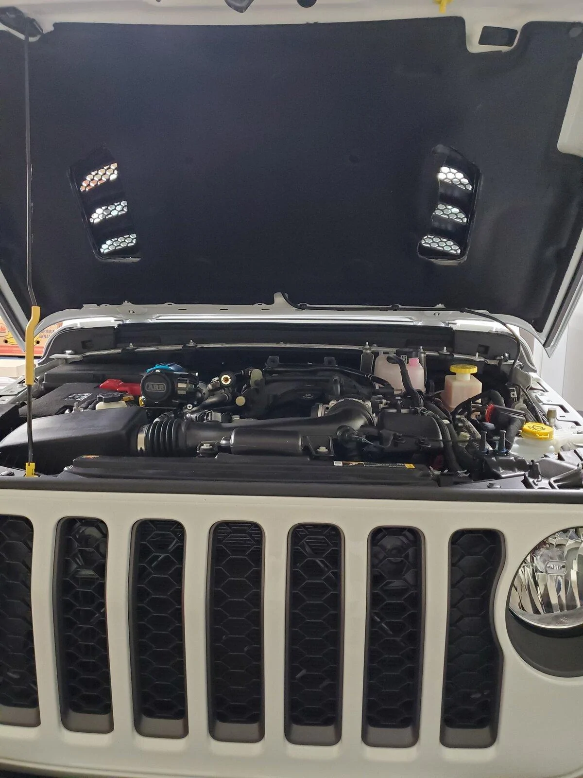

Well, I couldn't help myself. I did it. Wasn't so hard to do. Got new panel fasteners at NAPA and what started out as a test of removing the hood insulating panel turned in to me doing the whole thing. I cut the bottoms out of the vents, cut out the space in the panel and reinstalled everything without issue. I do wish there was a way to finish the edges of the cut panel just to keep it neat. But otherwise it looks fine. I am also hopeful that this might help keep my engine mounted compressor cool.

Much appreciated! Great community here n this forum. Although I prefer the negative-pressure vent style of the stock fake configuration, I like the neatness of this. Keeps the inside shield from looking hacked up. Once this is off backorder, the SB may be my solution.

S & B for reference. Sorry for the two posts. Install was easier to execute than the directions.
