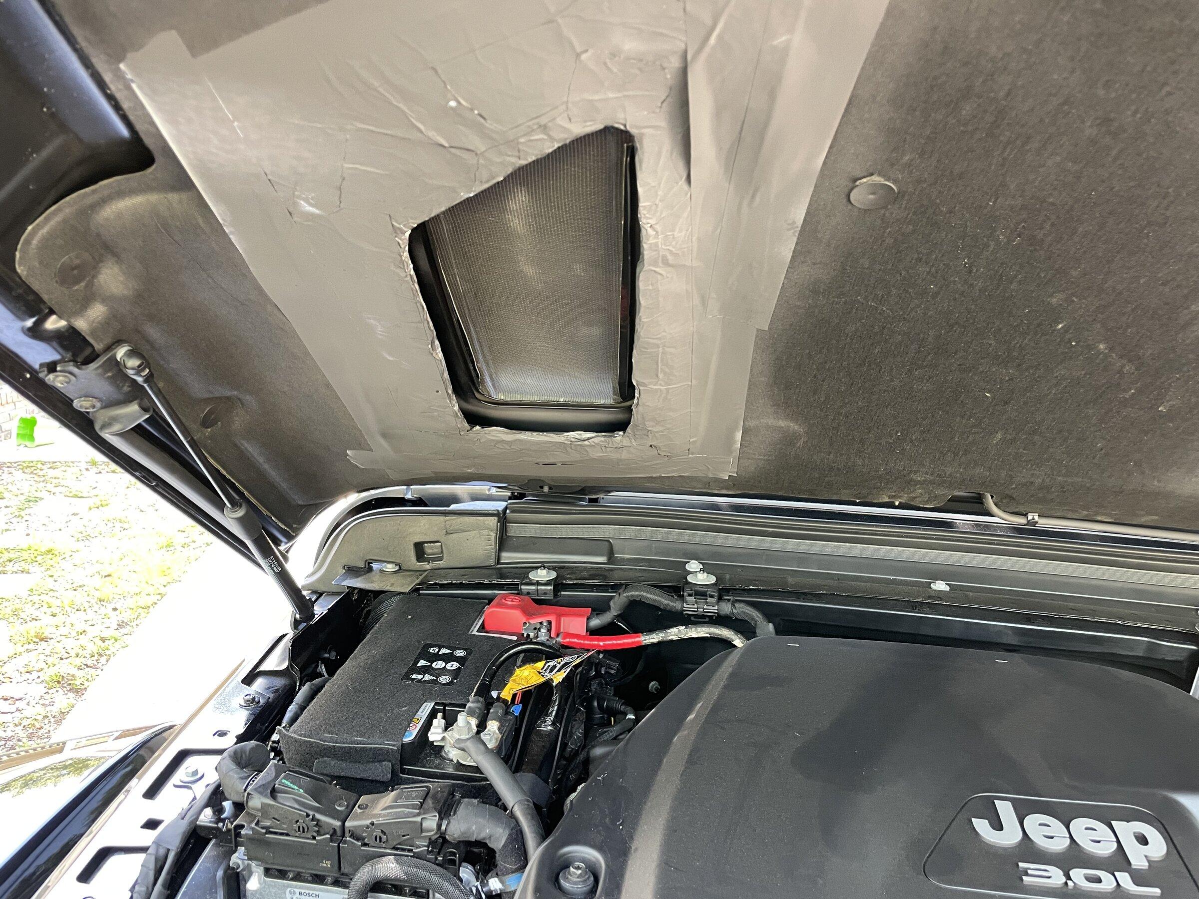

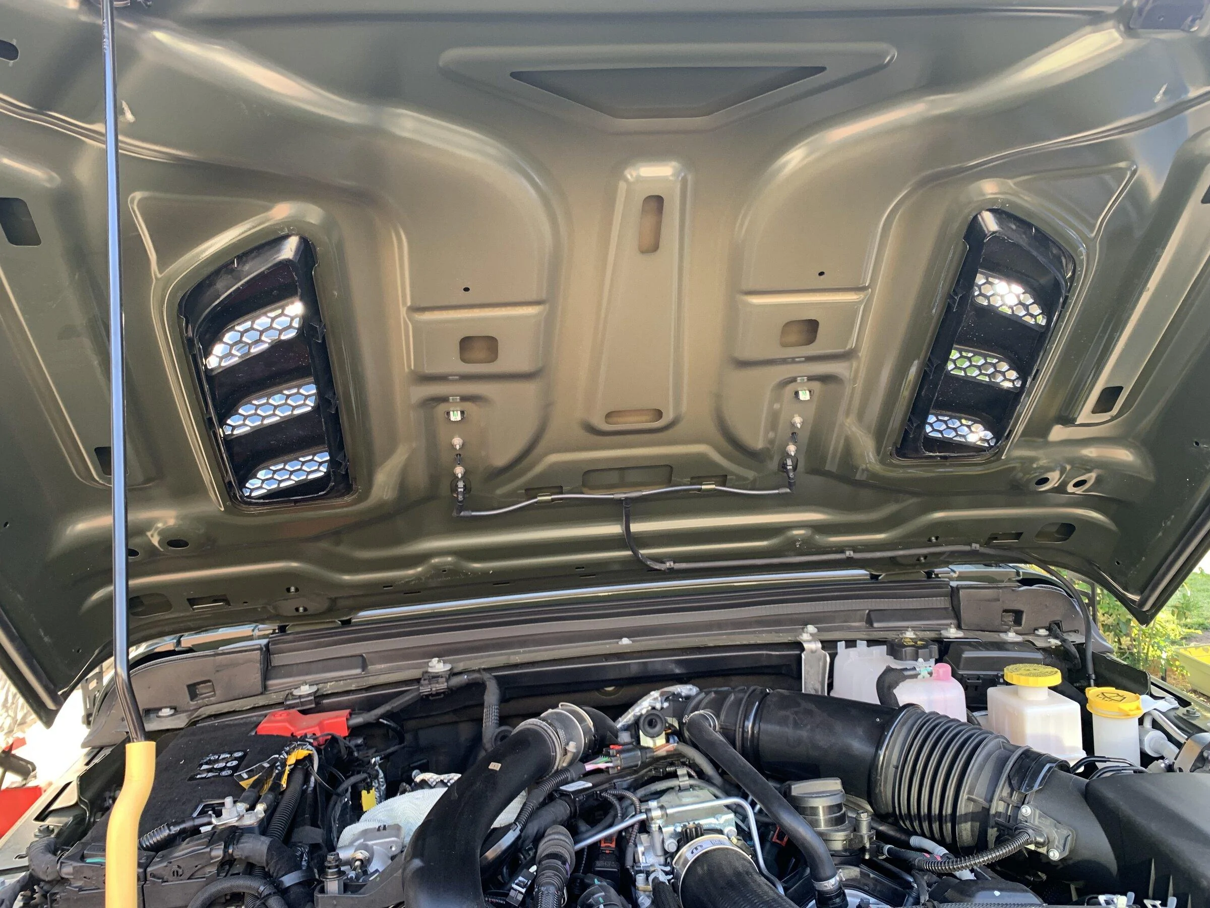

Is the plastic vent 2 pieces and you were able to remove the bottom piece to open up the vent, or is it just one piece and you had to dermal the bottom out? In other words - is removal permanent or can you reassemble the vent if it turns out to be a problem? ( I can see the mod to the heat shield is permanent).
P2VNeptune
Mar 1, 2020
Missoula Mt
20 JT, 67 M715
I had to dremmel the bottom out. its permanent the heat shield was just cut with a razor blade

5000 miles now through rain and heat (90's) with open vents - no over-heating, no water noticed. Looking good - looking forward to 100+ ambient temperature to watch temp.

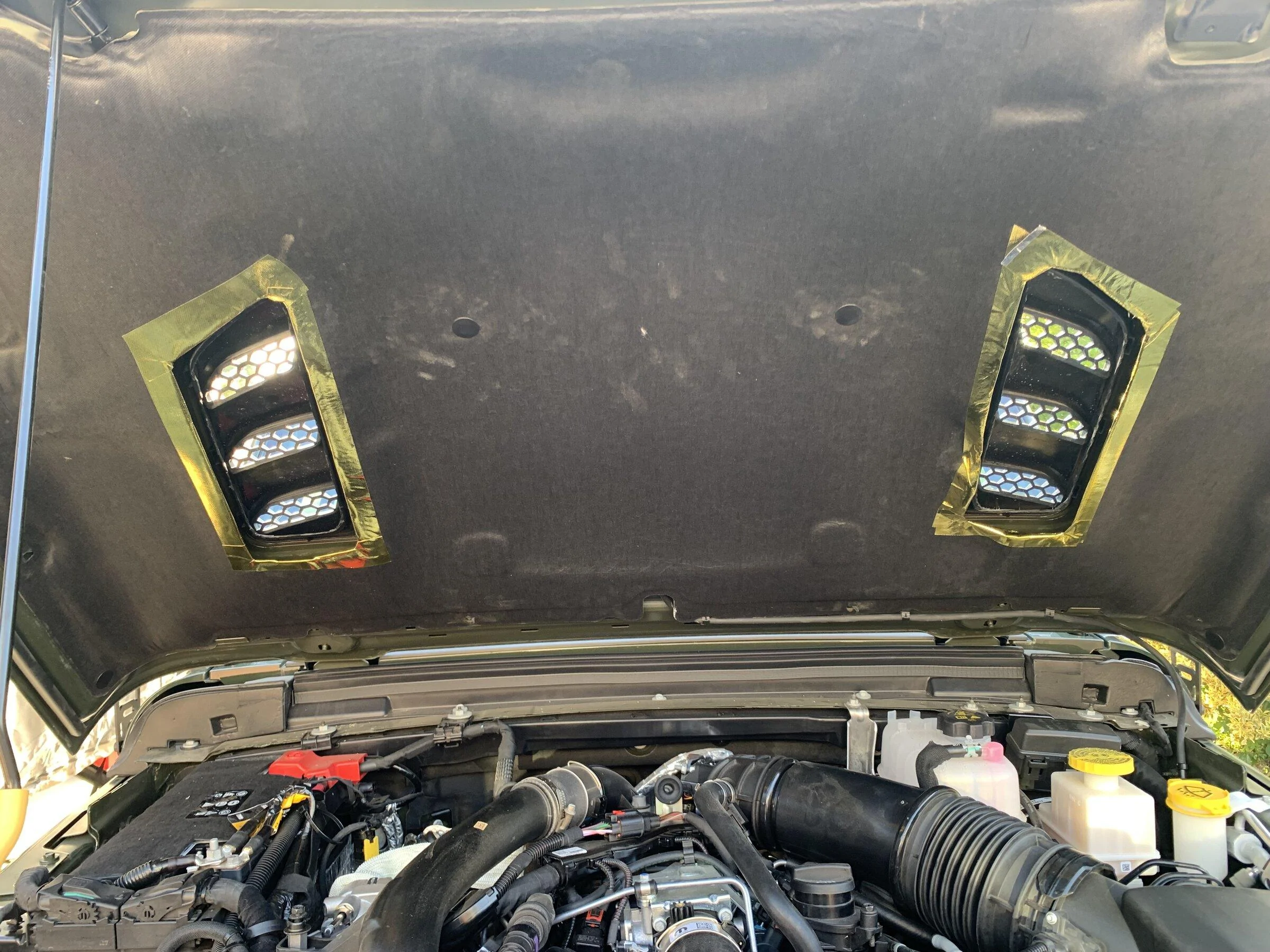

Just did mine had a local holster shop (Burlyman tactical Kingsland Ga) make kydex covers sandwiched screening in to keeps bugs etc out

I did mine about a month ago. Haven't noticed too much of a difference in highway driving.

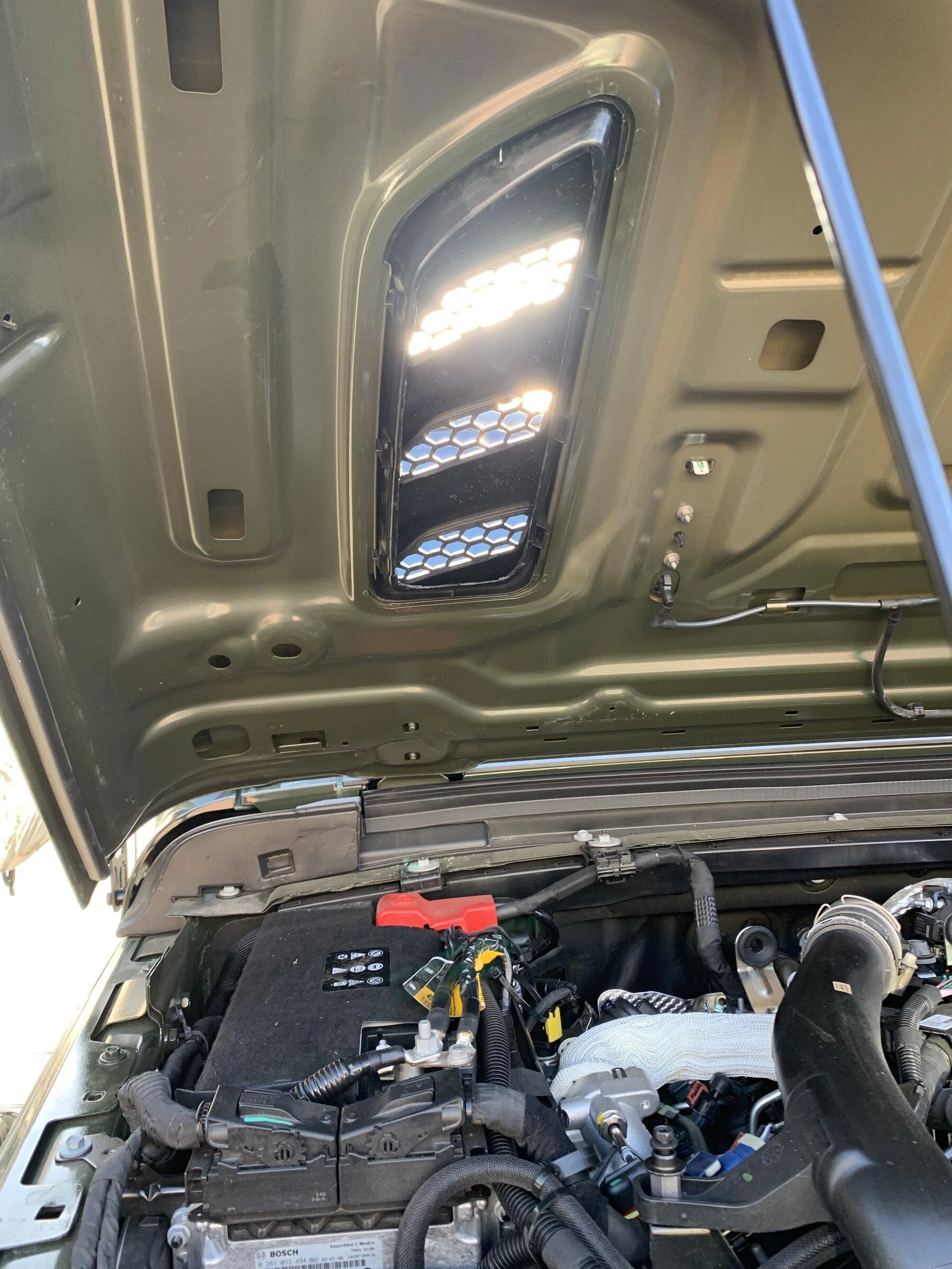

Did mine recently too. Didnt notice any reduction, but no increase either. Its on a diesel. As noted this is easy and fast mod. I broke about 1/2 the liner clips so better get some before you start!
Those are pretty slick!
