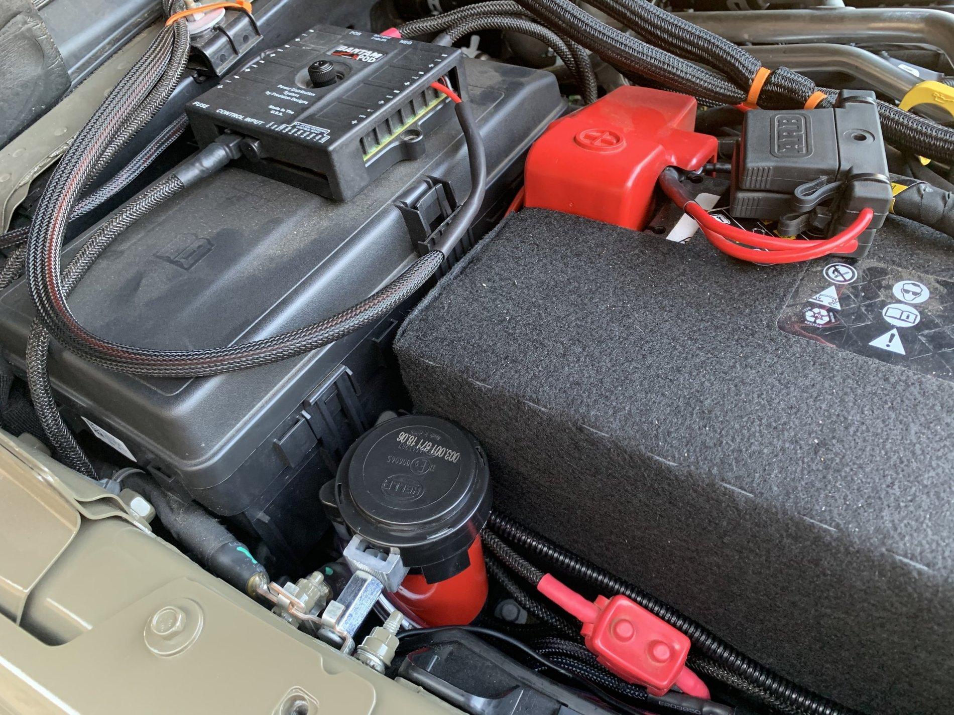

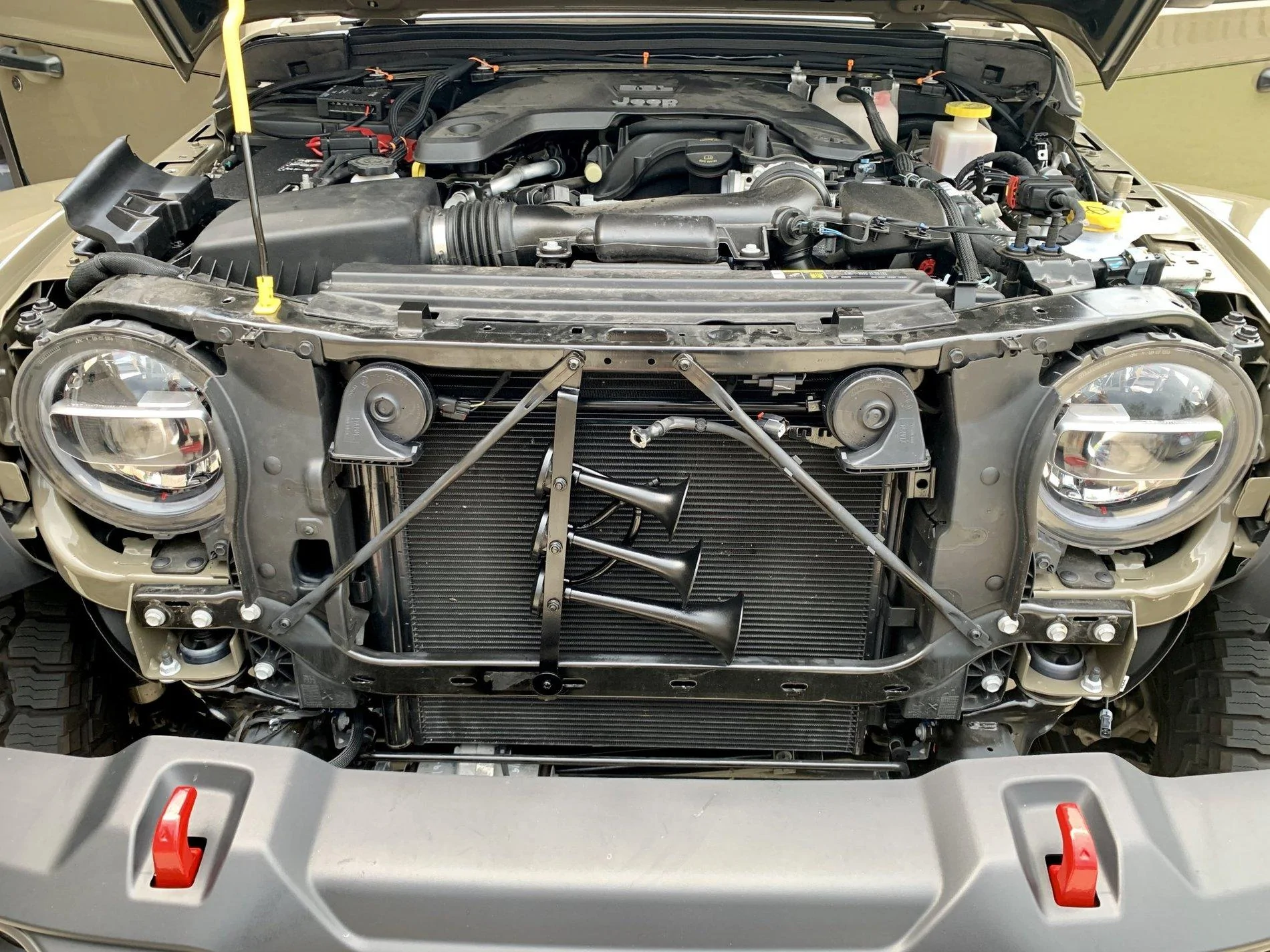

So I added some Hella goodness. 5 horns total now should do the trick.
Jeep Gladiator Horn Upgrade 3979FAFB-A0F5-46A7-BE86-3A077F086313
Hella air horn compressor mounting. Used an existing OEM M8 1.25 thread stud there at the fender and added a coupler - voila!

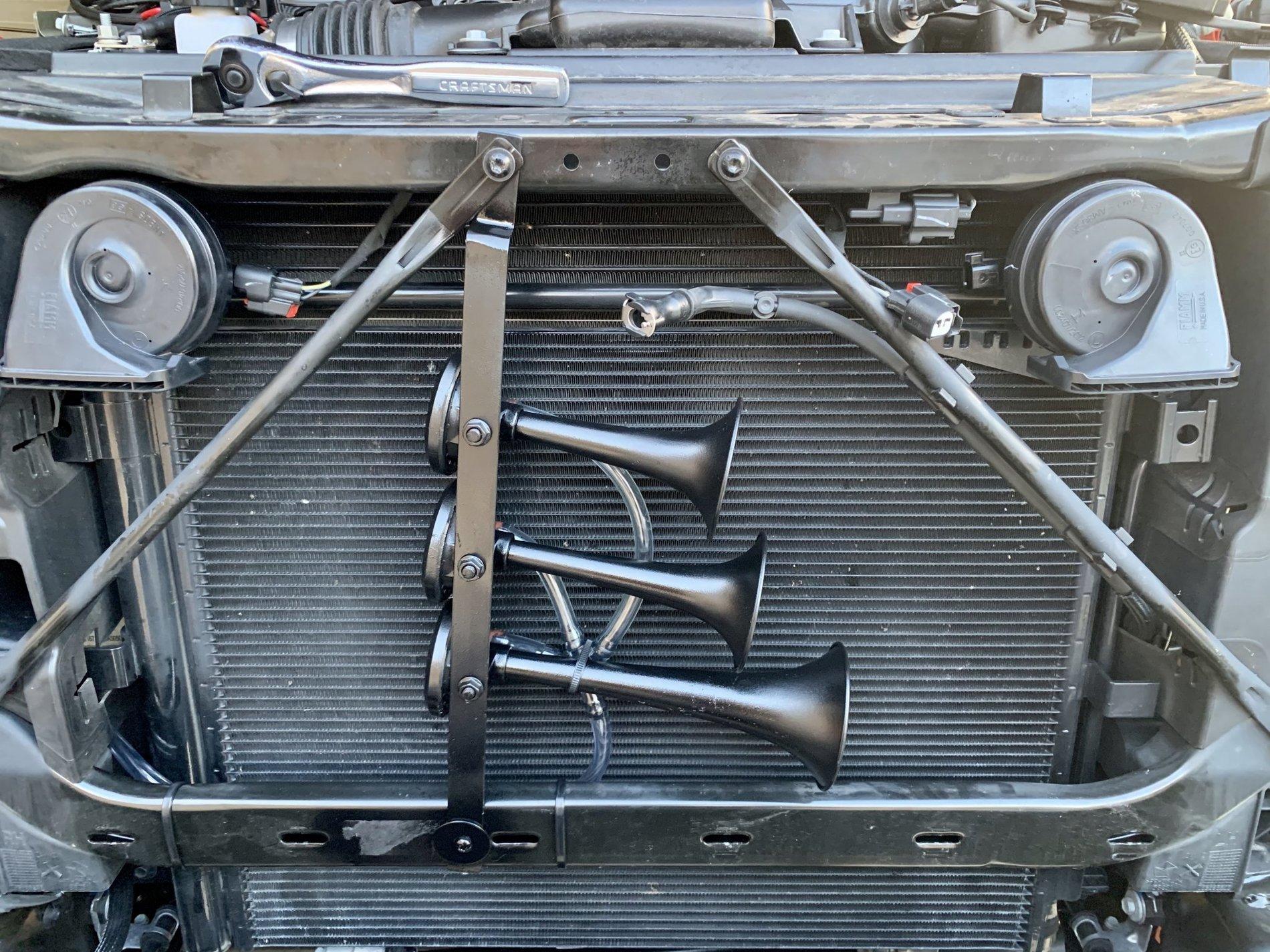

Here’s a better shot of the bracket and the revised air hose routing for anyone trying to do this mod on a JL or JT. The horns are red, you'll need to paint them to hide them behind the grill.
Jeep Gladiator Horn Upgrade horns

What's the temp rating on that tubing? It's awfully close to the radiator
We're going to find out!
Fortunately, it's in front where it gets max airflow and does not rest on any radiator components (there's a good 2-3 inches of distance/airspace there between the tubing and the radiator) so there is zero chance of heat transfer via conduction. It should be just fine.
