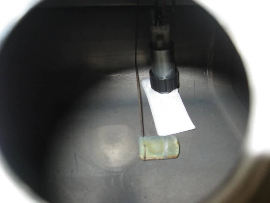

Your pump will not over heat, will work just fine for many miles. I’m at 98k and push mine to the bottom of the gauge every time. It will typically go to ‘ Low fuel’ for 25-35 miles before I get any sputter. ( I have an extra fuel tank where the spare tire was ) and the most I ever got in the main tank was 21.8 gallons
There's a lot of fear-mongering and "what people have heard" and so on.
I don't suggest people risk running out of fuel, but to believe the pump will fail or be sucking air and get hot at 1/8 tank or so, naw.
It's amazing the systems the engineers have put into place for fuel system protections anyway. Some even have a small tank within a tank in which a pump sits, others which have a return system have that return go into a reservoir in which the pump sits and so on.
Jeep fuel pump in my car's tank, no baffles at all. 13+ years, same pump.
