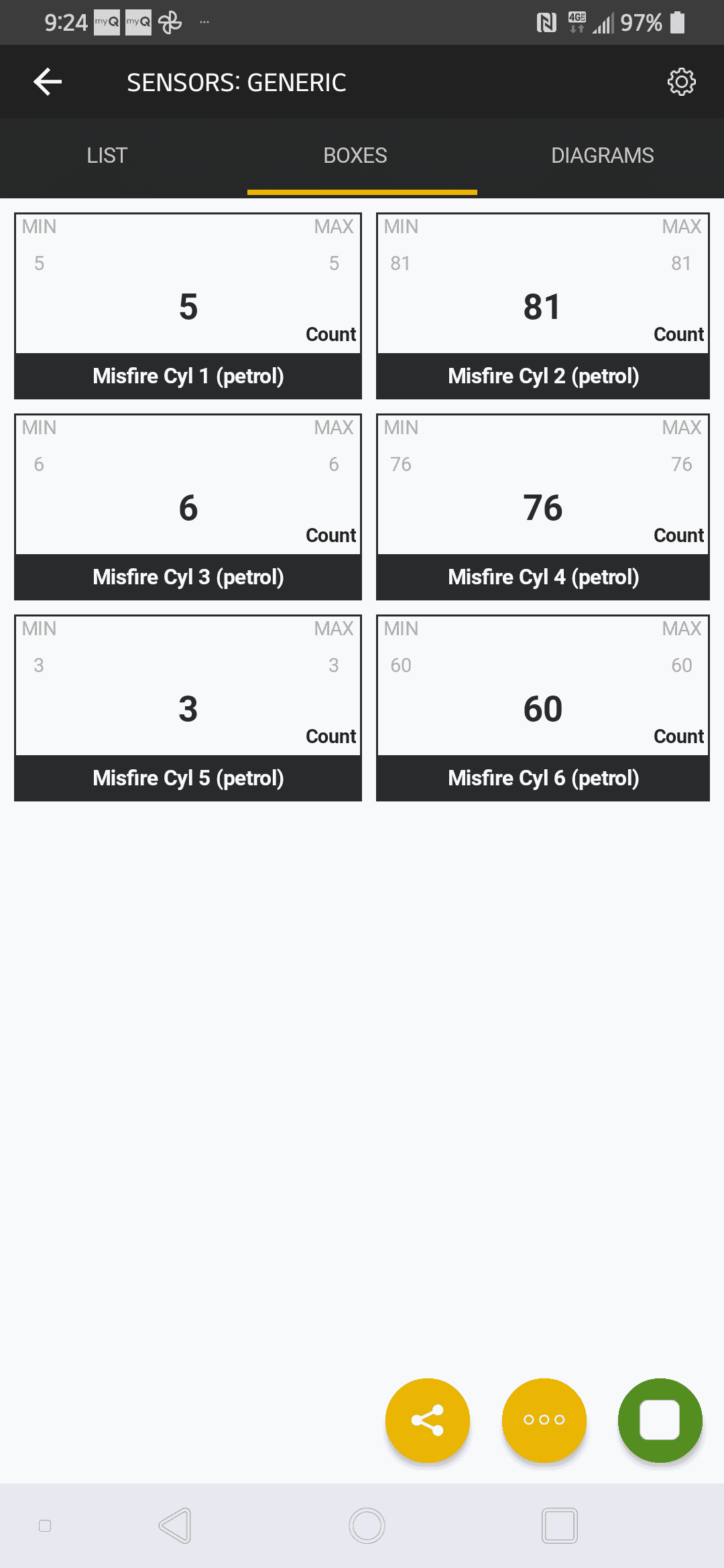

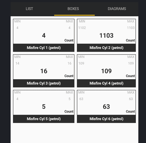

I have both AlfaOBD and JSCAN. JSCAN is a bit easier, IMO, and allows nice screens for troubleshooting (you can show misfires on all cylinders in a grid, among many other things.

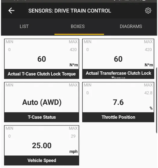

Want to watch your SelecTrac transfer case (or RockTrac full time automatic transfer case) - in action?

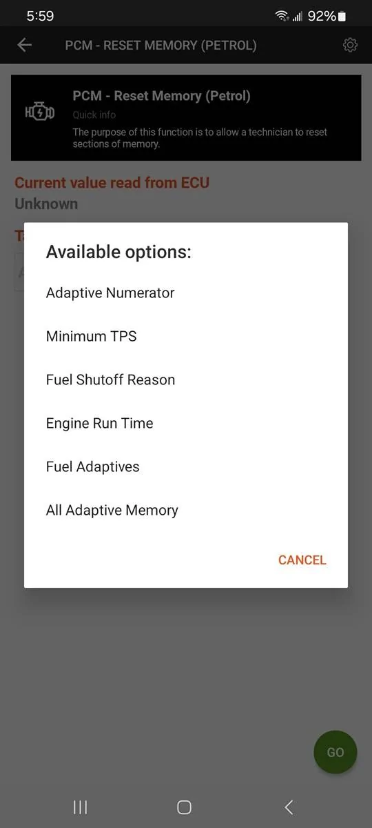

I would suggest a "All Adaptive Memory" reset. That way the adaptive memory can re-baseline with your new settings.
Thanks for that. Can you go into detail about what this really does? (Sorry, totally noobish with all this).
PCM over time learns your driving style and adapts the shift points. Changing the tire size without resetting the memory may have skewed that.
Going to 33's on a Sport with 3.73 gears is on the upper margins of the shift points. I had to do the same reset when I put 285/70/17's on my 2021 Willys with 3.73 gears. Once I did that and the tire size correction, it saw 8th gear a lot more.
Okay, thanks for the tip. Will try this! Darn, and I put the panels back and thought I didn't have to get back to those two cables underneath the steering wheel!

Did you end up using the "All Adaptive Memory" reset in JSCAN? Or did it adapt on its own after you changed the tire size?

Did you end up resetting the all adaptive memory in Jacan? Did ya lose 8th gear?
I did not. I saw 8th less often, but I figured that was to be expected given the (slightly) taller tires. They're also wider & softer. More aerodynamic drag and more rolling resistance. I aired them up to 37-38 lbs, but on a couple of real cold mornings (and "real cold" here in SC is 30* or so LOL) the pressures would drop to 32-33 lbs or so... and I could feel the extra drag... noticed that I saw 8th even less. When the tires heat up and pressures are where they should be, I see 8th more. Generally I'll see 8th on flat ground up to about 70-75 MPH (if I'm remembering correctly). Anything above that, it drops to 7th due to the wind resistance.
It's been over a year, so I assume the adaptive shifting has... adapted by now. I wonder if I'd have anything to gain be resetting it at this point?
