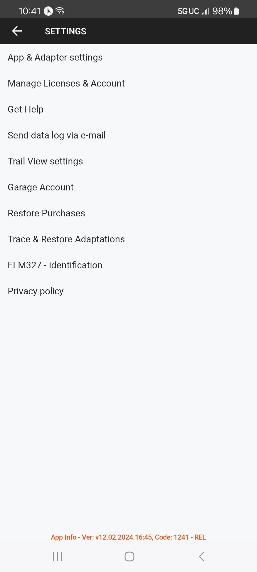

Is that a factory reset in JScan?
Not necessary a factory reset, no. JScan allows you to go back to factory settings in case you made a change you didn't want. Or to put everything back to factory if you are selling it.
How do you do that? I didn't see that in the settings.

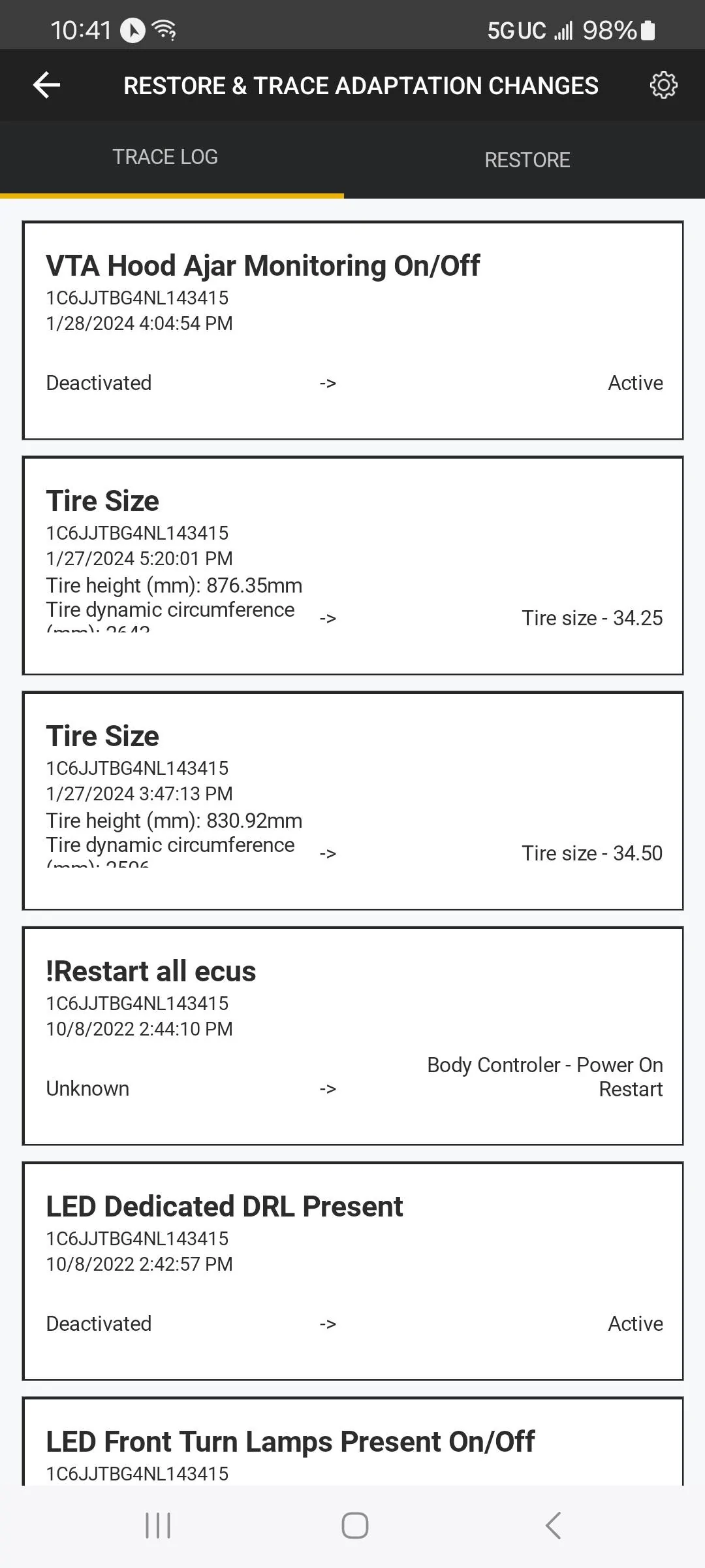

Go to JScan settings > Trace & Restore Adaptations to either check the history of changes or revert all settings to factory.

Most, if not all, Adaptation pages have on the top of page "restart all ECU's". This puts it all back to before you made a change.
Are you sure. I think that is just to reboot the ECU.
