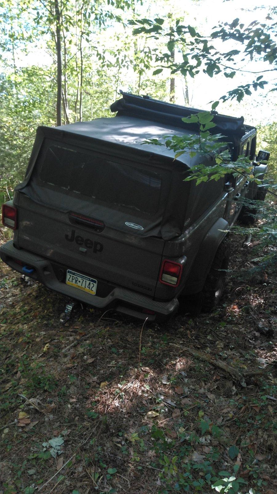

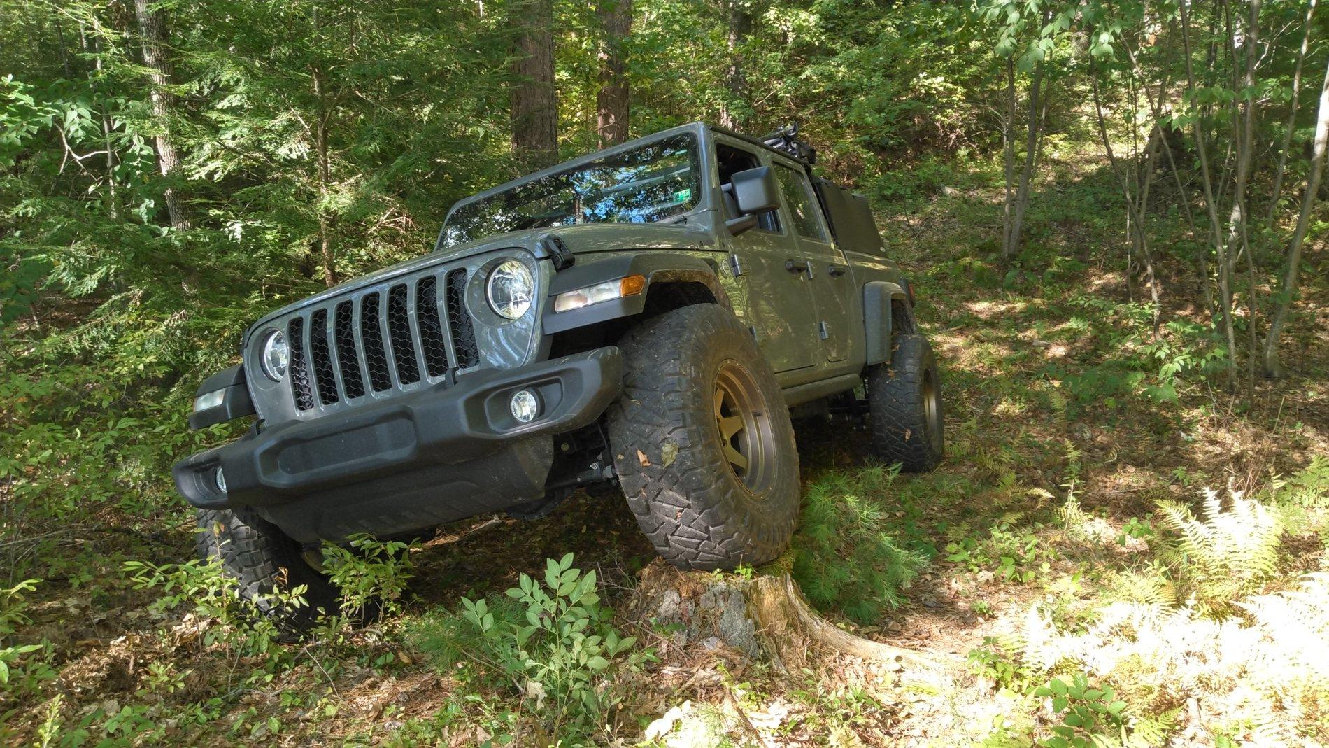

So I can't speak for disconnecting the sway bars, but I have wheeled my Sport with 35's and have only slightly rubbed the plastic inner fender once. I've had it fully flexed and the tires surprisingly fit nicely into the wheel wells. I'm running 17x10" Fuel Shok's w/ 35" x 12.5" Nitto's. Again, this was with sway bars connected, so I imagine there'd be more clearance issues if they were not connected.

What kind of lift do you have to accommodate that?

No lift. Sport with Max Tow.
Interesting... That’s what I’ve got and I’m looking to add a Rubi suspension and levelers this weekend. I’ll only have 33s on it for now, but want to ensure I’ve got head room if I want to upgrade in the future.

I know the wider Max Tow 44's help, along with the wheels having 4.5" of backspacing. Either way, I'm happy with it. I only "play" with the JT once in a while as I bought it as a tow rig. I am saving the crazy stuff for my YJ.
