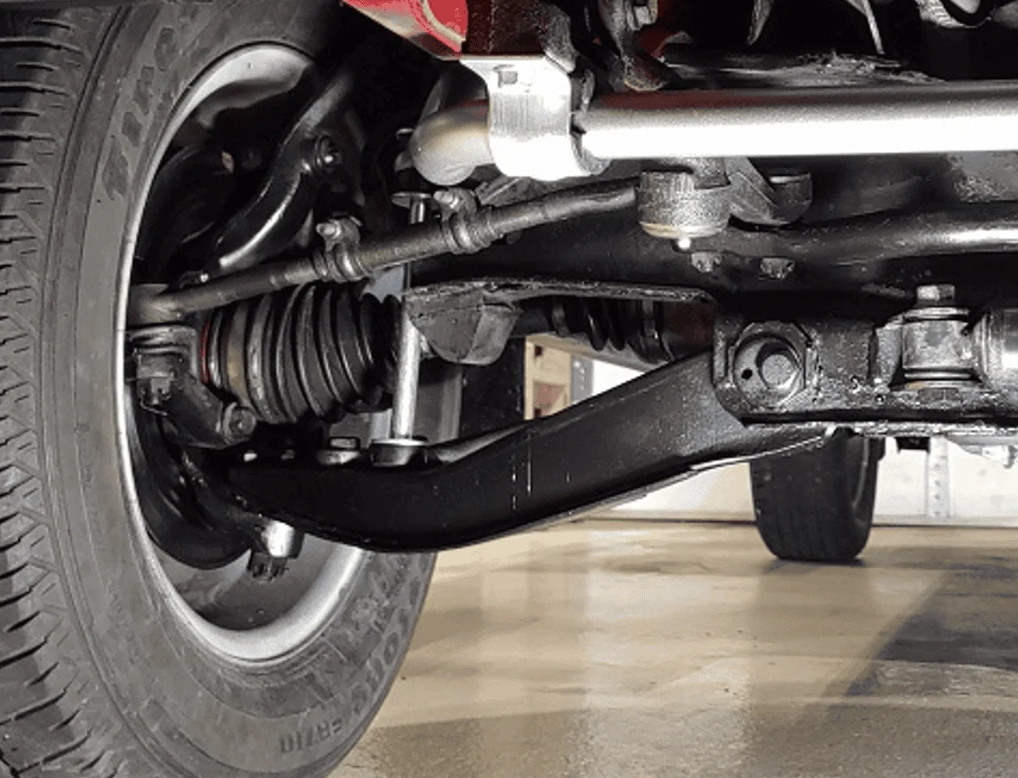

Look at how the steering linkage of IFS is arranged - the inner tie rod for each end pivots in a place almost on the same axis as the lower control arm pivots -
Look at where the steering linkage pivots compared to the lower control arm. The length of the tie rod nearly matches the length of the lower arm, and the angle off horizontal is nearly the same. Almost a perfect parallelogram. As that wheel moves up and down on rough roads, the steering is hardly impacted.
That's the real difference. On a decent road, it won't matter - the Gladiator should steer or handle nearly the same. And it will be worse with one side than the other.
