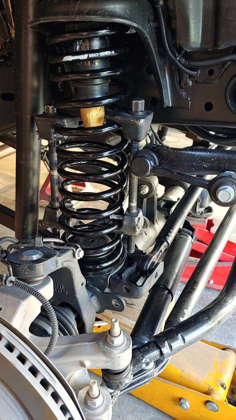

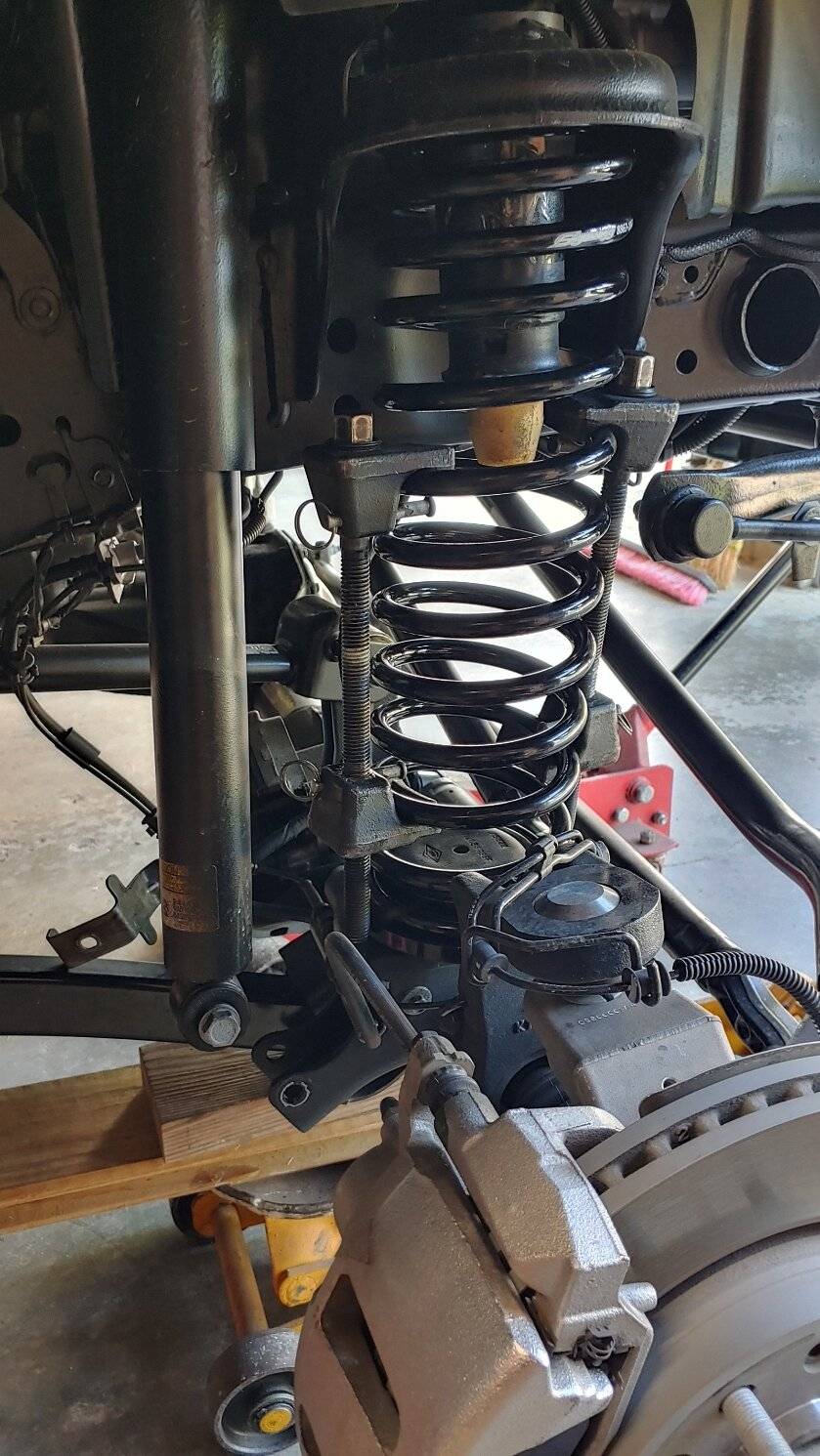

as far as "others doing it without compressors" - I ran into the maximums on my wheel sensor and brake caliper lines and didn't want to take more parts loose.
I used 3 floor jacks in the whole process and found the taller springs with spacers in my 2020 were taking it to the limit - I could have worked a lot harder and made it, or removed more parts, but the compressor allowed me to leave brakes and wiring alone and simply slip stuff in.
To each their own - you can put 5" springs in without a compressor if you remove enough parts and work hard enough at it.
I was also in a really tight time crunch. I look back at the photo date and time stamps and I had exactly a couple of hours to do the job and get loaded up to go on a trip hauling my car hauler. I couldn't spend a whole afternoon. So I needed to know how fast it could be done.
If I were doing it now, I'd not care if I had to take hours and take a lot more stuff apart.
I was hooking up to leave - on a really tight schedule. I figure the compressor saved me a lot of time not to mention I could leave some stuff connected and actually work less hard.

When this thread was revived a few days ago I didn’t realize it was from 2022.
Having installed a 2” spacer lift this past weekend I can say that a spring compressor is one of your best friends.
I didn’t borrow one so I rigged a ratchet strap to squeeze them down to get them back in. It worked.
