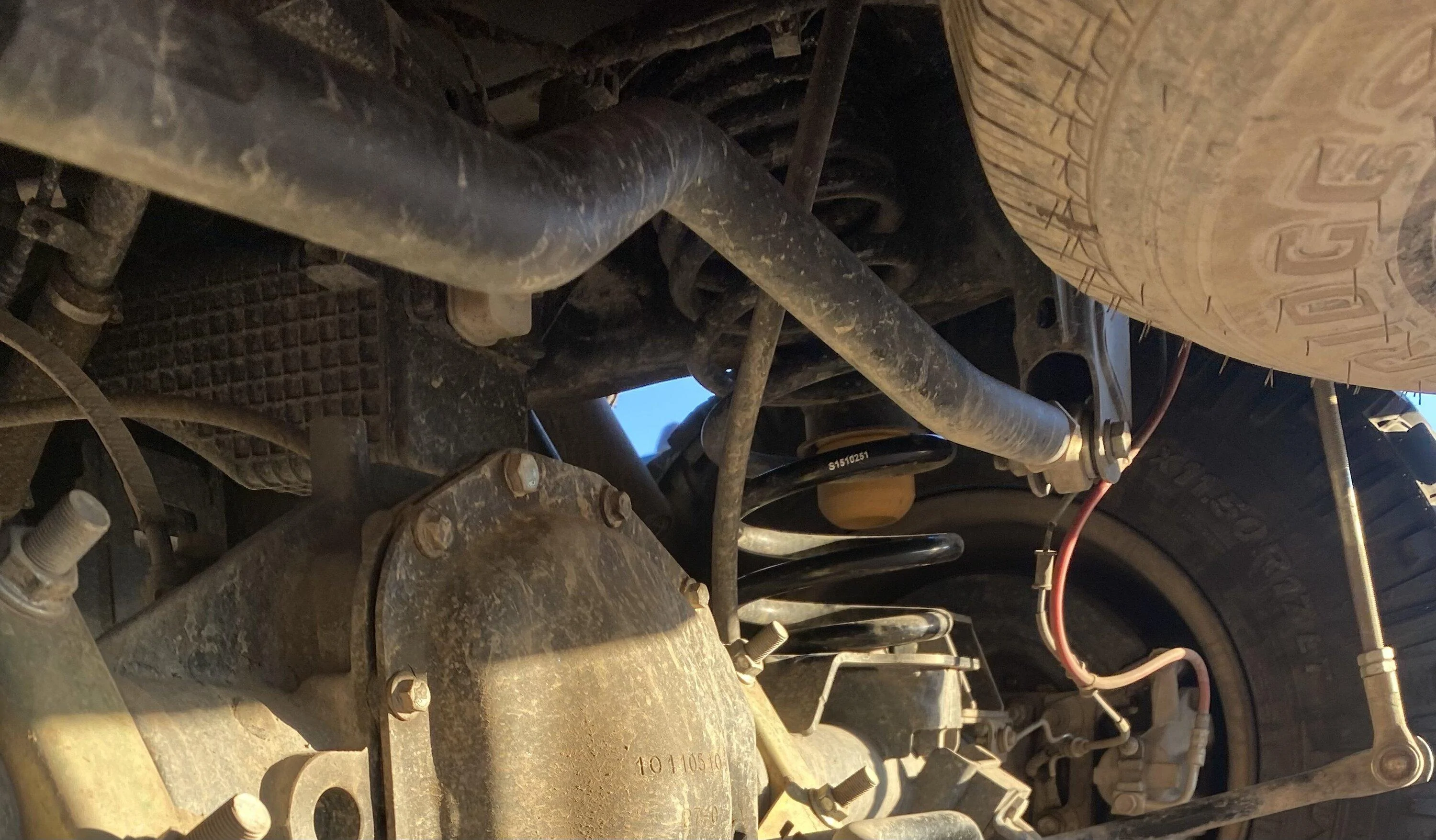

This all day. The isolator and angled and if you do not index correctly, your springs will bow like this photo and make an awful racket.
