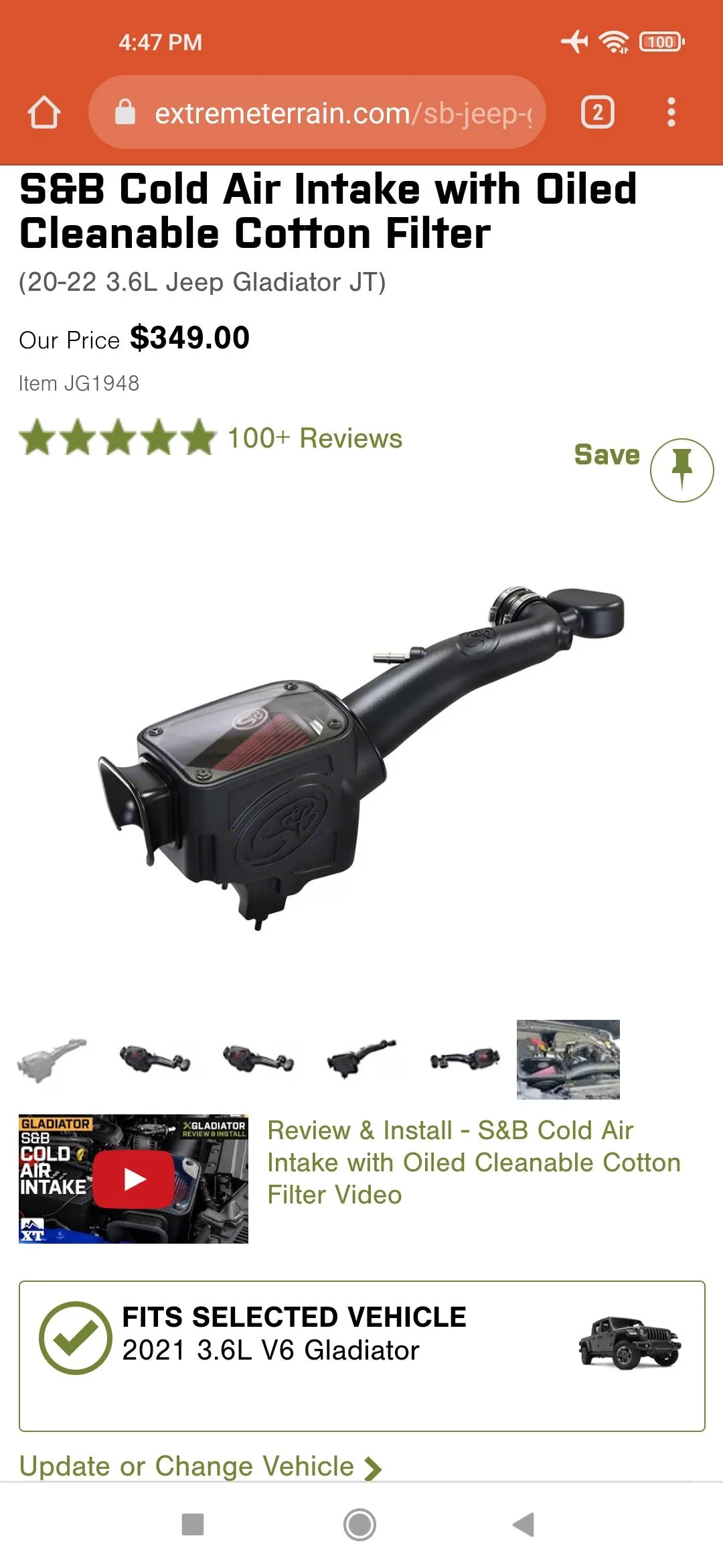

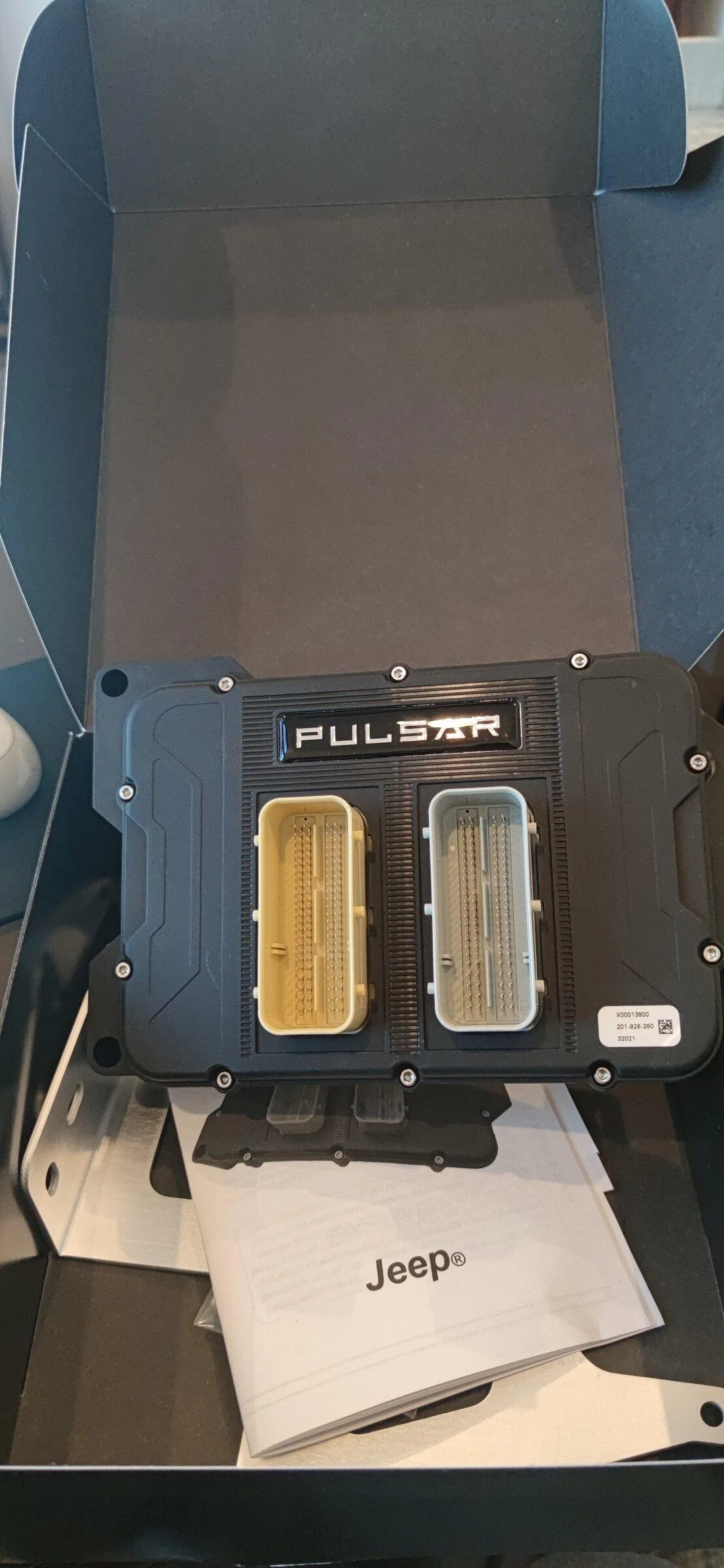

Ok. Just got the Pulsar and S&B cold air intake. Will install it tonight and provide update over the next week on improvement achieved with the combination of these 2.
21 Mojave with 35" is all i have on it for now. No lift or extra weight

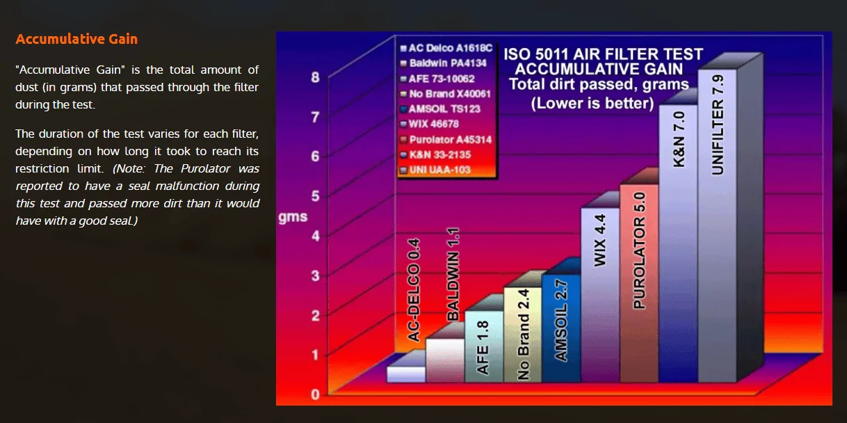

First thing I'd do is put a good filter in there that doesn't let dirt through..........

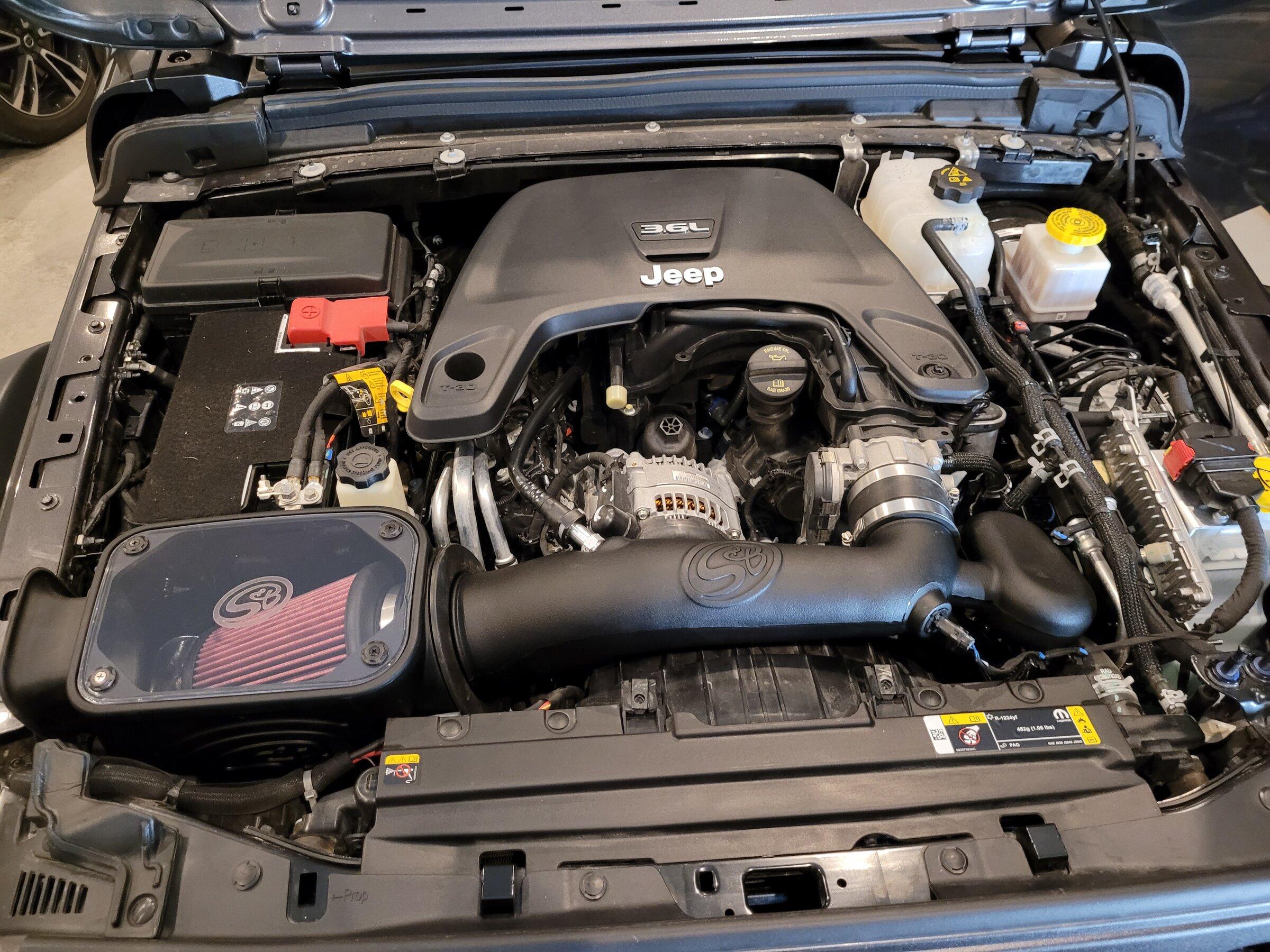

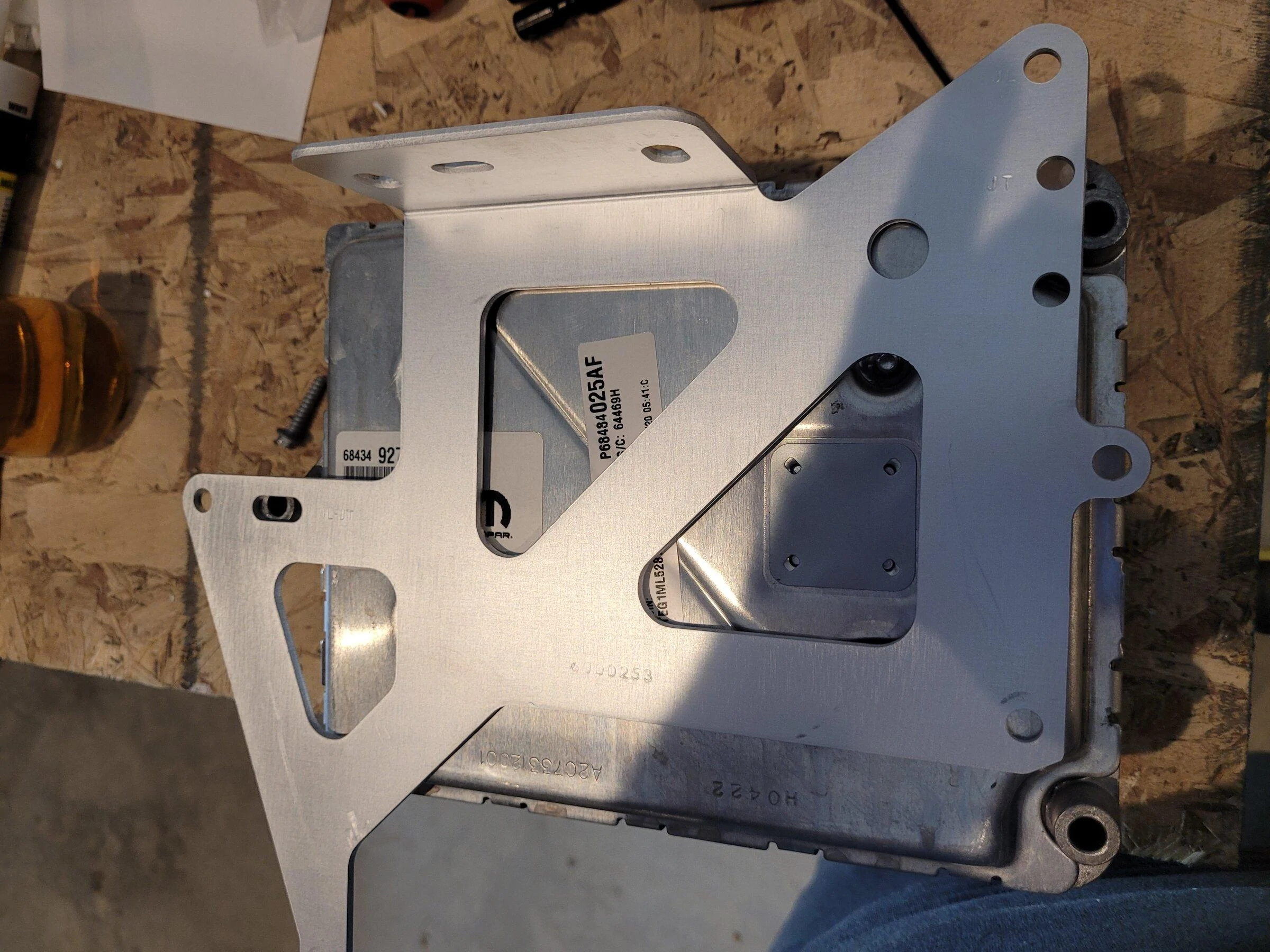

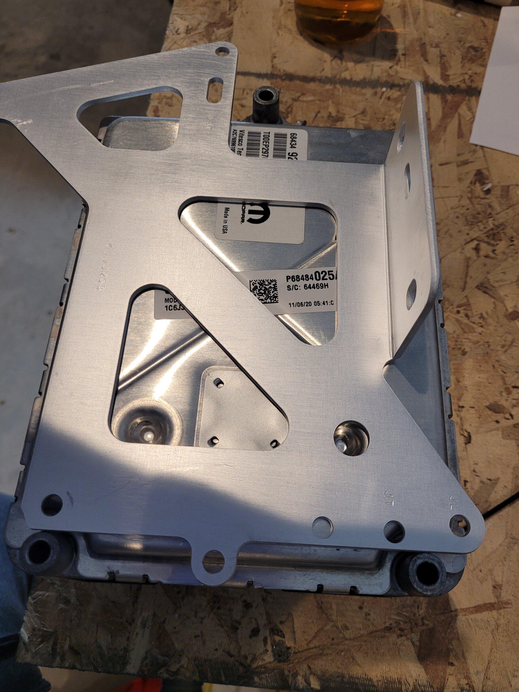

Alright guys. Did take me a while to install it. The bracket that Pulsar (Holley) sent did not really work with the ECU. I could only line up 1 hole at a time even though it says JL JK on each hole. So I emailed them and decided to drill new holes.
Eventually messing around with it for a while got it to fit.
The farthest hole to the back is a pain. You barely have any room to work it and took forever to tighten.
Now to the test drive. Since I had 93 gas from Costco, decided to put it in performance mode. Did take me a bit to figure out the settings, but I think I got it down.
Engine sound. Yes it has a lot more growl to it. At one point, it sounded too much as it almost started vibrating inside. But the engine was cold.
Pedal, yes it definitely feels different and more responsive. I did like that.
MPG, welllll. I will have to update this. I only went about 5 miles each way. Once in performance and once I thought it was economy, bit I have a feeling I didn't change it properly.
Typical Iowa back roads. Some ups and downs. I was getting about 18 or so. No wind and about 40s right now. I will definitely take it on a longer drive tomorrow and let you know if anything changes. Right now, I'm 65/35 happy vs disappointed. For spending almost $1k. Hopefully driving it this week, I'll see better results.

I know everyone likes updates. Quick update. For the first tank of gas, i filled up 93 octane and have driven it half way in performance and half way in economy.
As far as performance, i probably averaged about 18.5 mpg. I reset it few times as i was in a hurry and had to step on it.
Most trips it was 60-65 mph and a pretty open and flatish road. I would think that a 20 mile trip each way on the same road l, couple of times, should tell me pretty darn close my mpg. So, no, i didn't reach 20 or even over. Again, no load except myself. Was the truck responsive, I'd say yes for sure; however, it appeared the most responsive up until about 4k rpms. Seems after that i felt less of a pull
Economy mode. The truck did feel less responsive compared to stock. The beauty is that you can switch it on the spot and notice the difference. As far as mpg goes, i did see it decrease to about 16.5-17 on 93 octane.
Yesterday i filled it up with 87 octane and will leave it in economy to see where I'm at.
Side note, I know people would like to see over 300 miles per tank. We'll, when i filled it up, showed me a range of 305 ?.
Ill provide another update this week as one of my friends wants to get the same setup and I'm not sure if i should recommend it yet.
I like the performance feel of it, just not sure if paying 70 cents a gallon more justifies it.
The last part. So in the instructions, they note how to access and change performance mode; however, it doesn't indicate how to select that mode and keep it. For example, when i select the mode, it doesn't appear like it's backed out if that menu, unless my cruise is on, touching the up and down the buttons changed my performance selection, even tho I wasn't in that screen. So if anyone can chime in on that, that would be great. Seems only way is to shut the car off

Lose the bracket that came with it. It's pointless. Poorly designed and will only fit on 2 holes, leaving one unattached. Talked to support and they said the same thing. Mine would have fit on the stock bracket. Instead i drilled New holes and made it work.
