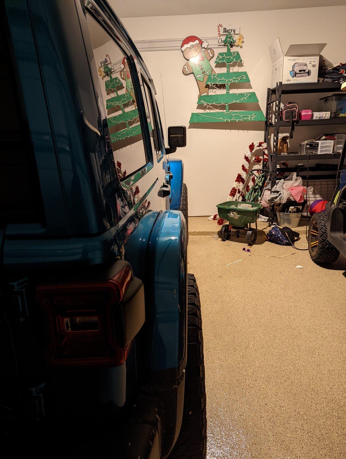

Below is a picture of my wifes JL Rubicon with 0mm offset and 35x12.5R17s with a 2inch lift. If you had 11.5inch wide, it would stick out 0.5inches less.
Now again, this is totally my personal preference. I personally think a more tucked in look is more ecstatically pleasing on something that isn't lifted. We're literally only talking about 3/4inch more on either side at 0mm vs 20mm.
