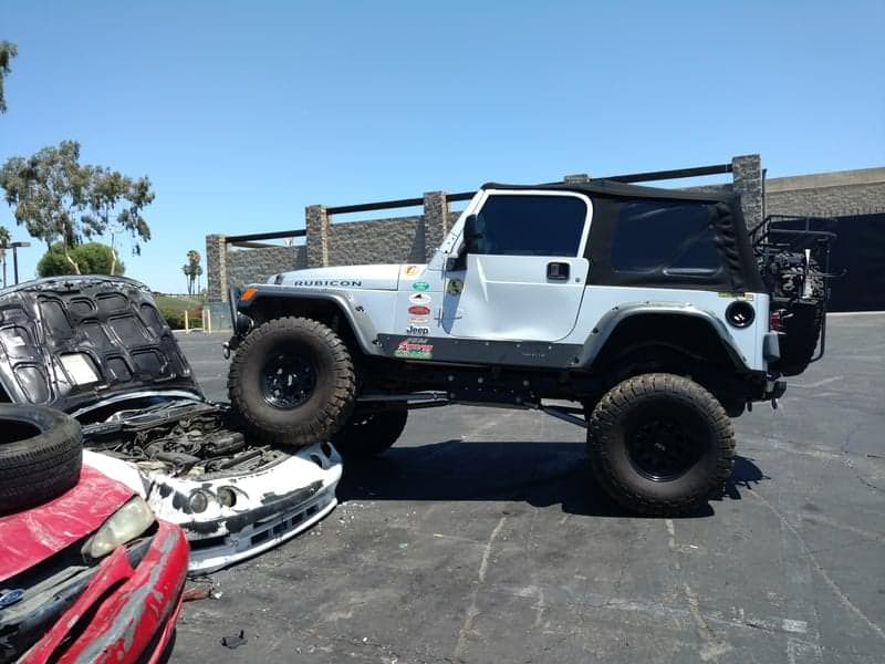

JTR
Jeep Gladiator Lift Height, Tire Size, and Wheeling FB_IMG_1571540500880
37s and reinforced factory axles. I'll be trussing and gusseting the new gladiator too. Even with the glad getting larger tubes it's cheap insurance.
I will say something that hasn't been brought up here is tire width. I ran 13.5 wide on the JK. It started out as a rock krawler and morphed into the overlander. That said I'm going to stick to the narrower 12.5 wide tire for this build. Doesn't seem like much but it is more weight and footprint.
