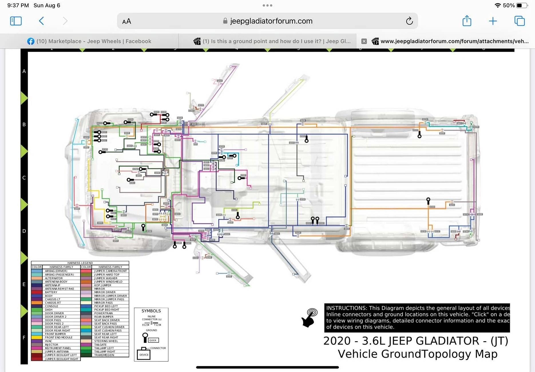

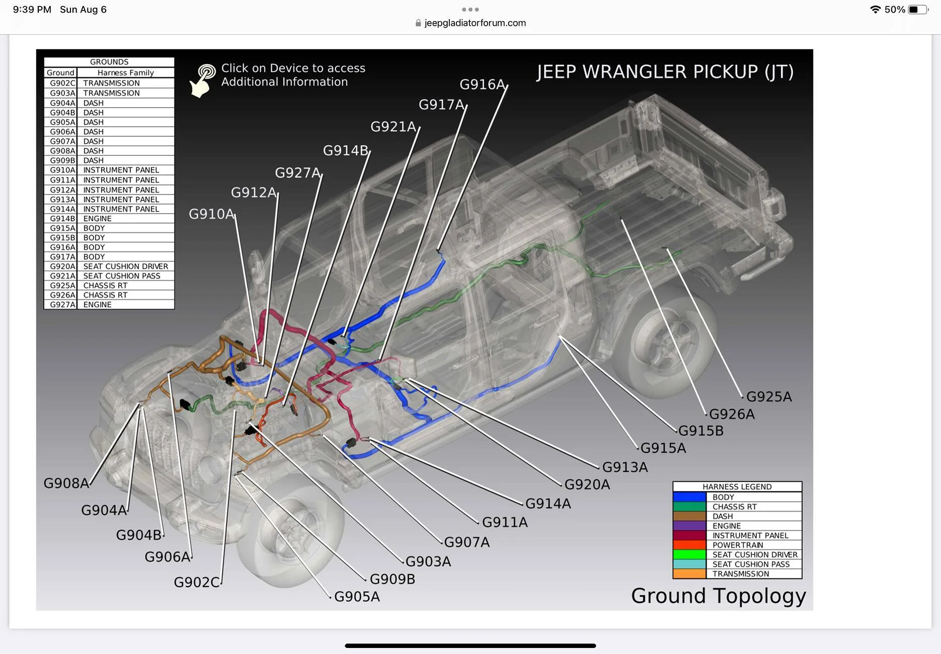

Freems
Mar 13, 2023
870
1,192
Boise Idaho
I had auto parts store run a scan, it came up with P0128 (Coolant Temperature below Thermostat Regulating Temperature) He said he could not reset fault code. so I bought a scanner and did it myself, I was just wondering were aux battery hooks up to kill power to see if it would reset fault before buying scanner. I'm a poor man I own a Jeep. I need to get me a wiring diagram I suppose just thought one of you Jeepers would know. Thanks anyhow.
Jeep Gladiator How to reset Check Engine light by disconnecting battery IMG_0073
Jeep Gladiator How to reset Check Engine light by disconnecting battery IMG_0074
