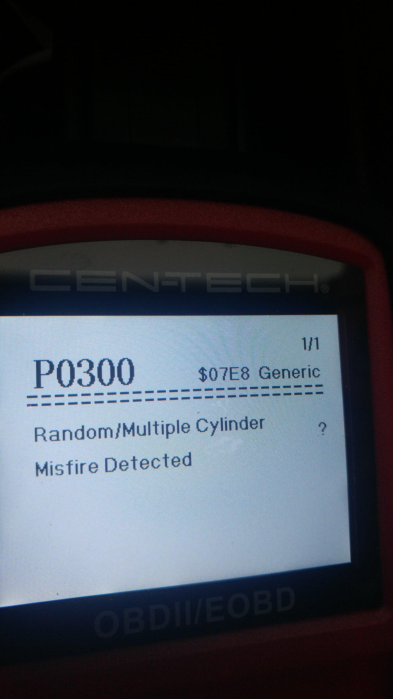

Inigo Montoya for the win! Used friends ob2 and got code. Used crappy blue reader and confirmed, issue reading was ignition was not on on RUN.
The code IS........ P0300 Random/Multiple Cylinder Misfire.
Any gas cap betting folks need to pay up!

But isn't that the code the computer throws when the gas cap isn't tight? I'm not aware of a code which specifically says, "Loose Gas Cap".
