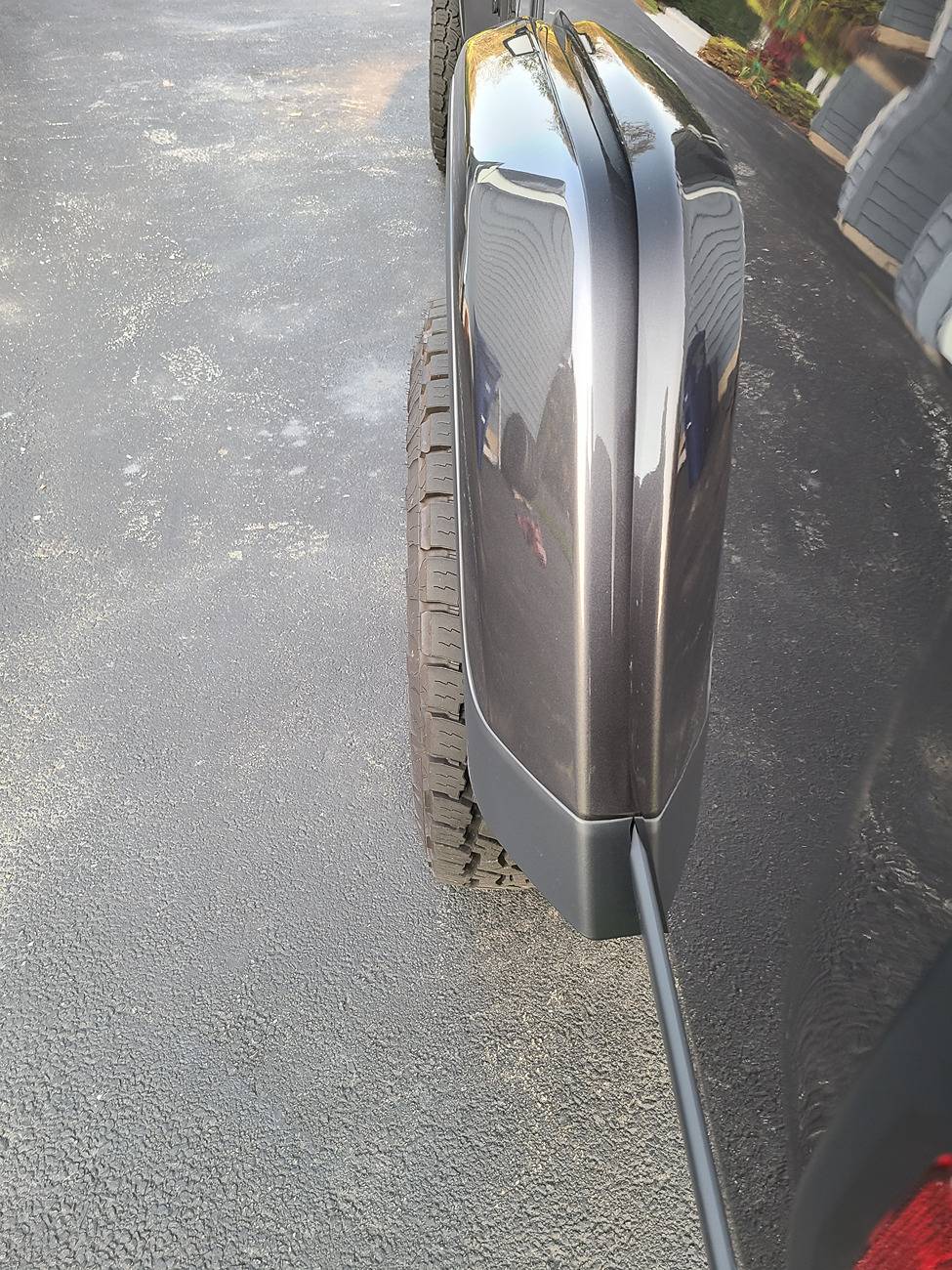

17x8.5" Works fine on my Mojave.. 35x11.50/17 TOYO OC ATIII. 4.5" back spacing... 3 years now. BTW run at 26psi cold (chalk test).
Jeep Gladiator How's an 8.5 wide  17 inch wheel gonna work with an 11.5 tire, Probably  35  but maybe 37? 4.5 BS 35s
Big help, Thank you!

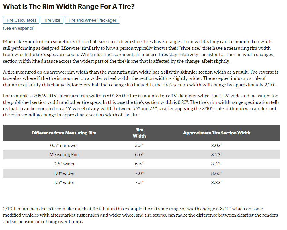

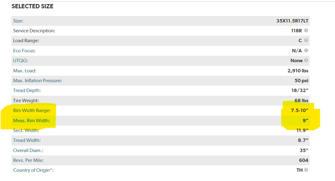

I have always checked out Tire Racks spec column on tires I shop, great reminder above to check with Rim range. 7.5 to 10 for the 11:5. Falken WP AT4.
Tire rack does give a good education too when you change wheel sizes different from their test size specs. Good stuff.
