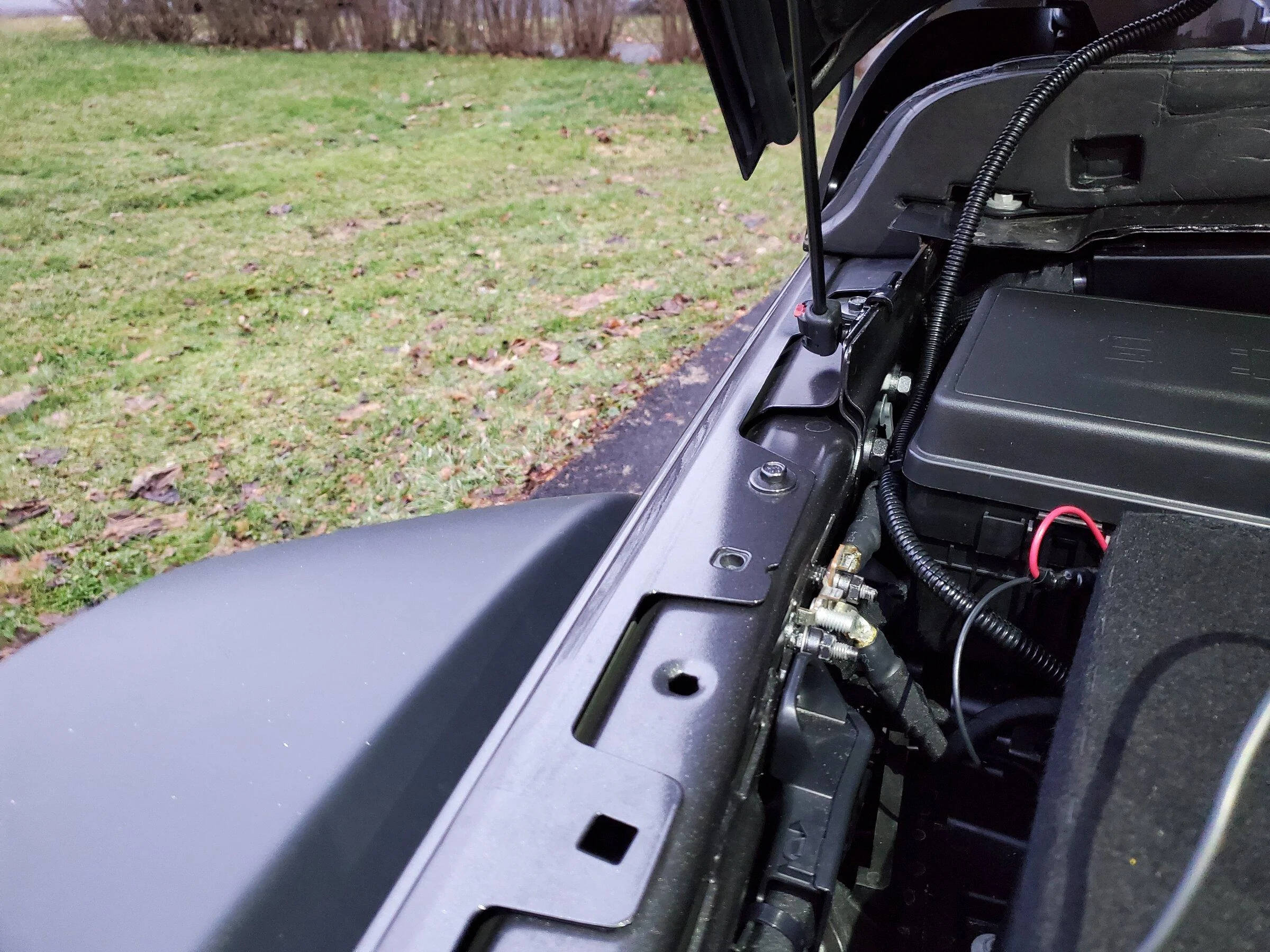

So I don't know why it didn't occur to me but when I opened the hood to take some measurements I remembered that the main set of ground studs are right on the other side of the fender.
Jeep Gladiator Hunting a Ground. Antenna 20211229_162143

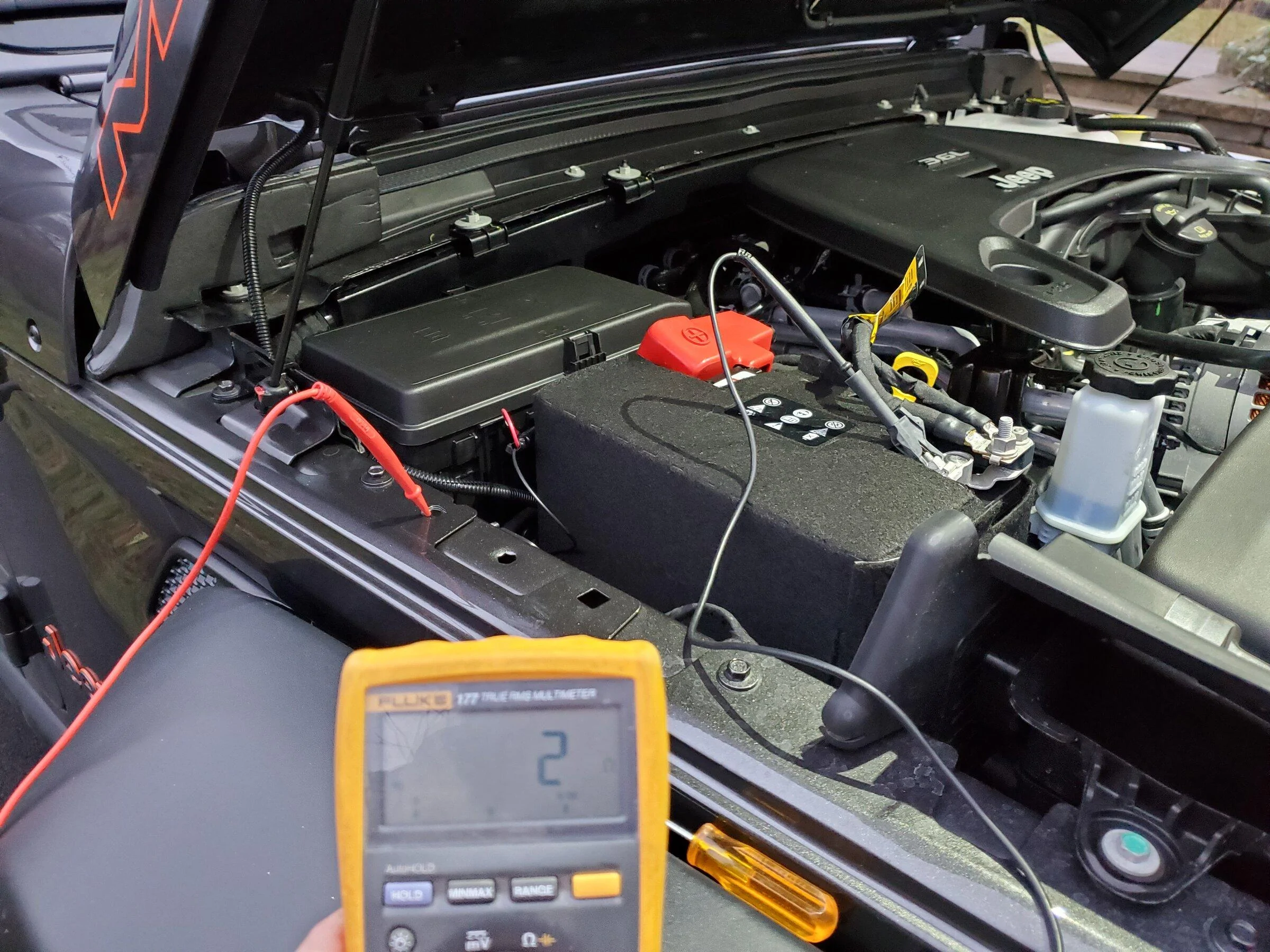

I did take measurements to a couple of other spots though. Where my red test lead is I got 2ohms to ground. That appears to be a threaded insert for an m6 or M8 bolt (my guess).
A couple of other bolts there on the fender that don't have paint also have ground.
I did not get a ground reading at the antenna mount.
Hope that helps.
Jeep Gladiator Hunting a Ground. Antenna 20211229_162218

I forgot to mention, I didn't pull the cowl off, but everything underneath appears to be painted. There might be a couple of bolts you could pull off and find ground though.
