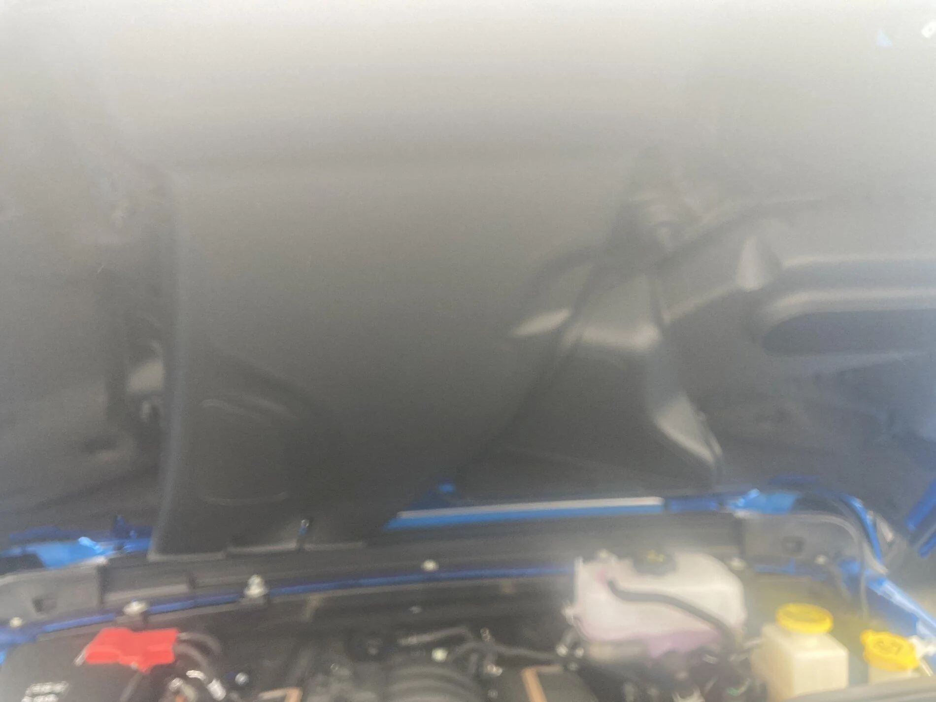

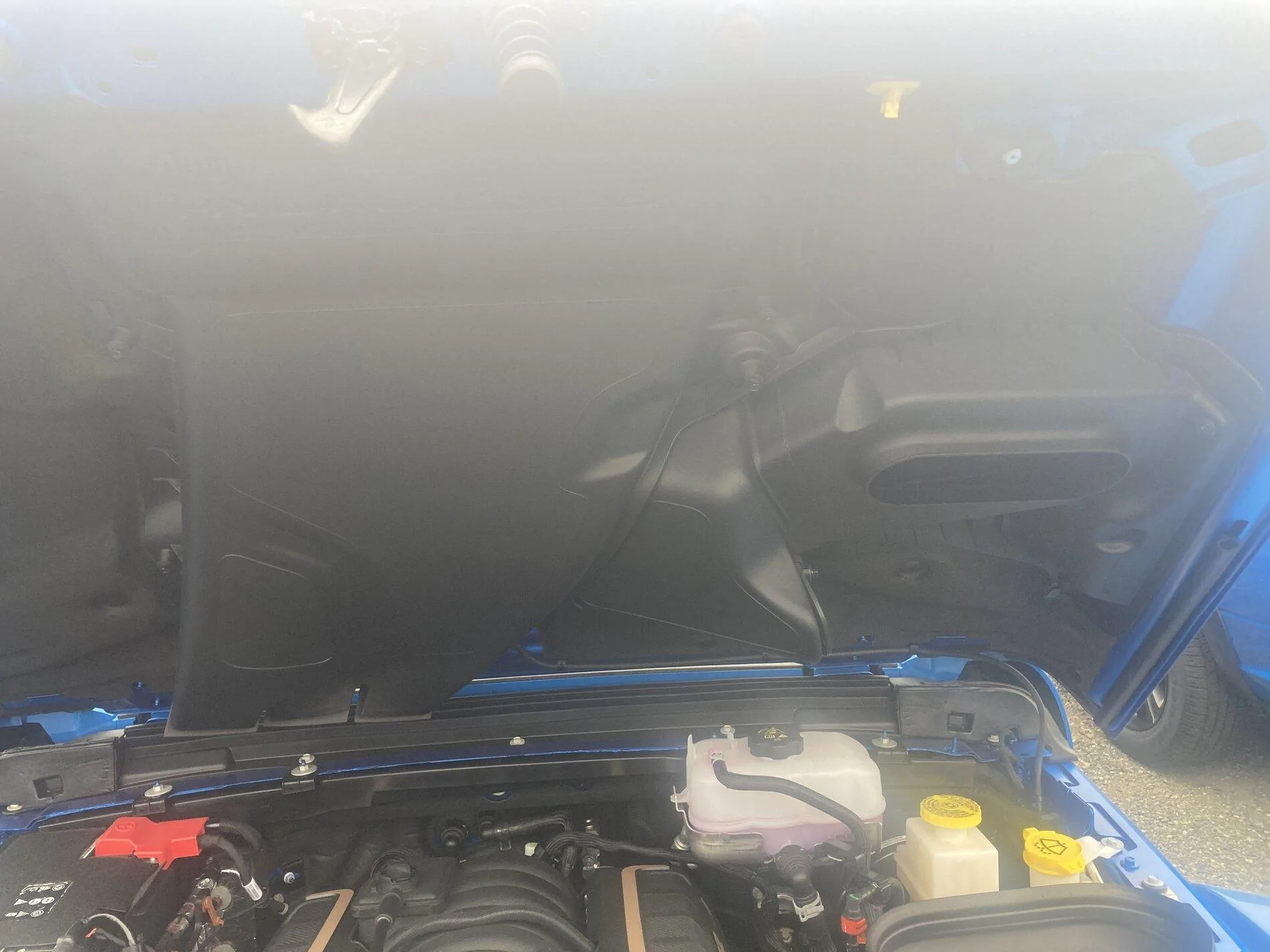

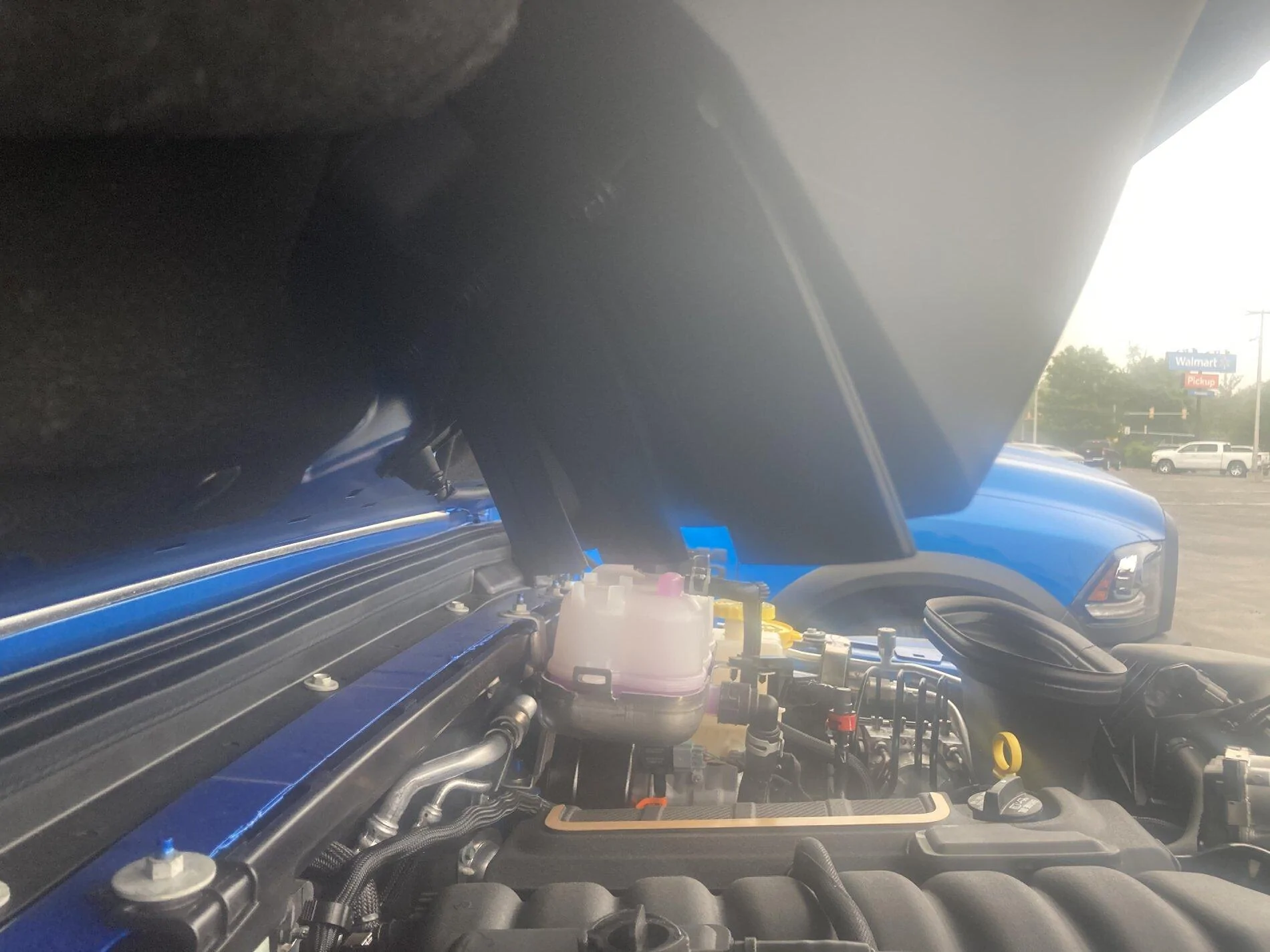

I looked at one it does a couple things there are rubber flaps over the air outlets under hood, I assume when you slow down or stop they would seal and all air goes to engine only, when at speed with lots of air coming in they ooen and put cold air into engine bay and some goes to engine......Jack
Jeep Gladiator Hydro Guide 7FF54204-C5ED-4C45-91CB-072E5AC5F7EB
Jeep Gladiator Hydro Guide C682ABA2-BF01-42FC-A3D3-3C1214F8B521
Jeep Gladiator Hydro Guide 8226791F-A856-4458-AF27-197081BBA950
