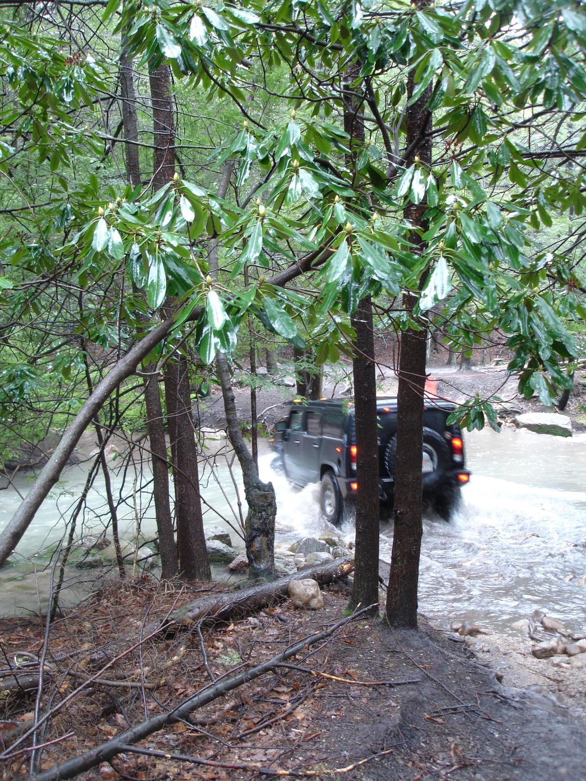

I wonder how expensive and how difficult. Dont land rovers go almost all the way submerged? Hummers too? Or am I thinking Humvves?
The Hummers would do well in the water.
But not the same order of magnitude as the Humvees.
When my unit was getting ready to return from Desert Storm, we had to clean our Humvees thoroughly purportedly to avoid bringing back harmful foreign bacteria or something. We drove them through water that was up to my neck with no problem. There was a mechanical "ford" setting on them that you activated by turning a lever on under the steering wheel.

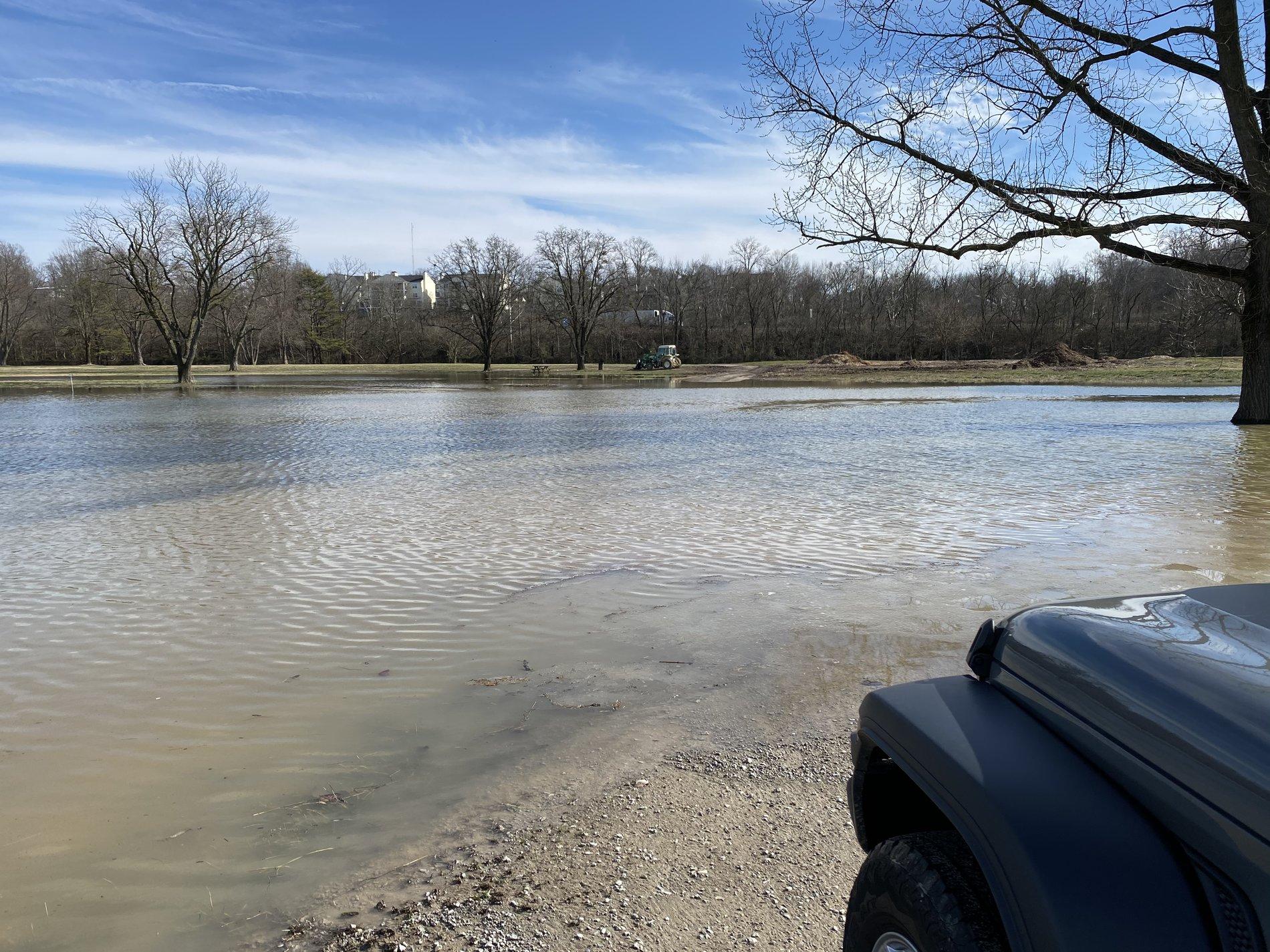

yah, 30” was just below the tires on the sport (31.5”).
There was plenty of steam and a new smell coming from somewhere down there. Of course the water was freezing cold and I had been driving for half an hour highway speeds before going through.
