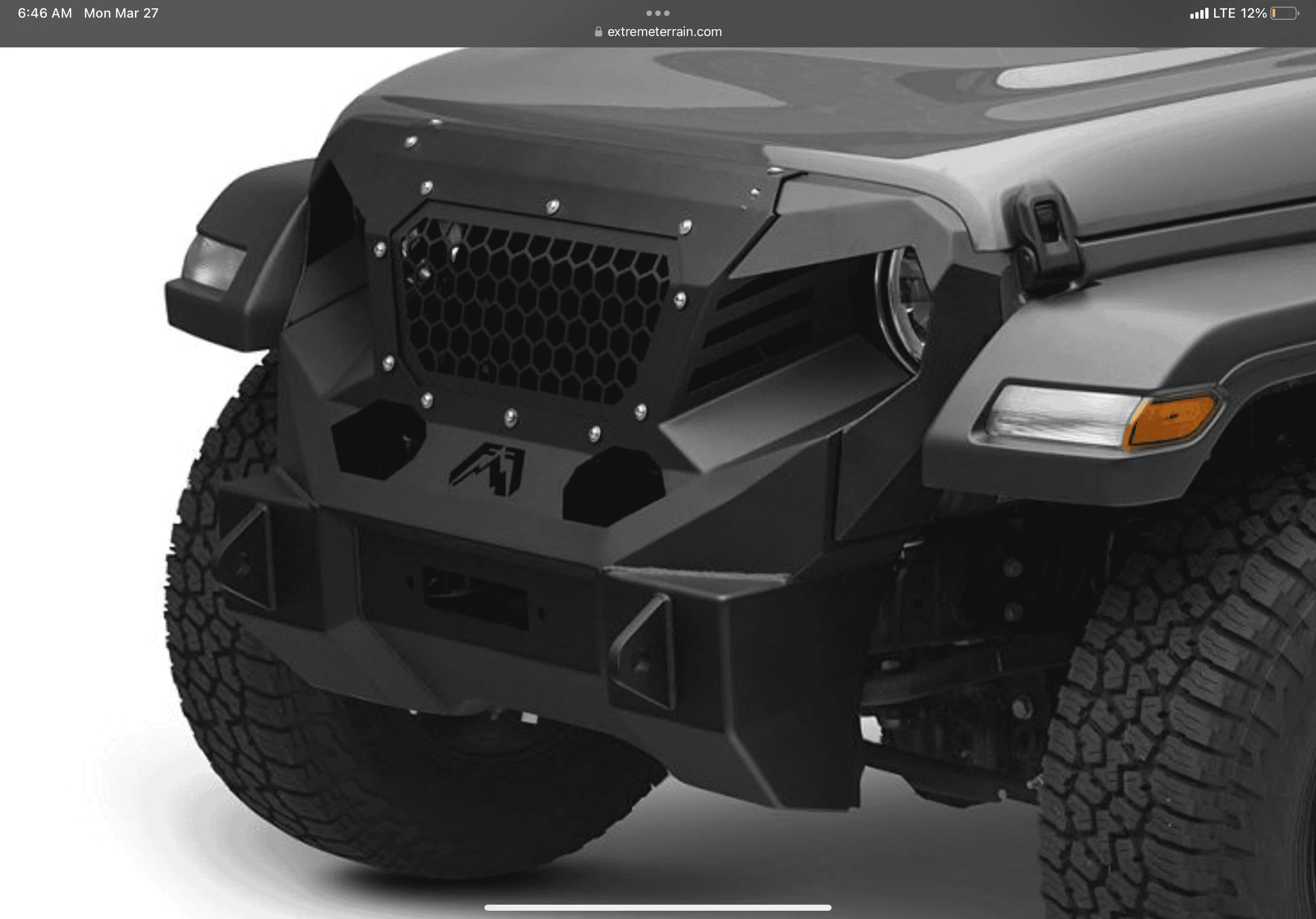

I've owned a handful of Jeeps, a couple Wranglers, couple XJs, and now my Gladiator. Its just a Jeep thing. The short front overhang doesn't catch it like other vehicles, so it goes straight up and out with the force of wide tires hitting the water at speed. It can be scary, but the faster you go, the faster your windshield clears
Ahh, is that what this is for?

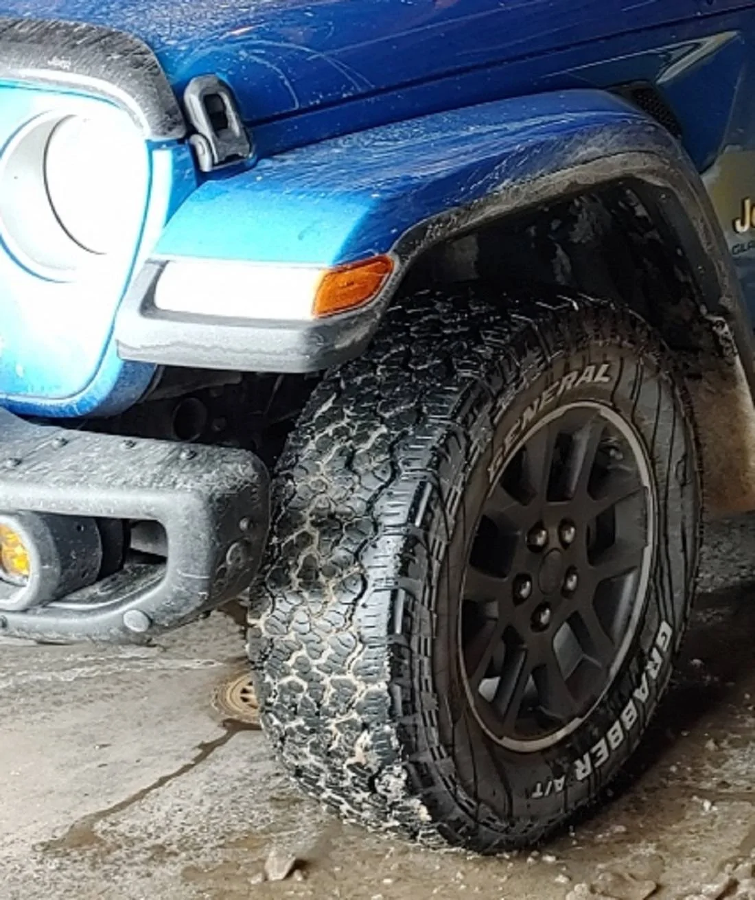

I run into similar when the snow and ice start to melt off the roads, or the county has spread so much brine on things that it makes things really sloppy.
My JT Overland is lifted about 1.5", A/T tires, steep bumper and I drive into the stuff my own tires throw forward. The proof is in the pattern when I get home and park it. The slime it thrown forward all over the bumper, and back at the front of the hood and headlights. And I'm talking when there's NO OTHER VEHICLES in front of me to throw the stuff. It's just me - and I'm driving into things as if I'm behind a truck or something.
There's a reason these have the bumpers and fillers and height and all that they do.
It doesn't happen on my wife's stock JLU Rubicon with plastic bumper so that tells me a little something.... the top of her bumper isn't messy, the headlights and front of hood are cleaner than with my JTO.
The bumper is closer to the fenders, closing off some of that space where the tires throw stuff through.
I've even run into rocks that my JT's own front tires have tossed up in front of me. No other traffic, I'm the only one on the road and I run into a rock that lands on the hood and makes a slight dent.
Yup - the vehicle is doing it to itself due to the front tires throwing things forward only to be run into again.

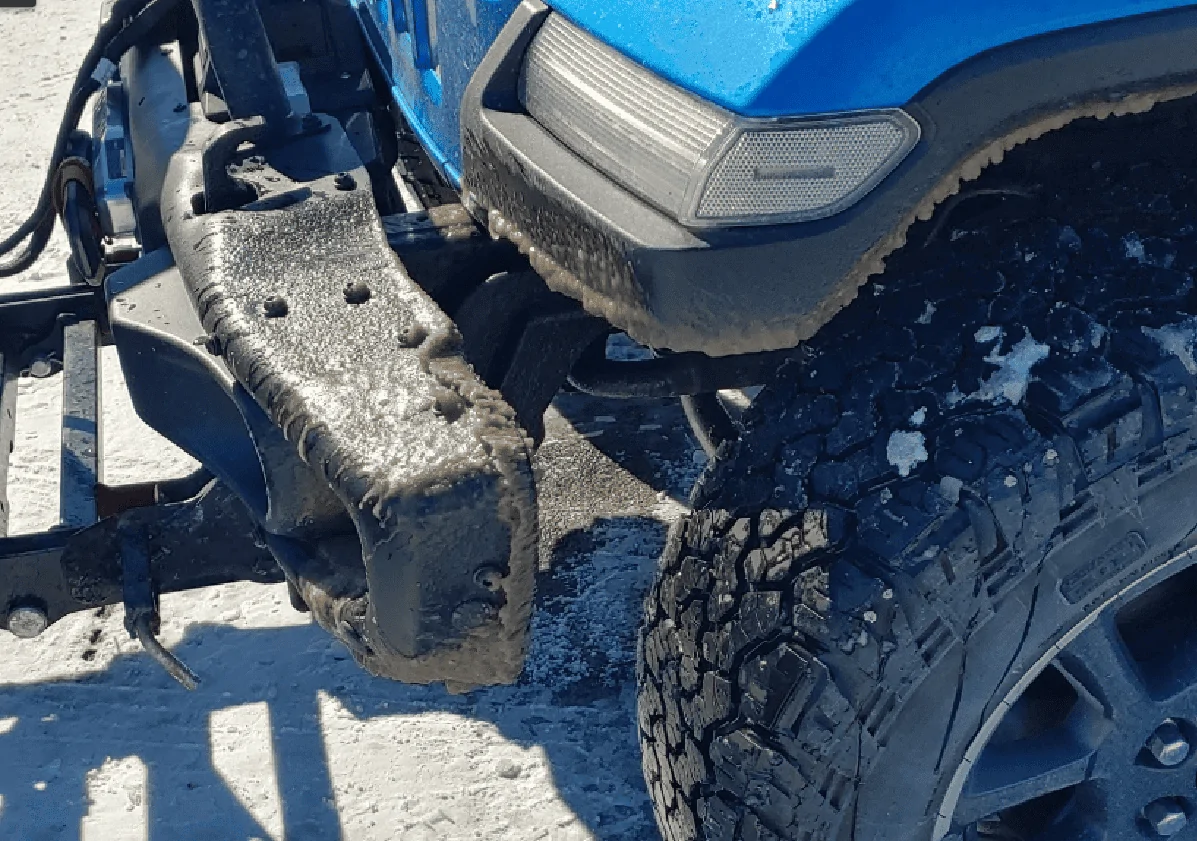

In this case, I was not following anyone. It was all my truck's tires, and it's even worse without the ends on the bumper. I tried it, and put them back on after a while. That's a big gap for the tires to toss stuff through.
