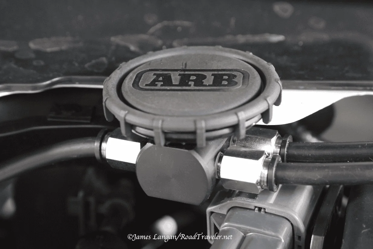

I find it ironic that they extend the differential vents up way high - and let the transmission and transfer case suck dirty water.
Why extend just part of the drive train vents?
There should be a bracket under the hood with a row of vents.
@californiajeeping
Apr 1, 2020
955
1,006
California
2022 Jeep Gladiator diesel, 1977 cj5 LS swapped
I find it ironic that they extend the differentia vents up way high - and let the transmission and transfer case suck dirty water.
Jeep Gladiator Water fording depth - Update 1659725813796
40,449
53,886
Yeah, that'll work, but the factory should do such a thing.
A bit much bling and size for my tastes, but if one wants fancy and to brag about a billet vent LOL but that works and puts them all in the same risk plane (or lack of risk compared to factory)
Maybe I'll do like I did with my aux switch wires - make a bracket and a tidy row of vent hoses
Why do they vent the differentials above axle level and leave the transmission and transfer case vents under the floor?
AMC did that in the 80s with the Eagle - front differential was up under the hood even with the air filter - transfer case and transmission still vented below the floor. Made no sense other than cost. Cheap to run a 3' hose up into the engine bay and stick the vent in the top end of the hose. But the transmission and transfer cases have no places - no nipples for a hose (can we say nipple here and not get banned?)

Well they do have a mock one way check valve that should prevent water rushing right in. Maybe thats enough in the OEM's eyes.

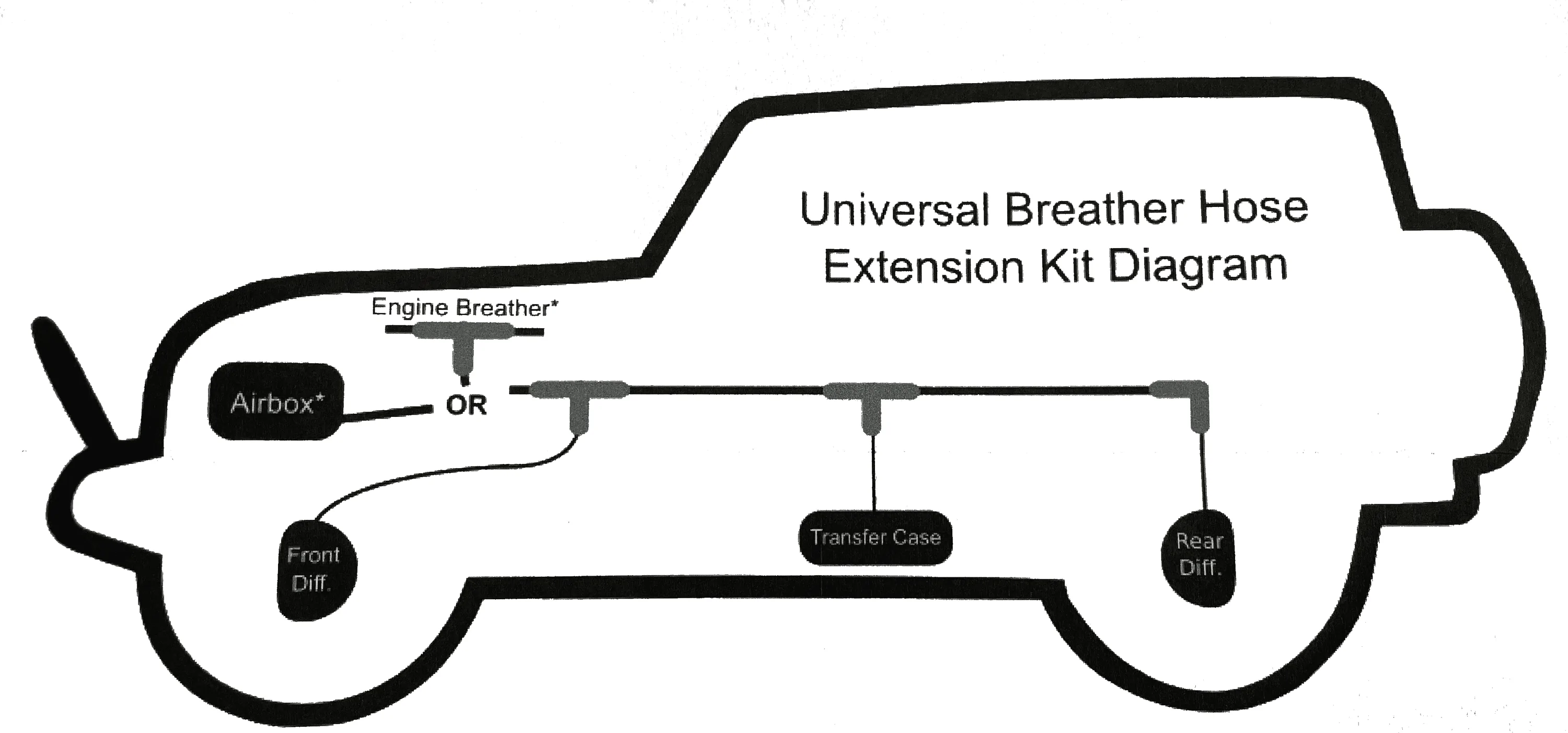

I’ve seen a kit that chains all the breather tubes together and routes them into the air box, presumably for someone with a snorkel since EVERYTHING would then be all the way up as high as the air intake. Effectively taking your breathers all the way to the roofline.
