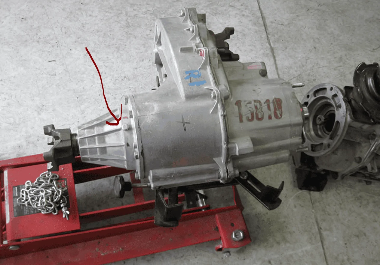

On my 06 LJR, the differential vents were raised as others have said. I live in Houston, where we have flooding a lot, and so I really focus on fording capacity. I found that the transfer case vent was just sitting on top of the bell housing, so I raised it and the transmission vent to the top of the firewall. It made no sense to me that they raised the differential vents and not the TC vent.
Can you take a pic of where the vent for the transfer and transmission case are?

What I wondee is that the engineers for this vehicle put a lot of good thought into the off reading aspects. They intentionally raised the transmission vent tube and diff tube. If they could have raised transfer case tube, and it looks to be a very easy thing to do, why didn't they? Perhaps there is a limitation in the case design that requires the short factory tube?

Exactly. I think I’m just going to raise the transfer case and rear diff breather tubes. The front diff and trans breather tubes look in a good spot in mine already.

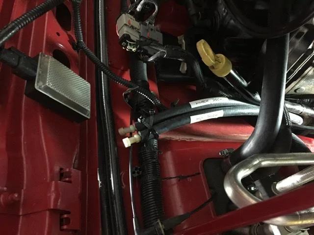

What could possibly require a short "Tube" since the vent is at the end of the tube and in theory, it could be 10 feet long since a hose is not restrictive.
As far as engineers putting a lot of thought into.......... and raising the vent tube............
1980 AMC Eagle - rear differential vent tube is up inside the frame rail which would put it about level with the top of the tire or a bit higher.
Front differential vent tube is up on the left/driver side shock tower in the engine bay, a bit above the top of the front tire.
The transfer case vent was not extended for some reason, it's got a standard metal-capped vent on the tail shaft housing.

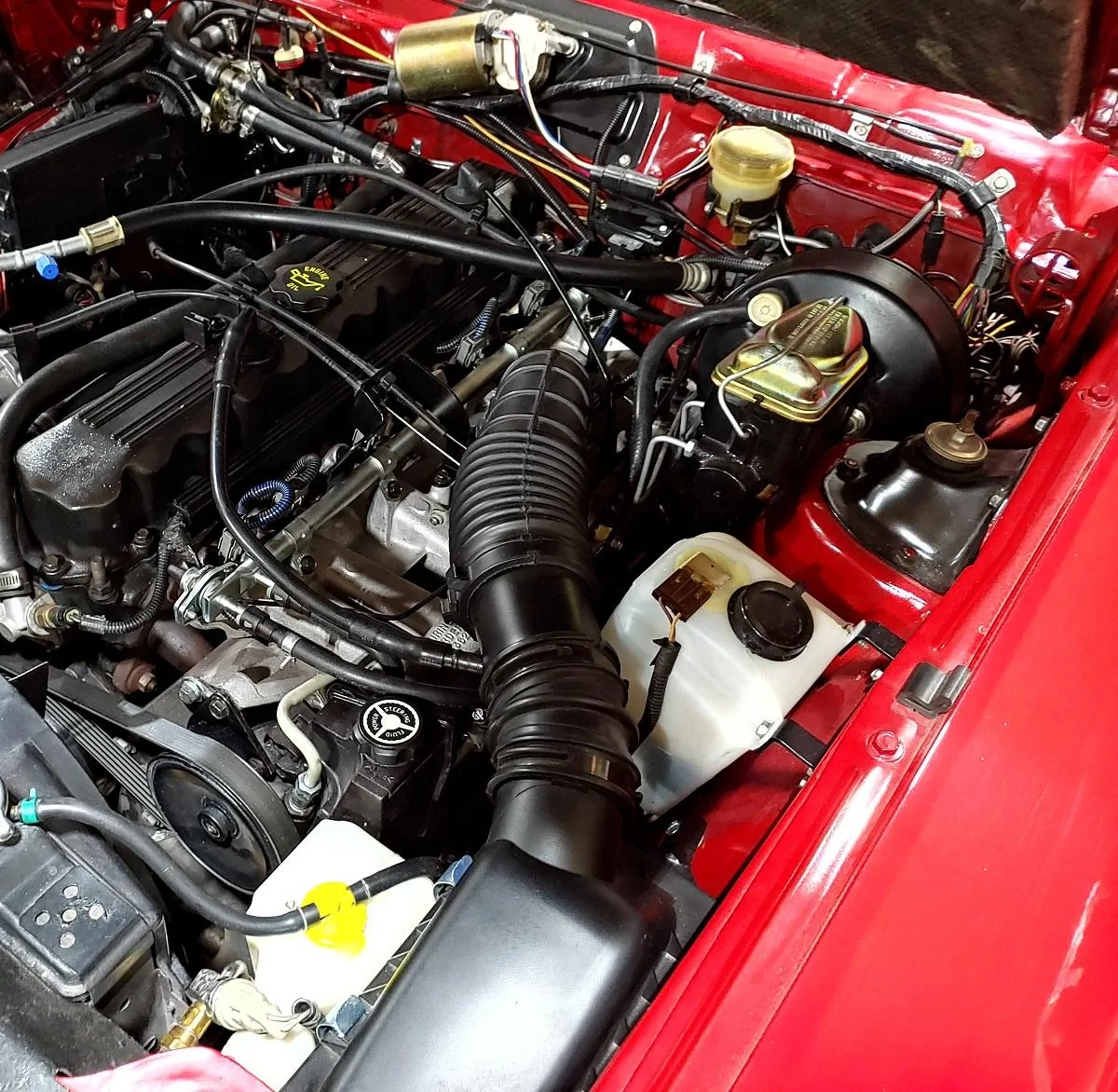

The front differential vent is right behind the windshield washer jug in this picture -
Jeep Gladiator Water fording depth - Update eng-bay-left-frnt
The transfer case has a standard vent - strange -
