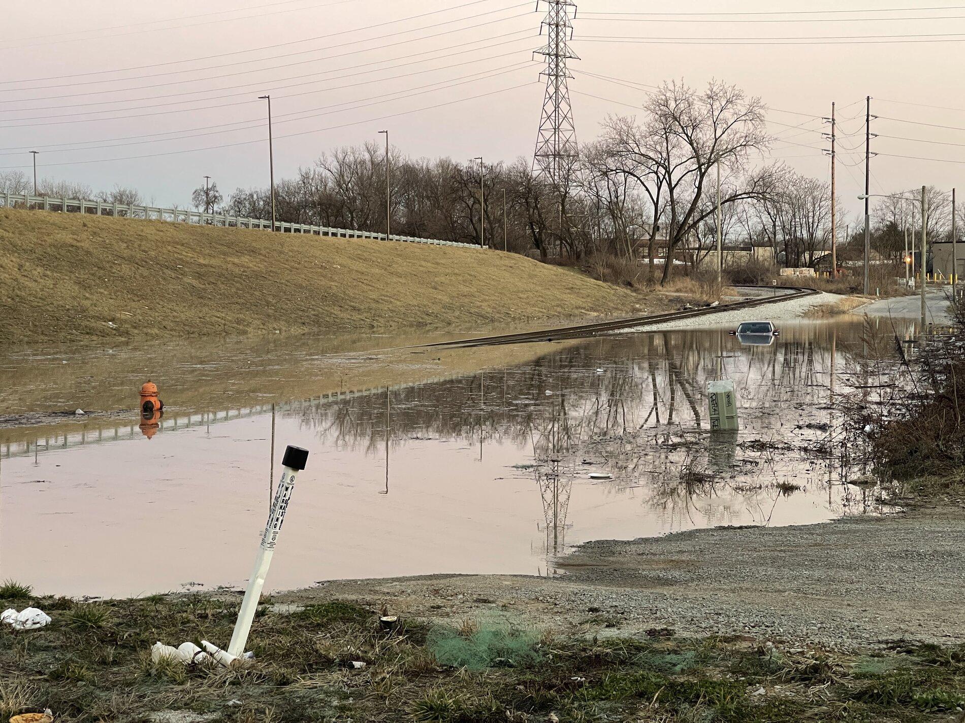

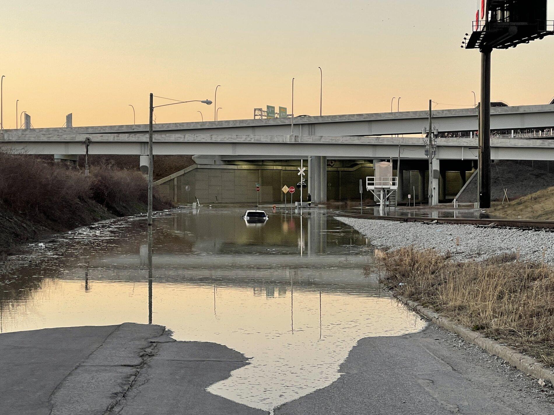

My wifee managed insurance vehicle claims for 21 states and has dealt with a lot of water damage. Except for vehicles like raised trucks and SUVs where 30" of water will not reach the insides, probably 99% of all other vehicles that sit in 30" of water will be written off as a total loss. Insurance will not pay to repair all the soaked electronics, interior, etc, due to future liability. They would be married to the vehicle and all its future water related problems like intermittent electronics, mold, etc.
I suspect the fording specs for the Gladiator are for very short term passing through with doors on and sealed and not sitting in 30" where the interior is at the same water level.
