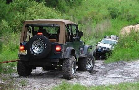

Just dirty outside after I had washed it to install mudflaps, not that it matters hours of rain and driving in to and from work. So I'd have to wash again before installing. The water had gotten into fuel tank of my XJ that experience was years ago. A picture as I was winching out... Winch line ended up being short, tree strap, 20 ft strap to Eric's Jeep winch line to front to reach. The 2 TJ's didn't have it to pull out XJ :facepalm:

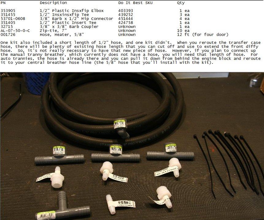

On my 1987 LR Defender, when you installed a snorkel kit it came with plastic tubing that clamped tight over all the vents and connected to the bottom of the snorkel with a water tight seal. As long as you kept the snorkel intake on the top of the A pillar above the water level, you were good to go. Unless of course you floated away first!
Wonder why there is not a kit like this for a Jeep or maybe there is.
This is what I have on my JK ...
Jeep Gladiator Water fording depth - Update River Raider Breather Hose Extension Kit Contents
Originally from ...
https://haukoffroad.com/shop-by/manufacturer/hauk-offroad/smilin-bobs-breather-hose-extension-kit/

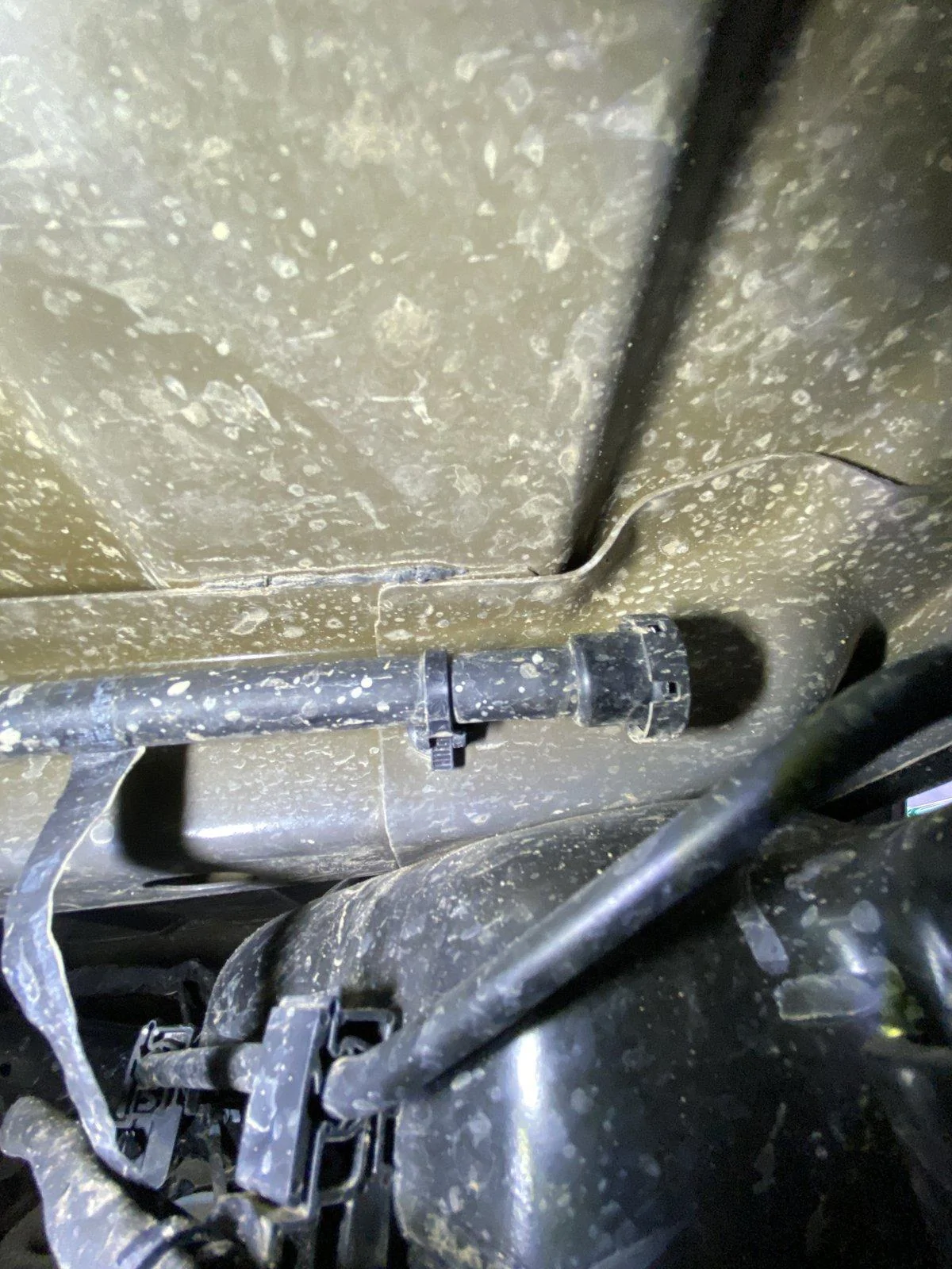

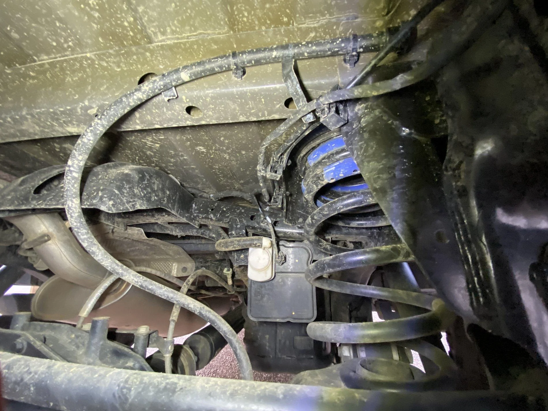

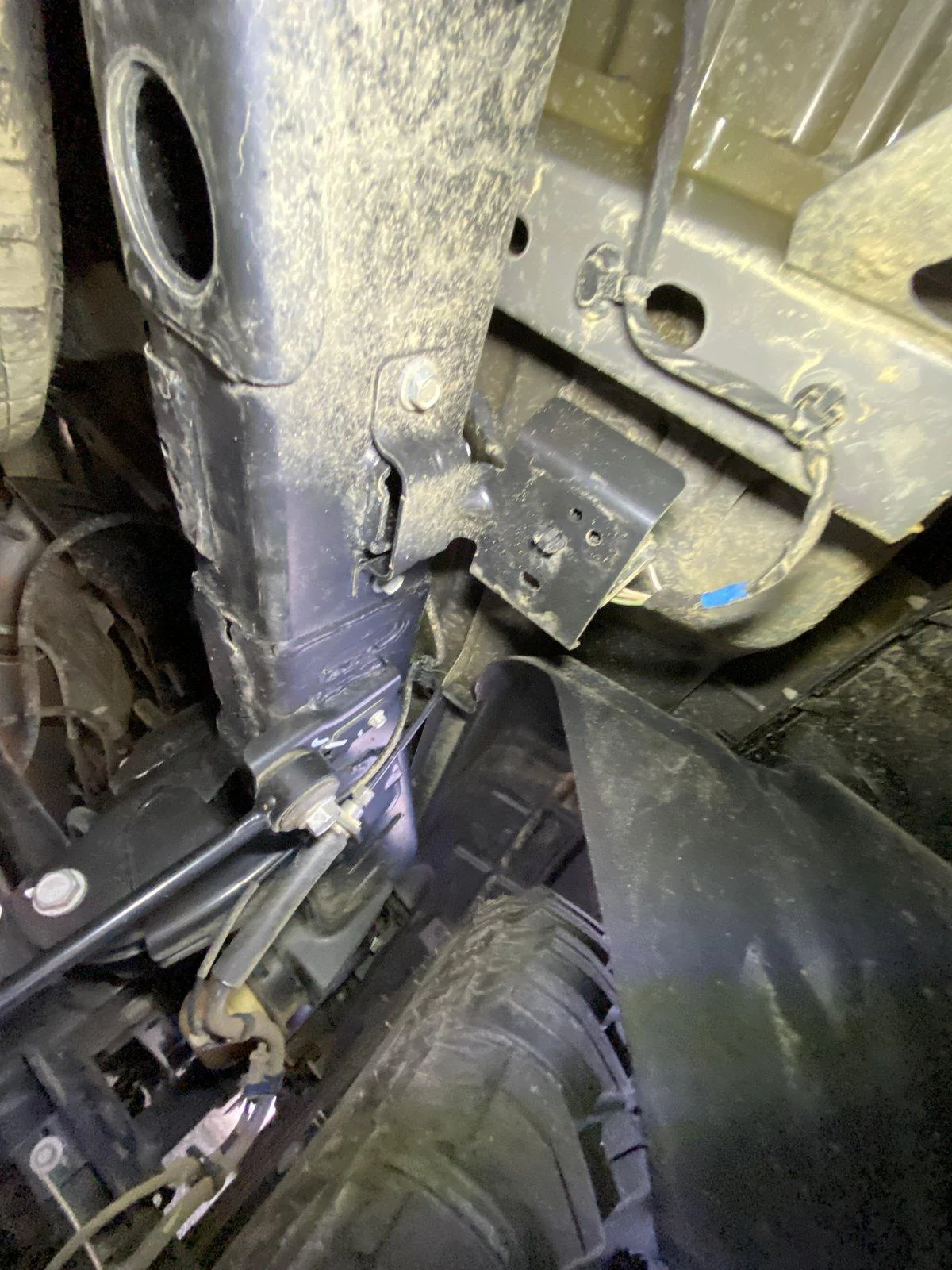

So I have found my rear differential breather tube to be sealed with a cap. Looks like the transmission and axle breathers are as well. Does that mean breather tubes are not the limiting factor ?

According to the user manual and Jeep technicians, the electronics in the engine bay are sealed to withstand power washing. Not point blank nozzle against the connector, but I've had 2 techs at my dealership confirm that you can spray down the engine bay. Manual (and if I recall correctly from the JL factory repair manual) says electronics are sealed rather well.
But, the article could be correct. As you can see through the discussion in this thread, the consensus was the breather tubes (located about 24" for transmission breather, 30" for axle/differential breather). If not them, then the air intake? Which would be 6" above the 31.5" OEM tires on the Sport trims. But all JL/JTs have the same fording depth, which indicated the tubes. Now I'm confused.
From the first image you can see the breather tube is located ABOVE the tire (like 33" off the ground) and doesn't match the type in the article (valved)
