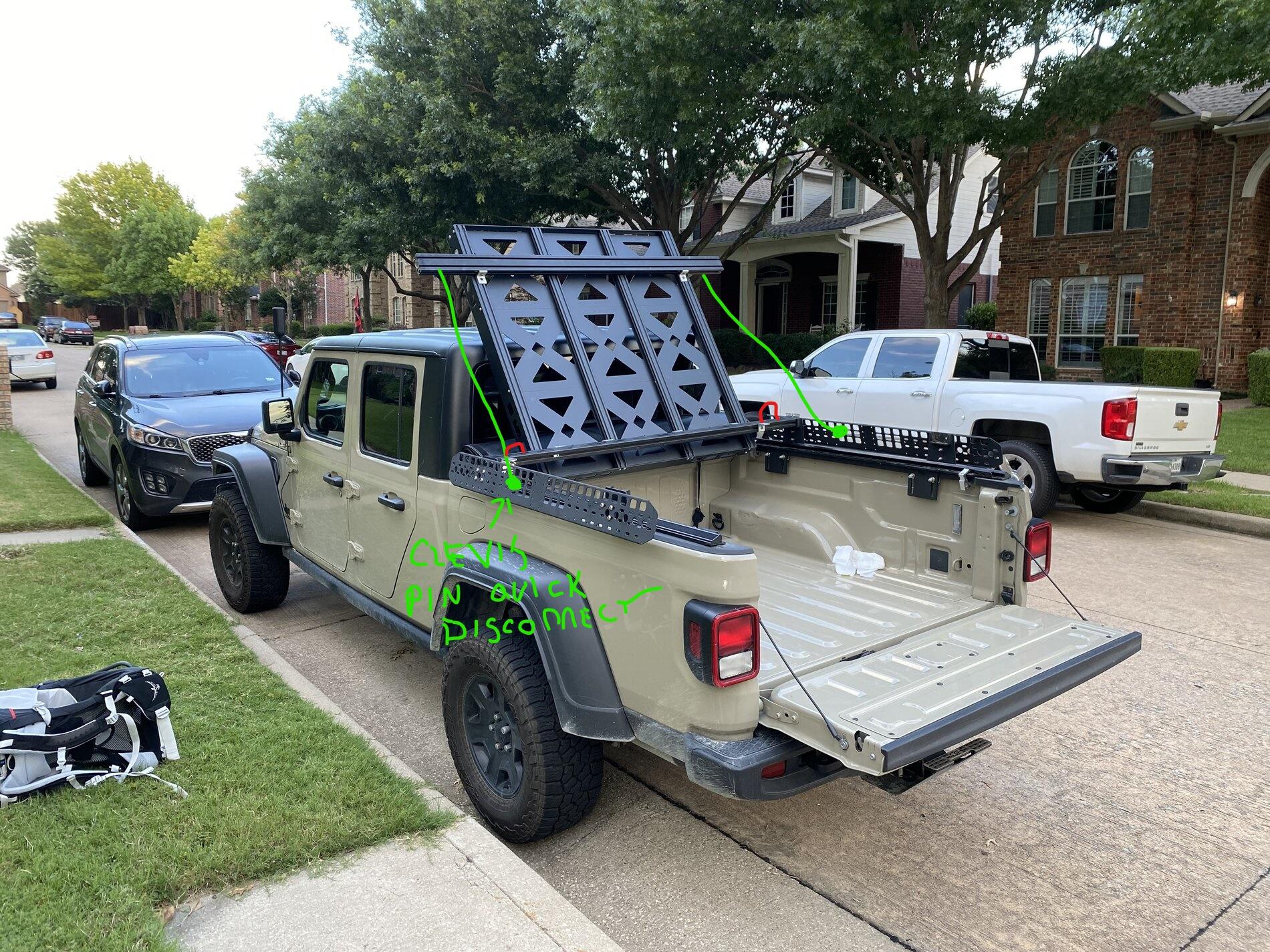

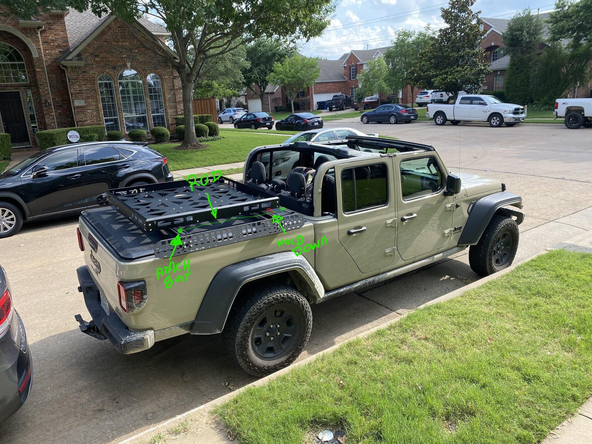

I haven’t found a perfect solution, but this is what I’ve done. I needed a cover but I also needed extra storage - all while being somewhat removable. I really like the Upper Decker, but it’s too heavy for me to remove without help.
I should mention that the reason I went this route in the first place was in preparation for a 3-week camping road trip. Had that not been in the cards, the back would probably still be empty. And when I get home, perhaps I’ll hang it from the garage ceiling.
But I do like having a bed cover so I can pop off the freedom panels whenever and wherever I want.
EDIT: To clarify, I (probably) wouldn’t drive with the basket up. That’s intended as a convenience feature for loading and unloading. But for short hauls of big loads, I guess I could string a ratchet strap through the back windows to hold it up.

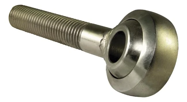

If you needed to drive with the rack up what I would do is create a Support rod for each side. Buy two lengths of either threaded rod or solid rod and attach two Rod ends on each side,
Jeep Gladiator I don't understand the advantages of a Bed Rack oem49
Then attach one end on the drivers side of the rack that sits above the roof and the other end on the rack drivers side at about one foot back from the front of the rack on the side, Attached with a quick disconnect clevis type connector. Copy for the other side.
Rough concept.
Jeep Gladiator I don't understand the advantages of a Bed Rack rack 1_LI
Jeep Gladiator I don't understand the advantages of a Bed Rack Rack 2_LI
Of course it would be mounted and adjusted to have the rack slightly more upright so it wont rattle on the roof.
