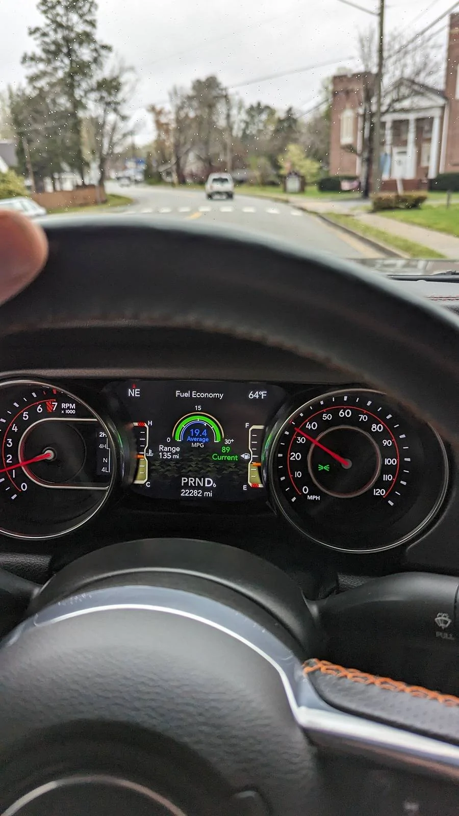

I swear my MPG has gone up 1.5 or 2 since I installed the thing.
I was running errands this morning and made several aggressive full throttle two lane passes.
When I got back in town I had the thought that I likely killed my good average I had going on this last fill up, so I toggled in and was very pleasantly surprised.

I've had my oil J&L oil separator installed for about a week...
It seems my fuel efficiency has consistently gone up over similar driving conditions. My Mojave is on 35s and it has been a while since I've seen 19MPG as my running average (probably closer to 17.5 MPG under the same conditions). Now I'm at 19 or just over...
On my F150 (also a J&L unit) I felt it had less occasions for rough combustion and saw a slight bump in fuel economy. It isn't crazy to think this could help fuel economy, and even a small change is worthwhile here. Still, pushing nearly 10% isn't trivial. Think of all the changes Jeep and other OEMs do for even 1s of percent change to improved fuel economy. Maybe something that needs even basic maintenance is too much for the general public? I've only ever seen one OEM offering, and that was Ford Performance Parts...
I am curious what other experiences here are. I'll keep an eye on this to see if this is a consistent improvement. I don't see any downsides with this catch can on our gas engines.

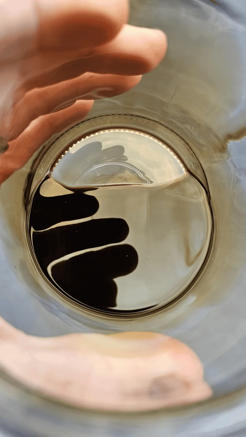

I was doing some other work and decided to check the can with another 1000 miles on it.
No chocolate milk this time, so I'm assuming that's a condensed water vapor when the ambient temperatures are colder.
I had the same experience. Here's mine from a week or so ago (warmer weather)
