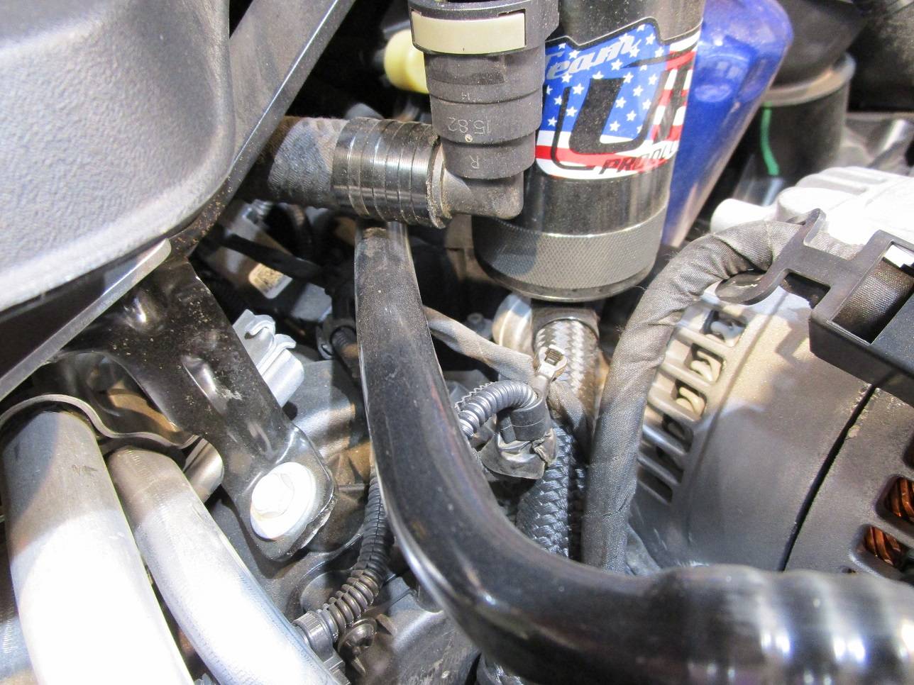

After 100 miles I'm sold it works. Might upgrade to the 6 ounce can.

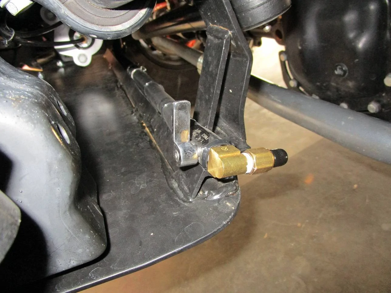

Do what I did.
4ft x 1/2 drain hose with ball valve.
It doubled my capacity and easy to drain.
I never have oil in the can. Its all in the hose.
