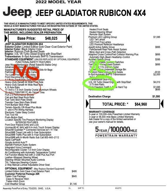

That being said, the Rubicon Diesel comes with the 4.10 Axle Ratio
Sorry to pick on you for this (someone else above did too) but Jeep makes it really easy to be confused by this. On the window sticker, on the LEFT they list all the standard equipment that comes generically on whatever trim you have. On the RIGHT they list all the optional equipment, some of which may supersede the standard equipment.
Attached my window sticker for clarity
Rubicons come standard with gas engines and 4.10 axles. If you get the optional diesel, you also get the 3.73 axles along with it. All diesels get 3.73s from the factory with no exceptions. Look again on the right side of the sticker, you’ll see the 3.73 listed

I agree. I went based off the manufacturer's tow rating and not what bits the build had. That being said, having some of the Max Tow package components is a positive.
No worries. Thanks for correcting me. Mine looks the same!
