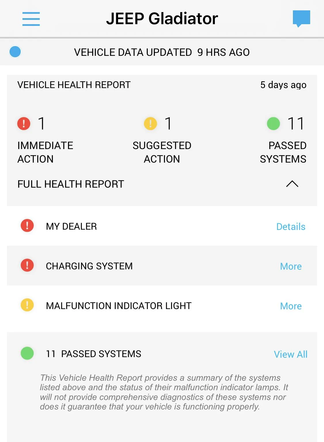

I have one as well, and I have been noticing that same issue. There are articles about the voltage it pulls at max throttle, that can make the entire system unresponsive, and even stall, I have had that happen as well. I took it out this weekend when it happened on the highway while merging and the entire Jeep went into Limp mode. I may put it back, but not until I am sure it isn't drawing too much. The Banks version apparently takes power from the fuse box or OBD11 connection and doesn't have this issue...

the codes were actually odd as hell, disconnected power to the throttle controller, and misfires... so it is a bit of an issue. I pulled the controller and have cleaned the fuel system, gotten an oil change and had the oil tested and have had no issues under load, off road or on highway since that happened. I also did a full reboot of the system, pulled both batteries for about 2 hours. that seemed to help as well. Although logically I know it shouldn't have.

Interesting. I have the following that won't go away.
