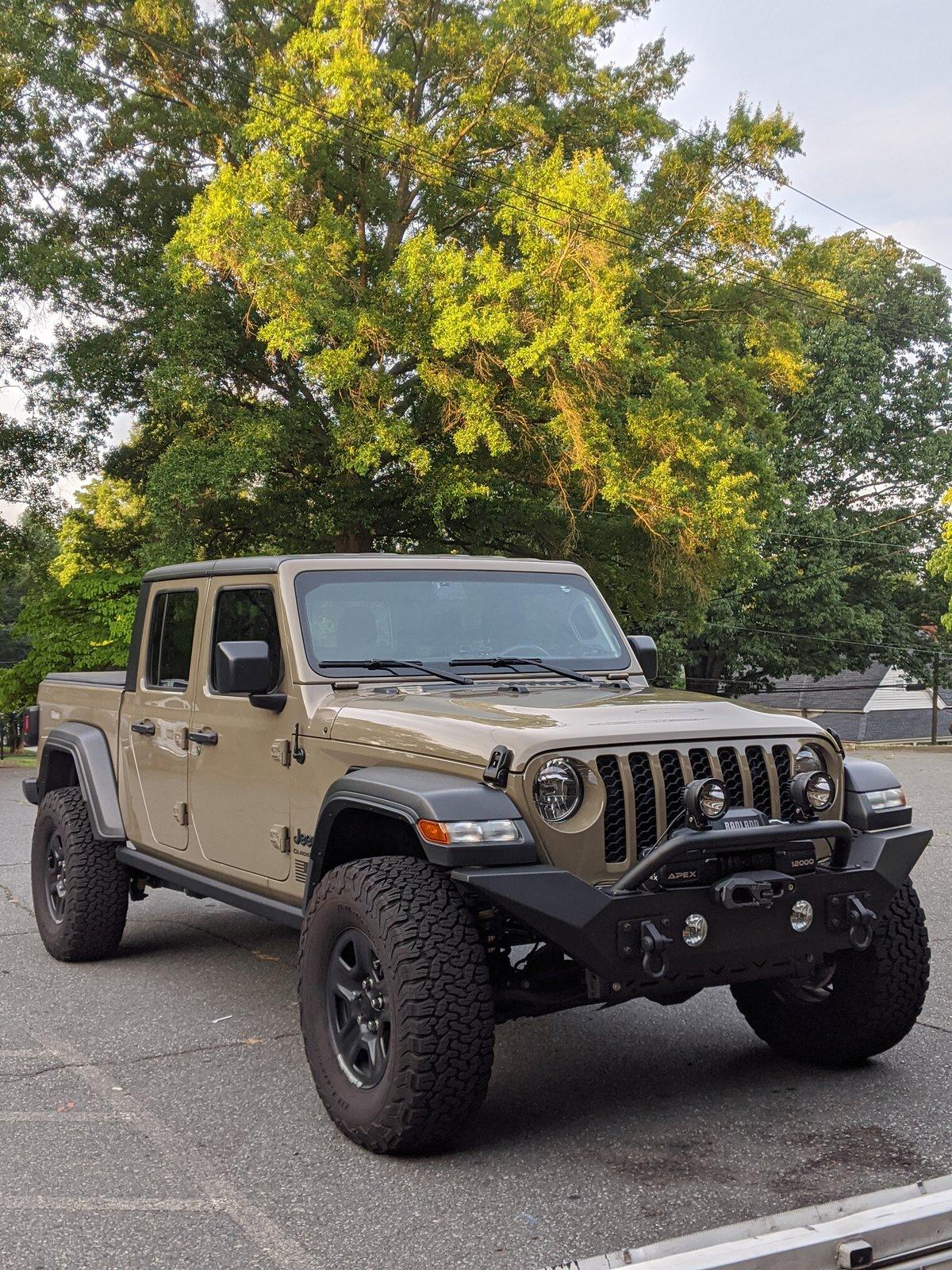

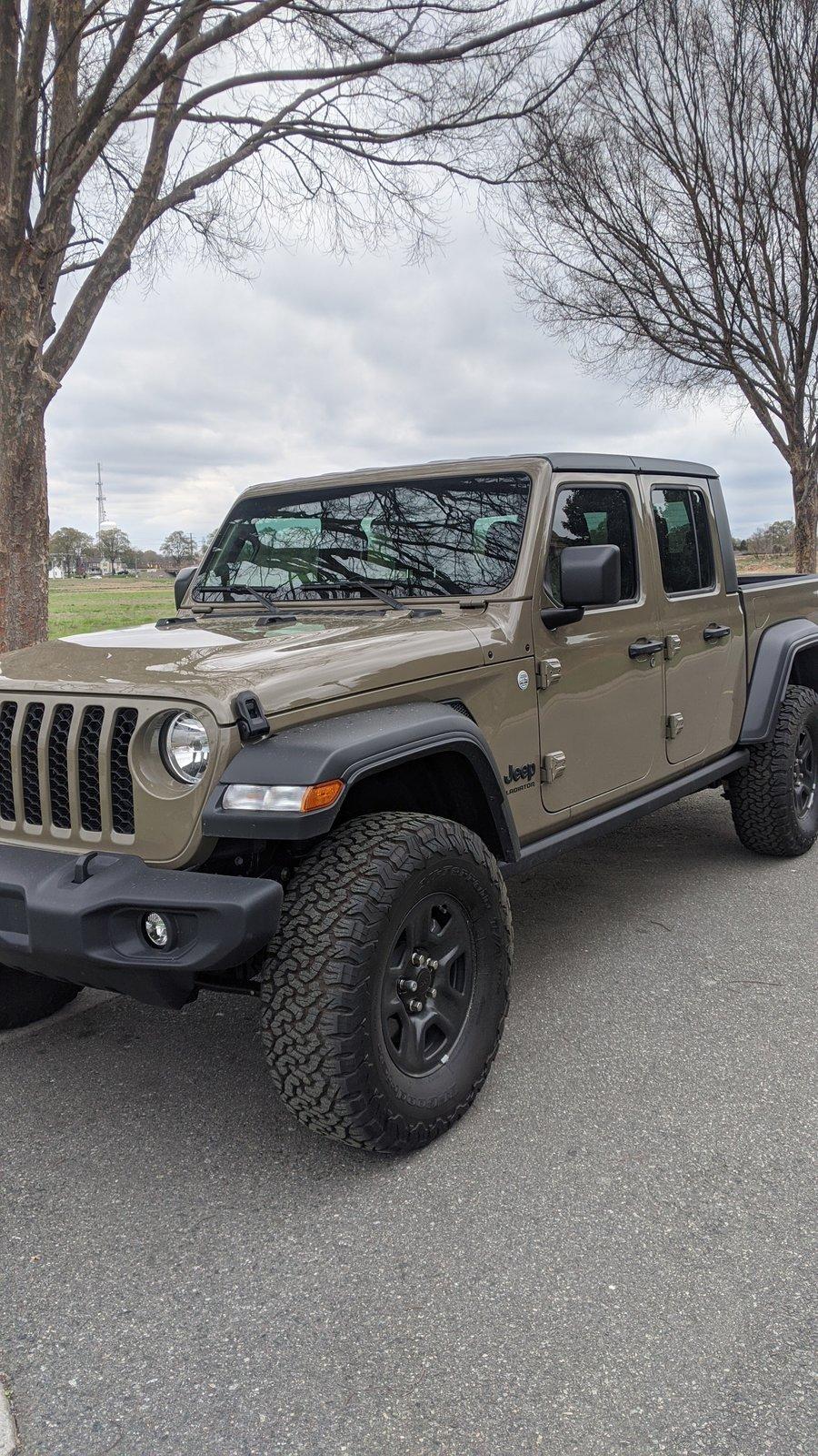

What size tires are you going to end up getting? Is there a chart somewhere that explains what size tires you should get for how much life you add?
So new to this.
I'm reading i cant get by with 35" tires with just a 2.5" lift. Just dont know if that is all in my budget.
You can most definitely run 35's on a stock JT. Here mine running them before I put the 2.5" lift kit on. 315 70 17 BFG KO2 tires on stock wheels
Before lift with 35's
Jeep Gladiator If I add lift, do I have to also buy new tires? IMG_20200213_183121
After 2.5" lift with 35's
Jeep Gladiator If I add lift, do I have to also buy new tires? MVIMG_20200322_105510
After 2.5" Lift, with 35's and 1.75" Wheel Spacer
as it sits now
Jeep Gladiator If I add lift, do I have to also buy new tires? 00000IMG_00000_BURST20200704070037778_COVER
2.5" SST Ready lift kit
https://www.readylift.com/jeep-jt-gladiator-sst-lift-kit-69-6025.html
Rides as good if not better than it did stock. Still getting around 19 MPGs average. Haven't felt the need to change anything else out yet because of how well it rides.
as it sits now
That looks really good with and without the lift. Maybe I will start with tires and if I dont like it, add the lift. Hmm..... man this is fun and hard.
as it sits now
Getting 315 70 17 put on right at this moment. I paid about $100 more than you. So not bad at all.

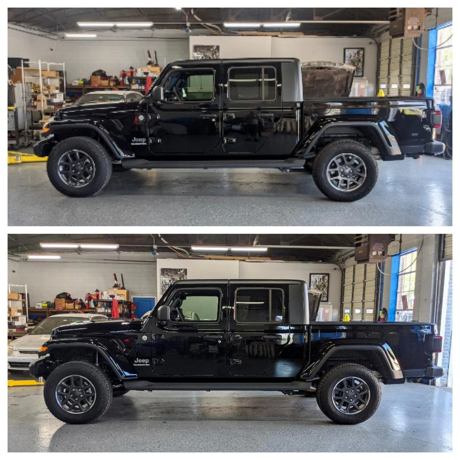

Here's a before & after of my Gladiator Overland with 2.5 inch Rough Country Leveling kit with N3 Premium shocks and stock wheels/tires. Installed and got tires aligned about 2 weeks ago and it rides great. I currently have about 550 miles with these, and will replace tires with better looking ones once they wear out (unless someone from the OKC area wants to buy them ;)). I hope this helps you out a little.
Jeep Gladiator If I add lift, do I have to also buy new tires? Gladiator Lift Before - After
